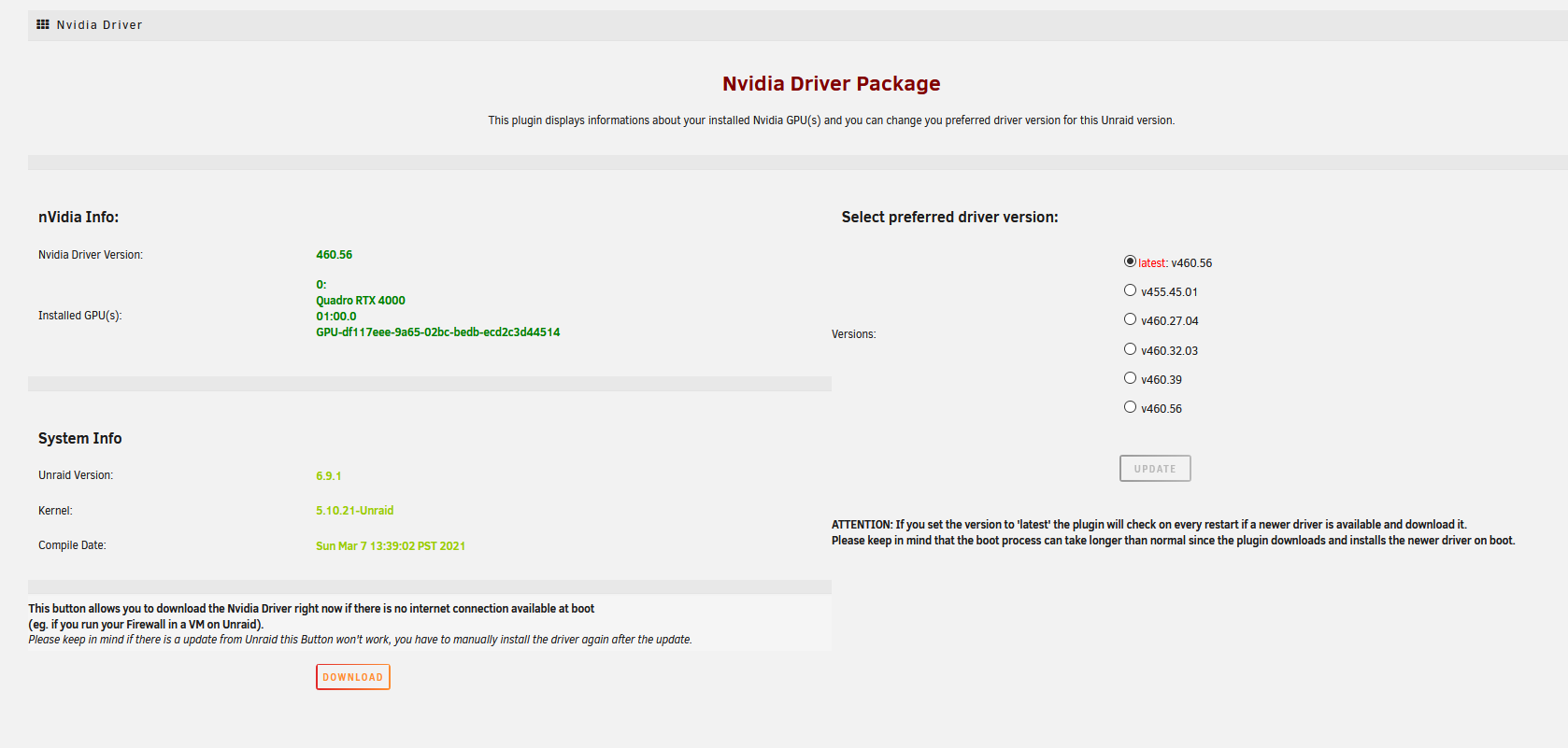

Not sure it's been addressed  here (I'm not reading 194 pages.. lol) but I updated Unraid to 6.9.0 this morning. Everything went well until Plex tried to autostart, kept getting bad parameter. Checked log noticed Critical: libusb_init failed. Searched internet and everything was pointing to a database corruption issue.
Just so happened to look at my dashboard and noticed GPU Statistics was missing (it's done this before) so on a hunch I checked for new nVidia driver app. Once installed, I had to disable docker and then re-enable and Plex was up and running again. Also downloaded the new GPU Statistics App.
Just thought I'd post in case anyone else runs into this issue.

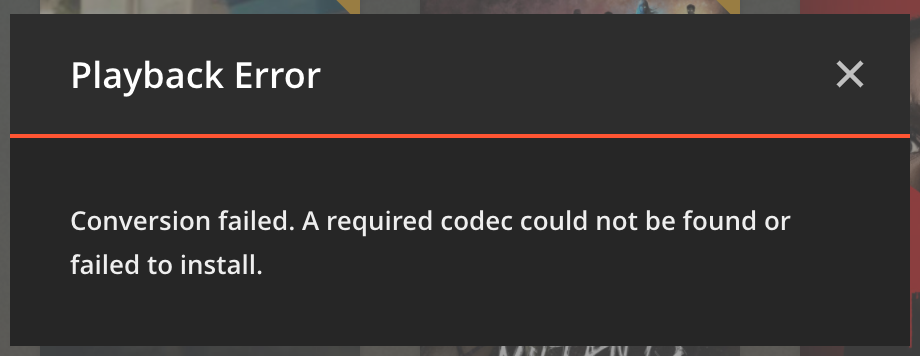

On 1/7/2021 at 12:47 PM, CJston15 said:
I have been running Plex in docker for quite a while now and never had issues until last night. Starting last evening none of my media with EAC3 audio will play in Plex now (Roku, Shield, or Web). I have tried changing the transcode folder location, deleting my codecs, turning off automatic library scanning, verifying that my Unraid servers inotify value isn't too low (it's over 500K, tried increasing to 1mill no change and changed back to default value), restored docker container from backup, completely blew it up and did fresh install of Plex. Nothing has resolved this issue in the last 18 hours. Only thing that happened was that my power went out yesterday afternoon for a couple hours and my Unraid server shut down (gracefully, it's connected to APC UPS and it sent the shutdown command at 20%).
Anyone have any other ideas? Been using Plex for like 10 years now, and on Unraid for the last 2-3 without any issues. I have about 1500 movies, 200 TV shows (15K episodes), 2k Music, and another 200 misc documentaries/specials. Nothing crazy compared to what I've seen others host.
Did you figure this out?
I'm roughly in the same situation as you. I cannot seem to transcode EAC3 anymore. Videos just buffer indefinitely.
Delete the codecs folder in [path to your Plex appdata folder]/Library/Application Support/Plex Media Server
This will force Plex to again download codecs as needed.  It is likely some corrupt codes are causing EAC3 audio issue.
Edited by Hoopster
Thanks for the tip Hoopster. I tried deleting said folder and it did not change anything.
I still kept getting the error "EAE timeout! EAE not running, or wrong folder?" in the Plex console.
Which made me wonder. I followed @mgutt suggestion, specifically the part to enable direct disk access for Plex config (changing the config mapping to /mnt/cache/appdata/Plex-Media-Server instead of /mnt/user/appdata/Plex-Media-Server).
After changing it back to the default /mnt/user/appdata/Plex-Media-Server, Plex is now able to transcode EAC3 without any problems. I'm not exactly sure what the problem is, but it seems that using the cache option doesn't give Plex access to codecs folder for some reason?
Yeah, not sure why that would make a difference but the important thing is that it is working.
The solution I suggested is one that is mentioned in the Plex forums for those with EAC3 audio issues.  Your problem obviously had a different solution but at least there is a solution.

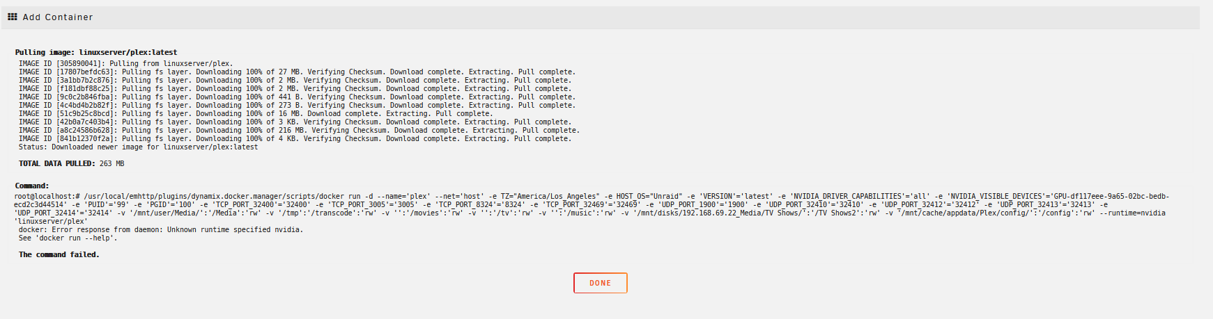

Hello,
I am receiving the following error after updating the plex docker to the latest build after upgrading Unraid to 6.9.1.
docker: Error response from daemon: Unknown runtime specified nvidia
I am running the nvidia driver plugin
Any assistance would be appreciated.
EDIT: It looks like it was the driver version which was causing the issue. I downgraded the nvidia drivers back down to v455.45.01 and Plex is working again.
Edited by guyonphone
