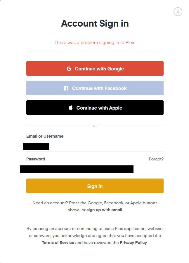

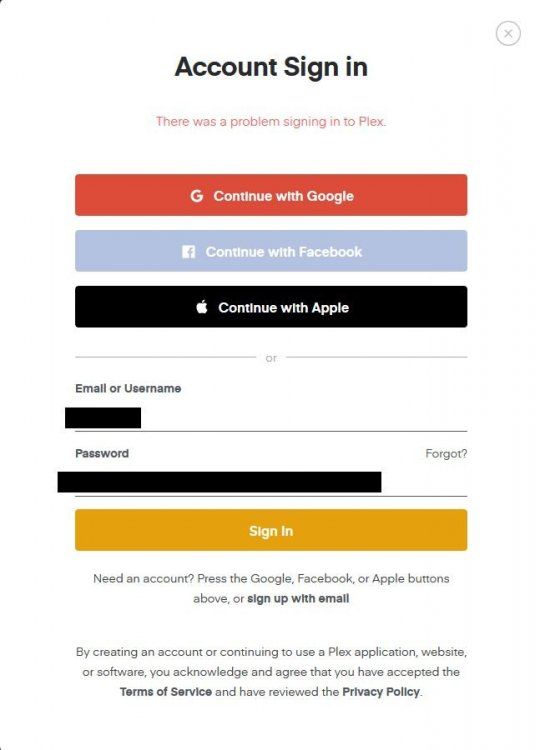

I'm having an issue with Plex. To be honest, I don't really think it has anything to do with the linuxserver's docker container of Plex, but I'm not sure where else to ask. I was running the deprecated version of Plex's official docker container when I started noticing that I couldn't play my media, even if I was local. It looked like I needed to claim my server again, so I tried to do that. However, even though I clicked claim, nothing happened (screenshot attached below). I tried different browsers, incognito, and all of that. Couldn't do it. So I decided to uninstall the docker container (since it was deprecated) and reinstall Plex again. I also removed my appdata folder for good measure. I reinstalled linuxserver's version of Plex. But upon starting it, it tried to sign back into my account, which I thought was odd since I removed the appdata folder and reinstalled Plex. It should have been a clean set up (obviously my understanding is wrong since it wasn't a clean set up). Anyway, same issue. Can't claim the server. Go to the website and try to login and I'm met with this error (attached below as well). It's the right sign in information and everything. Honestly, I don't know what's going on. I tried Googling it, and it seems like some other people have had my issue, but no solutions. I'm hoping someone could shed some light on what's going on or how to fix it. Even if it's starting over from scratch, that's fine, just tell me how to do it because apparently uninstalling the docker container and removing the appdata folder isn't enough. Logs look okay too. No errors.
Try removing the server from the Plex 'Authorised devices' in the Web GUI on a browser and then try to reclaim your server. I too struggled till I tried this approach. I hope that solves the issue for you.

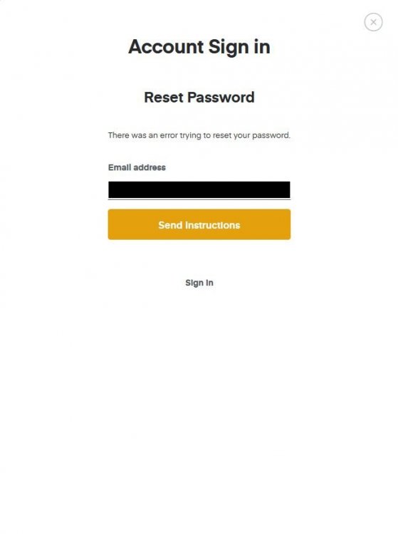

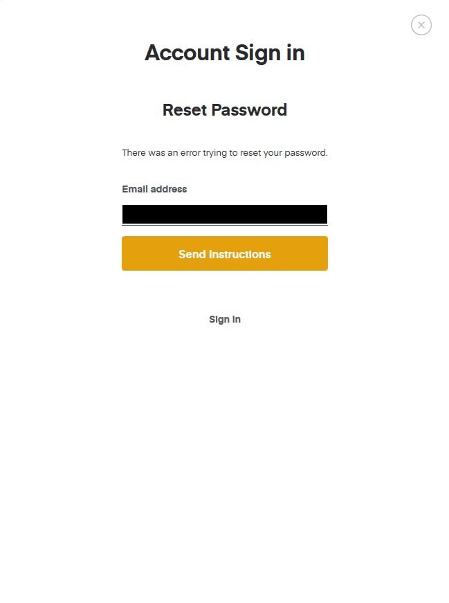

Just tried to reset my password and now this.
Can't log in via Web GUI or anything anymore. No idea what's going on.

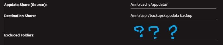

Anyone know what Plex folders can be excluded in CA Backup / Restore application? I heard that you don't need to back up the entire Plex appdata directory. It takes quite a while to do a backup now and I suspect that the Plex files are responsible.

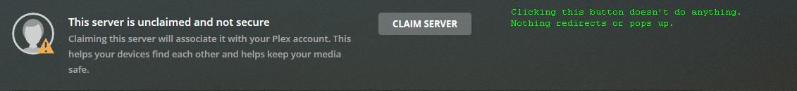

First off I'm running unRaid NVIDIA 6.8.3 2020-03-05 because I run a gaming VM. Plex used to work fine and randomly started getting this error and becomes unresponsive. I do not know if a container update started causing this, as I didn't notice it until it stopped working.
The only way to bypass is is to delete the Preferences.XML file, and restart. This sets up the server as a "new" server but it works. All the shares are still there. As soon as I made a change to any settings within Plex (ie. enable auto discovery,)  I get this error again.
I have a backup of my plex directory and tried running it with the plexinc container and still got the same error. I'm assuming this is an unRaid problem more than than a plex problem.
Any help would be highly appreciated.
