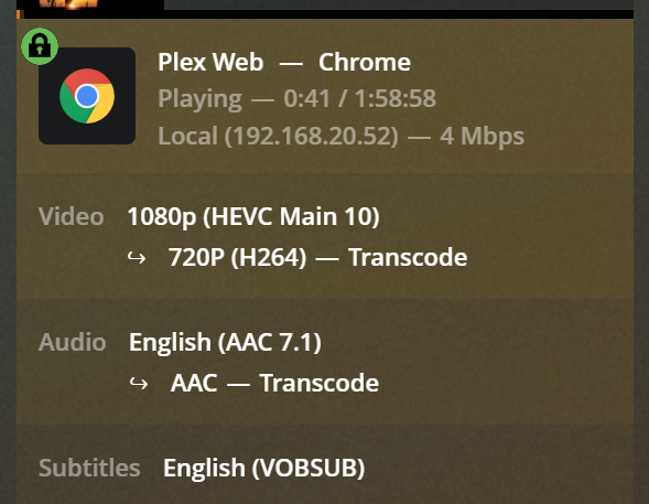

I know I asked this earlier but never got any answer so here we go again: How can I get custom fonts working for Plex docker? I have many shows with .ass subtitles and TrueType font files to go with them but no idea where to copy them? When the custom fonts are embedded in mkv-file they work but is there a way to get them to work without modding the video file?
Dear,
I have setup my Unraid/Plex a few months ago, asuming all was running smoothly.
I never had issues trancoding videos and all playback was good.
After I now started to include some 80-90mbps 4k UHD videos things went south.
My CPU load is immense when streaming, so I figured something was not right.
When I open (watch every 0.5s) 'nvidia-smi' in my docker's console, I see it finds my p2000:
https://i.ibb.co/HG5KHfs/docker.jpg
However, when I start transcoding something, nothing happens on the GPU, also, in Plex I do not see the 'hw' suffix, so I guess that's what makes my CPU suffer 🙂
If I remember correctly, I also altered some Plex config files, to actually let Plex use the GPU.
Maybe I made a mistake here, I dunno.. I'd like to check, but cannot find a good/right tutorial for this part.
Is there anyone who can advise which files to check for what content, or what else to check?
As my container does see the p2000 (see screenshot above) I guess the underlaying settings are correct.
To be sure, I made some more screenshots though:
Settings for container in Docker (GPU ID is corrrect)
Plex settings
What I see in Plex when a users video is being transcoded (this i find funny, I do see 'HW' but the load on nvidia-smi remains 0 and my CPU usage bumps up.
I know the plugin has recently been revoked, but as I already have it installed I should be ok.. Right?
Thanks in advance for all your help!
Regards,
Martin

If you have modified any config files, you have probably messed up something. There is no reason to modify any config files to get hardware transcoding working.
You could try to disable both transcoding options, restart the container and then enable it again and restart the container.
Hi, did not make any difference. I used the examples from a youtuber named bite my bits (https://www.youtube.com/watch?v=bz16M67z0uM), who said to rename the 'Plex Transcoder' file to 'Plex Transcoder' and create a new 'Plex Transcoder' file with the following contents:
/bin/sh /usr/lib/plexmediaserver/Plex\ Transcoder2 -hwaccel nvdec "$@"
...Does this make sense, or should I undo that? if I should undo, can you please share the contents of the original 'Plex Transcoder' file?
I fiddled around a bit and what I have now is as follows.
When I play a video Plex now DOES say it is transcoding. When I do a 'nvidia-smi dmon -s u' in the terminal I do see load while playing:
# gpu    sm   mem   enc   dec
# Idx     %     %     %     %
    0     4     1     0     3
    0     8     4     6    12
    0     8     4     6    11
    0     5     3     2    10
    0     6     3     8    10  (etc)
However, when I do a 'watch -n0.1 nvidia-smi' I now also DO see a process pop up very, very briefly for Plex, but then it goes again..
Now, I am not sure whether this is correct and it just buffers for a bit or something and then comes back when needed again, or whether I should see this process there nonestop as long as a video is being transcoded? I fear the latter, as my cpu usage is still sky high..
Please let me know what to do/check or what to take as next steps, cause I am pretty puzzled by now 🙂
Thanks in advance for all your help!!

That was something needed a year ago to get hardware decoding working. Hardware encoding have been working without any needs to rename files and create files. So revert your changes.
Ok clear, thanks! I am not sure if I still have the original copy of that 'Plex Transcoder' file, could you please share me the contents of the original so I can revert? Also, for me to understand what I should see, can you please let me know on the fact the Plex process shows up just very briefly? Is that normal or should it be there all the time while a video is being played/transcoded? thnx
I think you can just delete the file and restart the container and Plex will download it again.
The process should not flash but show until it's finished transcoding.

I didn't say you should delete the current setup. Set up a new one for testing. As long as the other container is stopped and you don't use the same appdata folder and name, your old setup is safe.
I guess that would have been an option too yes.. 🙂
But.. Impatient as I can be, I had already looked that up so what i did is the following:
- Backing up my Library folder
- Uninstalling the docker container
- Reinstalling Plex with the manual/instructions as you said
- Put back the library folder
..Results are the same though. Whenever I start playing a video with transcoding, I see it show up under 'nvidia-smi' for a very brief moment, then it disappears and I see my CPUs getting hit. Also, 2160p is still with stutters and frequent buffering.
Not really sure what to do or try now? Could it be there's something wrong with the physical card? I can try with another, let powerful, nvidia card tomorrow for the sake of trying... Guess I'll do that, unless you would have any more suggestions before then? :) THanks!

What do you mean by adding back the library folder? If it's a folder in appdata then don't. You want a clean config. Also be sure to delete image when you remove the container.
Yup that's what I put back.. Would that mean I need to redo all my shares, indexing, custom folders etc?

If you ever edited the profiles for different devices, this might cause that problem.
I had edited profiles for android about 5 months before and now i had x265 videos and they didn't even start to transcode, then i remebered that and deleted the custom profiles. Worked immidietly.

The point isn't to set it up the same way as you had it, but to test with a new clean setup if its working. If you add back the appdata you are back to the old setup.
Set up a fresh new plex and then add the movies folder so you have something  to test with.
