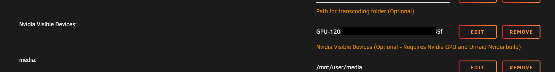

wgstarks Posted November 10, 2021 Share Posted November 10, 2021 9 hours ago, Syed said: tried it with advanced view on and off... part of the template is missing What about “Show more settings”? According to the instructions in the OP the template was edited on 11/6 but NVIDIA_VISIBLE_DEVICES is still required so I would think it’s still there somewhere. If not you could try adding it as a variable. Note: Extra parameters are also still required. Quote Link to comment
wgstarks Posted November 10, 2021 Share Posted November 10, 2021 Looks to me as if LSIO has decided to remove that variable from the template but you can add it back. Quote from dockerhub- Quote Nvidia Hardware acceleration users for Nvidia will need to install the container runtime provided by Nvidia on their host, instructions can be found here: https://github.com/NVIDIA/nvidia-docker We automatically add the necessary environment variable that will utilise all the features available on a GPU on the host. Once nvidia-docker is installed on your host you will need to re/create the docker container with the nvidia container runtime --runtime=nvidia and add an environment variable -e NVIDIA_VISIBLE_DEVICES=all (can also be set to a specific gpu's UUID, this can be discovered by running nvidia-smi --query-gpu=gpu_name,gpu_uuid --format=csv ). NVIDIA automatically mounts the GPU and drivers from your host into the plex docker. Quote Link to comment

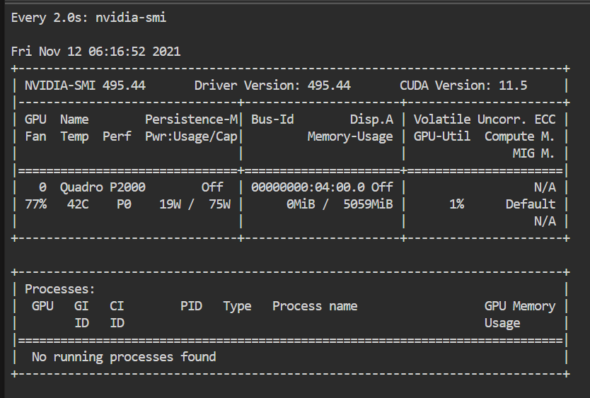

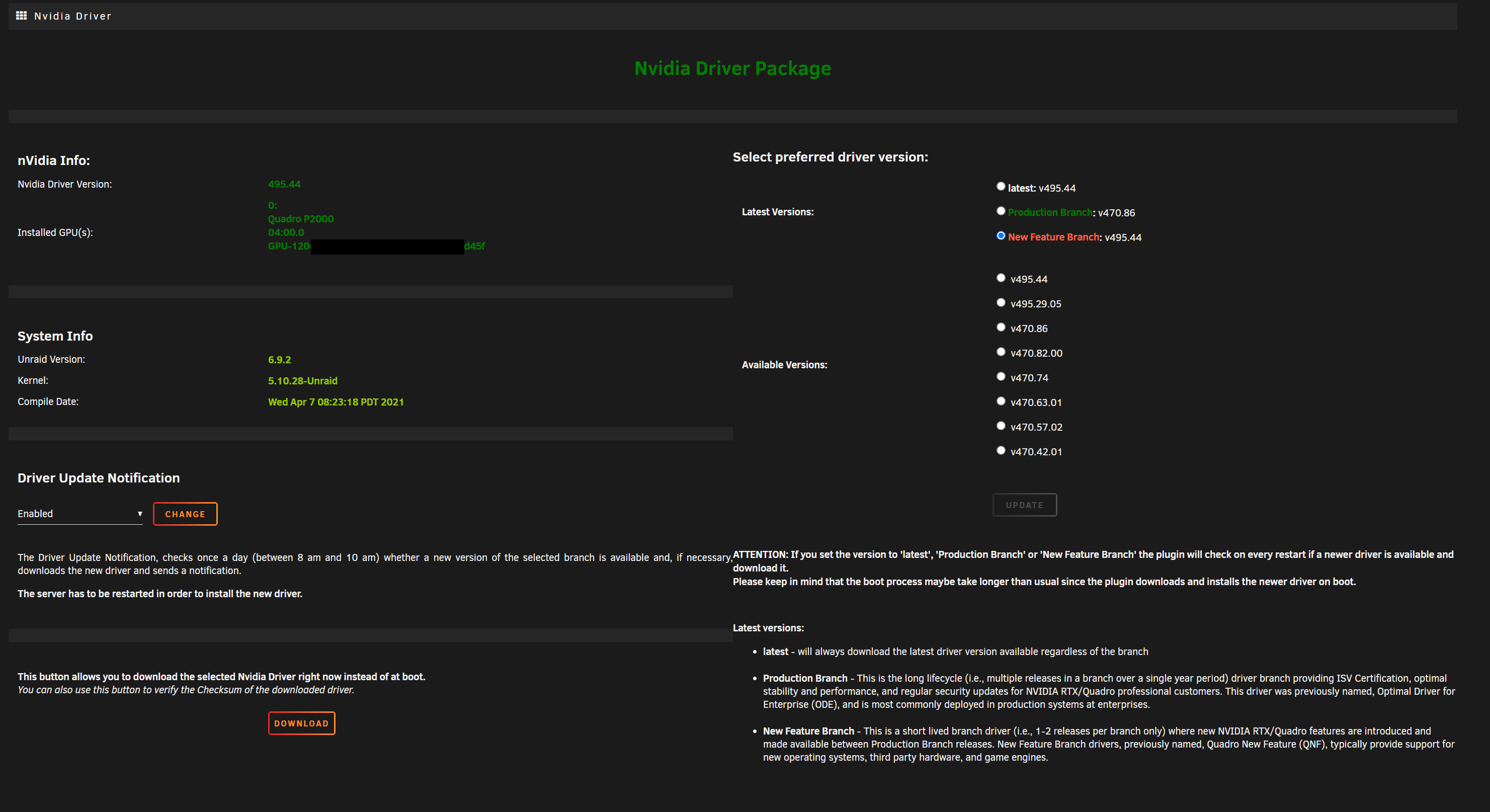

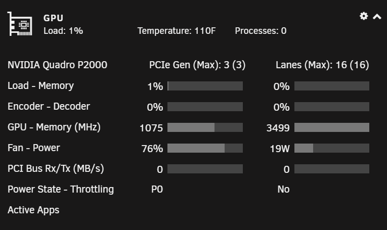

mortist Posted November 11, 2021 Share Posted November 11, 2021 Hello, Looking for some support on HW transcoding. System: Dell R530 dual E5-2680v4 Quadro P2000 I have followed all of the guides including setting environment variables, the card is visible to unRAID including statistics and 'watch nvidia-smi'. Once I initiate a transcode I can see that the GPU is called for 1-2 seconds, but then it returns to idle. I have tried different versions of Nvidia drivers and different version of Plex docker, with the same results. There has to be something simple I am missing? Here's at least one piece of the Plex logs indicating the failure: Nov 11, 2021 06:43:22.715 [0x1529ff51eb38] DEBUG - [Transcode] Codecs: testing h264 (decoder) with hwdevice vaapi Nov 11, 2021 06:43:22.716 [0x1529ff51eb38] DEBUG - [Transcode] Codecs: hardware transcoding: testing API vaapi Nov 11, 2021 06:43:22.716 [0x1529ff51eb38] DEBUG - [Transcode] Codecs: hardware transcoding: opening hw device failed - probably not supported by this system, error: Generic error in an external library Nov 11, 2021 06:43:22.717 [0x1529ff51eb38] DEBUG - [Transcode] Codecs: testing h264 (decoder) with hwdevice nvdec Nov 11, 2021 06:43:22.718 [0x1529ff51eb38] DEBUG - [Transcode] Codecs: hardware transcoding: testing API nvdec Thanks in advance, tower-diagnostics-20211111-0633.zip Plex_Media_server_short.txt Quote Link to comment

ConnerVT Posted November 11, 2021 Share Posted November 11, 2021 9 hours ago, mortist said: There has to be something simple I am missing? Do you have Plex Pass? Plex only HW transcode when you have Plex Pass - the free/unsubscribed version doesn't. (You *did* say "something simple"...) Quote Link to comment
mortist Posted November 12, 2021 Share Posted November 12, 2021 2 hours ago, ConnerVT said: Do you have Plex Pass? Plex only HW transcode when you have Plex Pass - the free/unsubscribed version doesn't. (You *did* say "something simple"...) Sorry, yes I do have plex pass. I don't think there are any extra parameters to add to the docker template, right? Quote Link to comment
wgstarks Posted November 12, 2021 Share Posted November 12, 2021 54 minutes ago, mortist said: Sorry, yes I do have plex pass. I don't think there are any extra parameters to add to the docker template, right? Quote from instructions on dockerhub - Quote Hardware Acceleration Intel Hardware acceleration users for Intel Quicksync will need to mount their /dev/dri video device inside of the container by passing the following command when running or creating the container: --device=/dev/dri:/dev/dri We will automatically ensure the abc user inside of the container has the proper permissions to access this device. Nvidia Hardware acceleration users for Nvidia will need to install the container runtime provided by Nvidia on their host, instructions can be found here: https://github.com/NVIDIA/nvidia-docker We automatically add the necessary environment variable that will utilise all the features available on a GPU on the host. Once nvidia-docker is installed on your host you will need to re/create the docker container with the nvidia container runtime --runtime=nvidia and add an environment variable -e NVIDIA_VISIBLE_DEVICES=all (can also be set to a specific gpu's UUID, this can be discovered by running nvidia-smi --query-gpu=gpu_name,gpu_uuid --format=csv ). NVIDIA automatically mounts the GPU and drivers from your host into the plex docker. Quote Link to comment

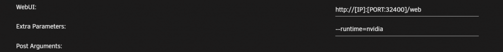

mortist Posted November 12, 2021 Share Posted November 12, 2021 15 hours ago, wgstarks said: Quote from instructions on dockerhub - Thanks Walter, Apologies my response was poorly worded. I do have '--runtime=nvidia' included in the extra parameters. I seem to remember some of the dockers required 'plexpass' parameters being added, but that does not seem to be the case for Linuxserver. I have tried the official docker as well as the binhex docker and both produce the same result. The GPU becomes active, but the stops shortly afterwards. Do the instructions found on: https://github.com/NVIDIA/nvidia-docker Still apply to unRAID 6.9.2? Extra Parameters: Visible Devices: Capabilities: Nvidia Driver package: Nvidia Statistics Plugin: Nvidia SMI: Quote Link to comment
wgstarks Posted November 12, 2021 Share Posted November 12, 2021 1 hour ago, mortist said: Do the instructions found on: https://github.com/NVIDIA/nvidia-docker Still apply to unRAID 6.9.2? I think the @SpaceInvaderOne video is probably the easiest to follow. https://youtu.be/VkC5Hi-rO2c Quote Link to comment

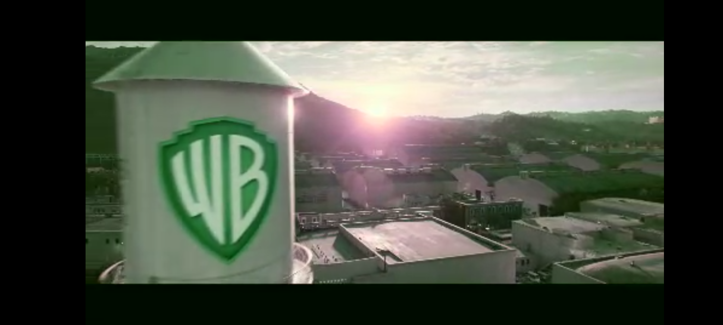

endiz Posted November 14, 2021 Share Posted November 14, 2021 Is hdr tone mapping broken? I have hw transcoding enabled with an Nvidia gpu. I know it's working as I see transcoded files encoding and decoding in hw. But when I watch an hdr film on a non hdr display that requires transcoding, I get a green tint. See screenshot attached. Quote Link to comment
Squid Posted November 14, 2021 Share Posted November 14, 2021 Not the Plex expert, but whenever I see that (and a google) means that the movie you downloaded is Dolby Vision without a fallback compatibility and your TV does not support Dolby Vision. I bought a new TV to work around it. Quote Link to comment
endiz Posted November 14, 2021 Share Posted November 14, 2021 (edited) 1 hour ago, Squid said: Not the Plex expert, but whenever I see that (and a google) means that the movie you downloaded is Dolby Vision without a fallback compatibility and your TV does not support Dolby Vision. I bought a new TV to work around it. Thanks squid. I do have a display that supports HDR & DV, and it looks great. But if i'm watching on a non-hdr screen remotely (e.g. cell phone), it says it's transcoding but the tone mapping is off with the strange green tint mentioned above. Anyways, i think it's a plex issue so i posted in their forums. I'll post back if i come across a solution. Edited November 14, 2021 by endiz Quote Link to comment
Kaizac Posted November 14, 2021 Share Posted November 14, 2021 3 hours ago, endiz said: Thanks squid. I do have a display that supports HDR & DV, and it looks great. But if i'm watching on a non-hdr screen remotely (e.g. cell phone), it says it's transcoding but the tone mapping is off with the strange green tint mentioned above. Anyways, i think it's a plex issue so i posted in their forums. I'll post back if i come across a solution. I think it's two seperate issues, because I have both issues. The green color you've shown I also had. When testing the file directly on my laptop it also showed the green color. So not a Plex issue. And Plex does indeed have confirmed issues with HDR tonemapping. Especially on latest gen intel GPU's. Which has not been solved yet. Make sure if your GPU is not the issue, that Hardware Transcoding is actually working by checking your Plex dashboard when watching a transcoded video. Quote Link to comment

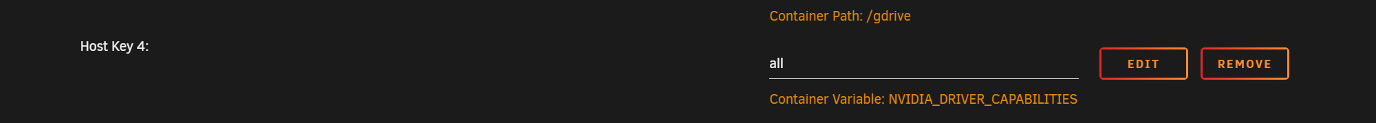

Johan71 Posted November 16, 2021 Share Posted November 16, 2021 On 11/12/2021 at 8:13 PM, wgstarks said: I think the @SpaceInvaderOne video is probably the easiest to follow. https://youtu.be/VkC5Hi-rO2c Unfortunately not so easy to do according to spaceinvade's video as the field Nvidia Visible Devices: no longer exists. Unfortunately, I do not know what to fill in anywhere under Key: Value: Default Value: Quote Link to comment
Cessquill Posted November 16, 2021 Share Posted November 16, 2021 12 minutes ago, Johan71 said: Unfortunately not so easy to do according to spaceinvade's video as the field Nvidia Visible Devices: no longer exists. Unfortunately, I do not know what to fill in anywhere under Key: Value: Default Value: Key: NVIDIA_VISIBLE_DEVICES Value: The ID of your GPU according to the Nvidia plugin page Default Value: leave blank 1 Quote Link to comment
Johan71 Posted November 16, 2021 Share Posted November 16, 2021 39 minutes ago, Cessquill said: Key: NVIDIA_VISIBLE_DEVICES Value: The ID of your GPU according to the Nvidia plugin page Default Value: leave blank You're an angel, thank you very much Quote Link to comment
