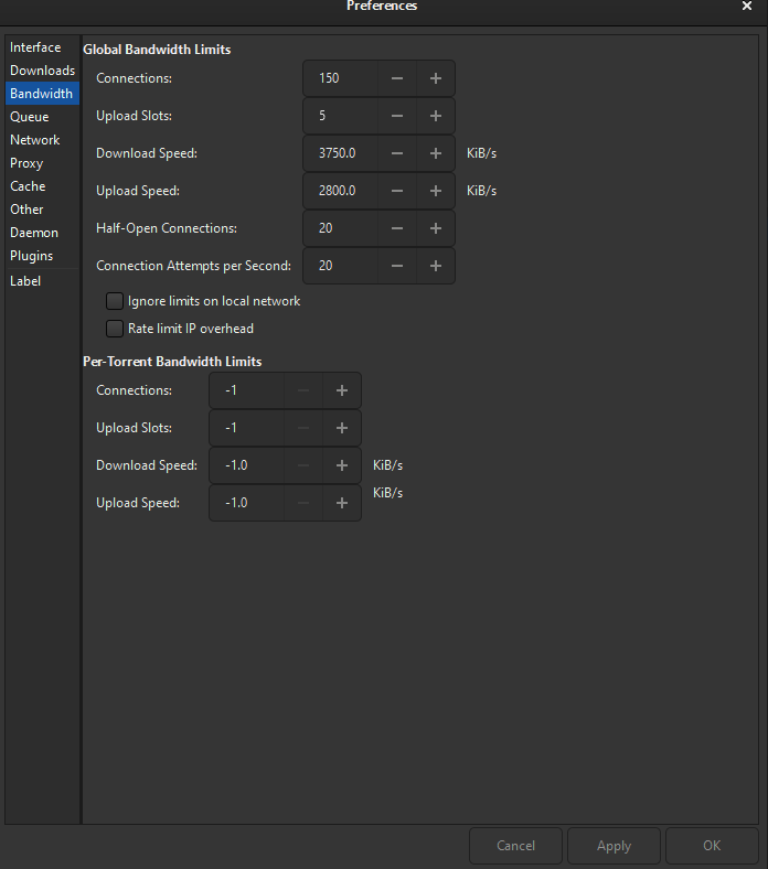

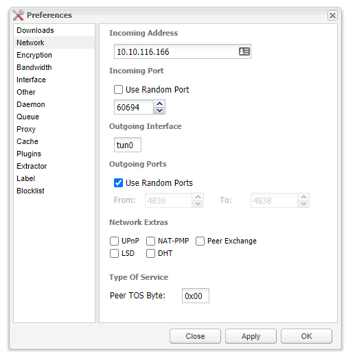

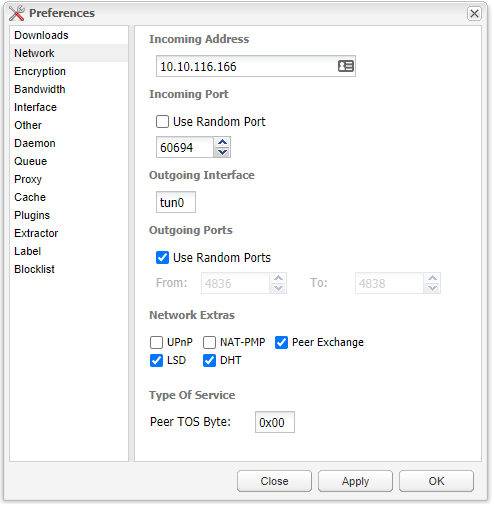

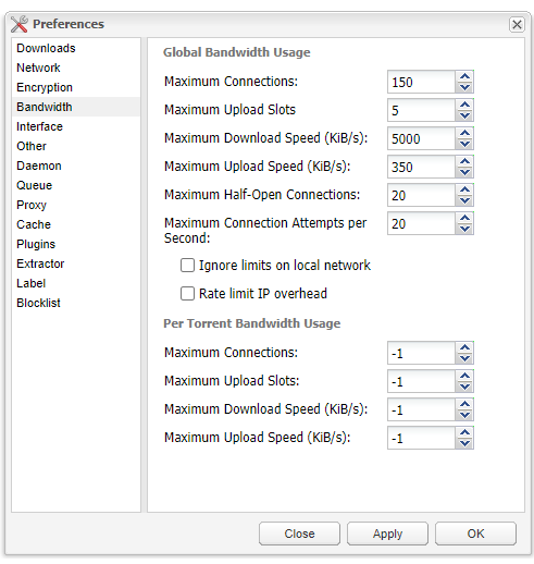

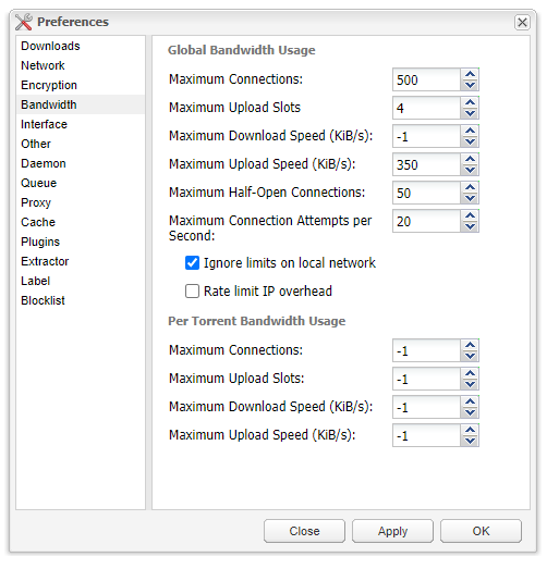

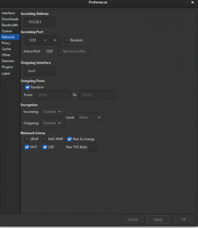

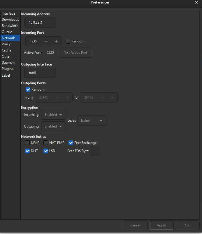

your ui looks different than mine but I matched your setting (we had different settings).
Mine:
image.png.1d7519af1ad49d9fab37c82216ede3d3.pngimage.png.d2604f2e85279a7cb5b52d0bad791421.png
I'm changing my settings to:
I have no way to test the port inside of delugeVPN :(
Results:
Edited by RaidBoi1904
Then I'm out of ideas. Check the itconfig plugin as mentioned, might help.
That's because I'm using the thin client on windows not the webui
 So I tried to setup my windows thin client but I couldn't get it to work with both of the IPs shown by unraid in the docker list window. I really wanted to click that check button. Any way, I figured out that I could access the terminal for a container and I looked up how to list all the udp ports that were listening and it does show 60694.

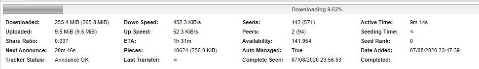

Thanks back in business but very slow speeds > 30-80kib/s range. Hm
So Not sure how to tell what Incoming port I should select within the Deluge settings, to try and improve speed.  Followed Space Invaders video. Have PIA with port forwarding working through Vancouver currently.  Get the following in the log file  below..  Should I have the incoming port set to  "6890,"  "22509" or "58846"
Don't worry about the port forwarding if you're using PIA, all you need to do is use one of the endpoints that support it. But as PIA is doing network changes I understand that some endpoints don't work right now, which possibly results in heavy load on the few that works.

Here are my settings
Edited by MammothJerk

Did you have setup "Maximum Upload Slots" to -1 or 6000? You can find it under Bandwidth.
If you use "AutoAdd" so control the settings there too.
Edited by Wetterchen
i haven't changed these settings for a long time so i wouldnt think they are the cause..
