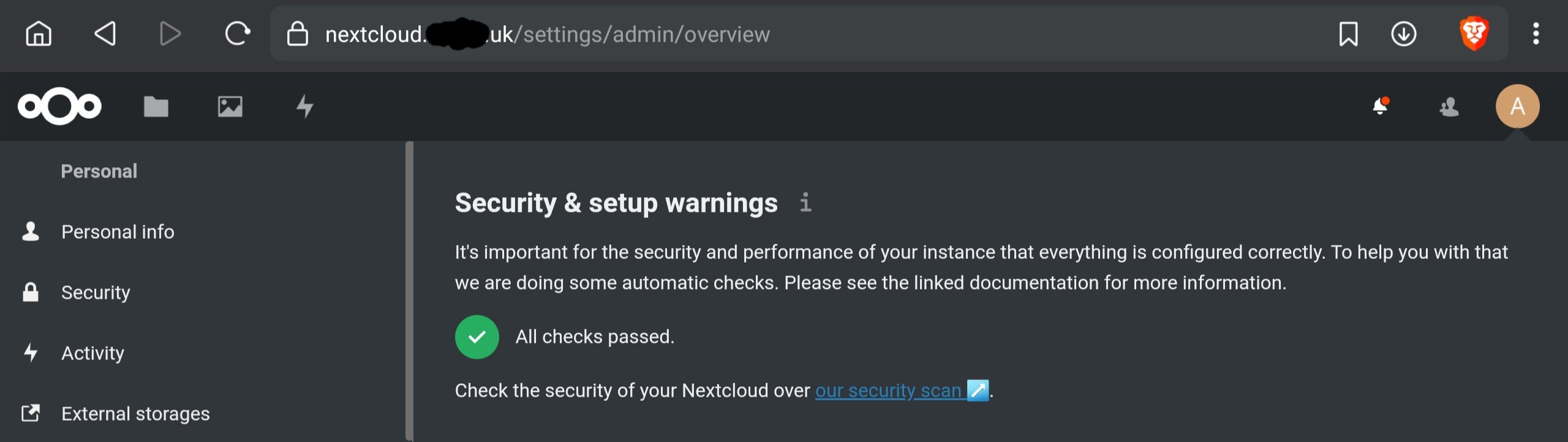

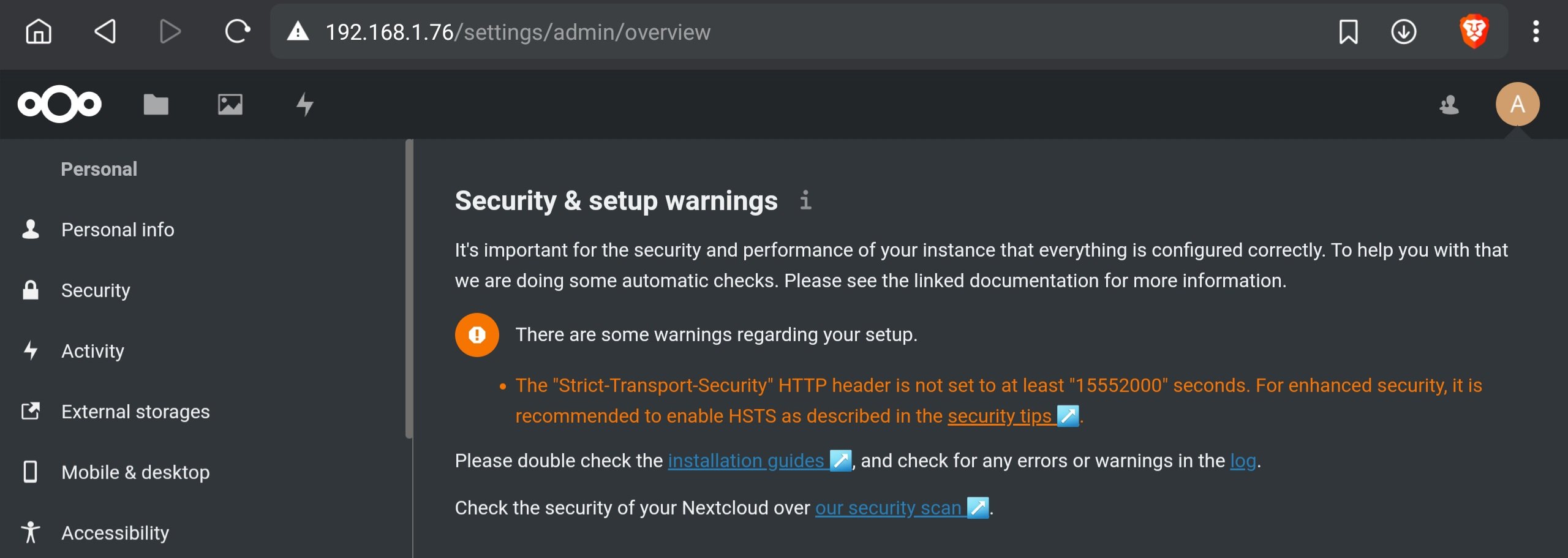

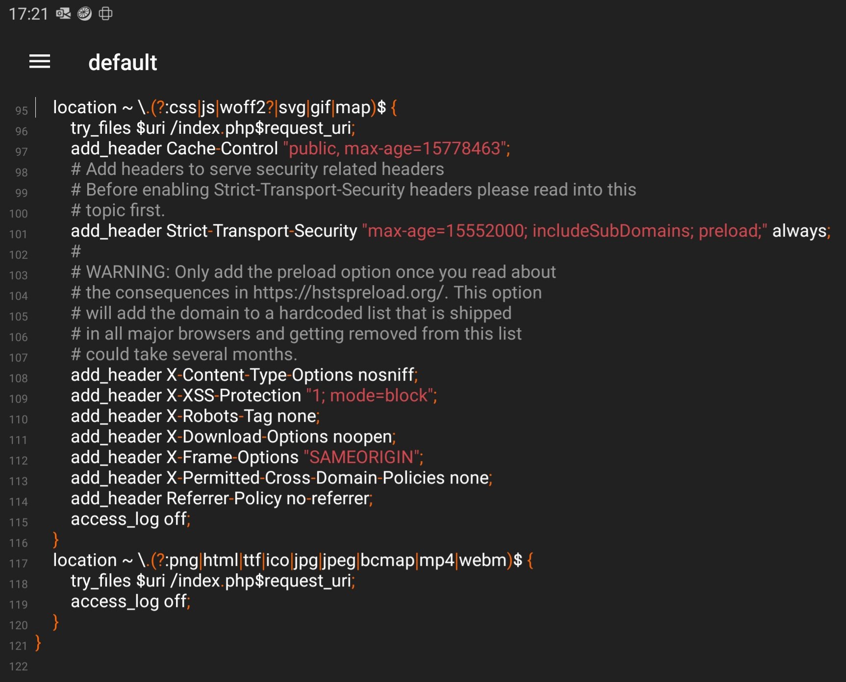

I was hoping that someone could give me a steer in the right direction.
I have NextCloud setup and everything is great, when I access it via proxy, however when accessing locally, I get a Strict-Transport-Security error. Its not a massive problem, however I would like to learn why this is happening.
For reference, I've added "add_header Strict-Transport-Security "max-age=15552000; includeSubDomains; preload;" always;" to the "default.conf" in NextCloud but that hasn't made any difference.
Regards.
When accessing locally;
Accessing via proxy;
Default.conf file;
Edited by LoneTraveler
