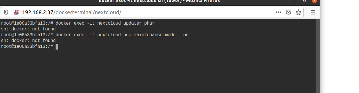

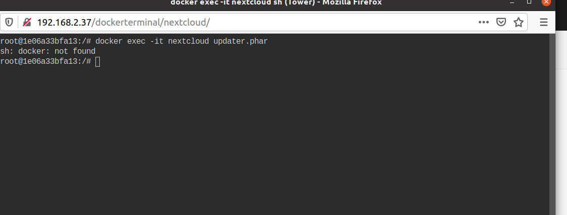

37 minutes ago, Vesko said:
Hi,today i update to 19.04 and my update stuck on step 4 and now i cant update or do anything else.The command line did not work also.i get errors.Please help me to fix this problem.Thank you.
You need to remove the .step file in the /data/updater<random characters>/ folder. SSH in and rm .step
Link to comment
The commands are for the Unraid terminal not the docker console.

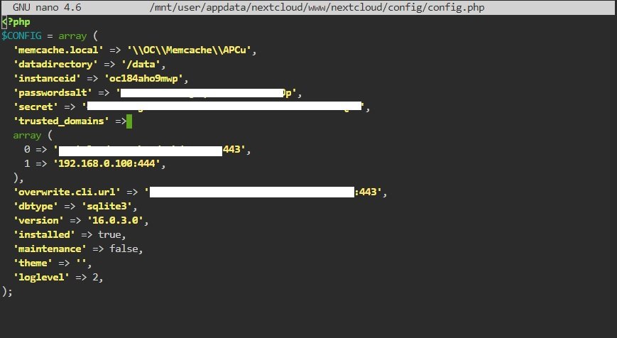

On 10/9/2020 at 1:38 PM, puncho said:
Hi, trying to follow SpaceInvaderOne's change from letsencrypt to swag. Getting to the part about changing nextcloud's config, I don't have any trusted proxies under my config file. So, when I try to use swag and nextcloud I can't get in. Any tips? Thanks!
Any thoughts on this? :)
