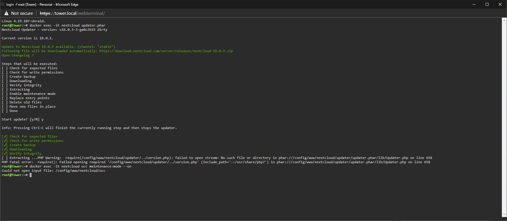

On 9/13/2020 at 10:57 PM, ur6969 said:
I had to rebuild my Unraid from a flash backup and have just now figured out how to recover and reinstall Dockers.  I have mariadb and Nextcloud dockers installed but am having issues.
Nextcloud is unavailable via webGUI.  I get a blank white page with "Update in progress." in the top left.  Some searching led me to try to update via command line.
Typing "docker exec -it nextcloud occ maintenance:mode --on" (the first step) yields "sh: docker: not found".  This is the command line selected from the docker.
From the main Unraid command line the same command yields, "Could not open input file: /config/www/nextcloud/occ".  Any ideas?
Some progress everyone.  Any idea where to go from here?
It's !@#$%&* FIXED!
It took 3 pours of single barrel Four Roses but I finally stumbled on this Reddit post:
I had saved my last CA Backup & Restore before it rolled off to my pc and was able to copy over the Nextcloud folder in full.  From there I used the command line update procedure in the first post of this thread.
Drink more everyone.

11 minutes ago, Jonatino said:
Is this a next cloud specific thing or for all unraid containers. Do I run the manual occ update?
Normally you should only update via unraid but with nextcloud you have to update with in the docker.

this is who i followed
On 7/22/2019 at 10:36 PM, Maticks said:
So.. the docker updates, upgrade the docker itself it doesn't perform the upgrade on Nextcloud.
You can do it through the webui but i find the wheels fall off that sometimes and it becomes a pain.
I prefer doing mine through the CLI its also easier to fix if something goes wrong if your in the CLI.
Open a console on the docker image.
cd /config/www/nextcloud/updater/
root@bd32ce1bcd66:/config/www/nextcloud/updater# sudo -u abc php updater.phar
This will launch the CLI upgrade tool which will tell you what version you are and you can do the upgrade.
Nextcloud Updater - version: v14.0.2RC2-7-g57268cb
Current version is 15.0.5.
Update to Nextcloud 16.0.3 available. (channel: "stable")
Following file will be downloaded automatically: https://download.nextcloud.com/server/releases/nextcloud-16.0.3.zip
Steps that will be executed:
[ ] Check for expected files
[ ] Check for write permissions
[ ] Create backup
[ ] Downloading
[ ] Verify integrity
[ ] Extracting
[ ] Enable maintenance mode
[ ] Replace entry points
[ ] Delete old files
[ ] Move new files in place
[ ] Done
Start update? [y/N] y
Info: Pressing Ctrl-C will finish the currently running step and then stops the updater.
[✔] Check for expected files
[✔] Check for write permissions
[✔] Create backup
[✔] Downloading
[✔] Verify integrity
[✔] Extracting
[✔] Enable maintenance mode
[✔] Replace entry points
[✔] Delete old files
[✔] Move new files in place
[✔] Done
Update of code successful.
Should the "occ upgrade" command be executed? [Y/n] Y
sit back, drink a coffee and wait for it to finish. it can take a while before there is any output here.
And then say No here
Keep maintenance mode active? [y/N] N
If you say yes you need to run another command to disable maintenance mode and get Nextcloud back up and running.
This is for if you want to do other things after the upgrade before making Nextcloud live again.
First connect to the webui you will need to do a quick start upgrade button but it just does a DB check and starts.
