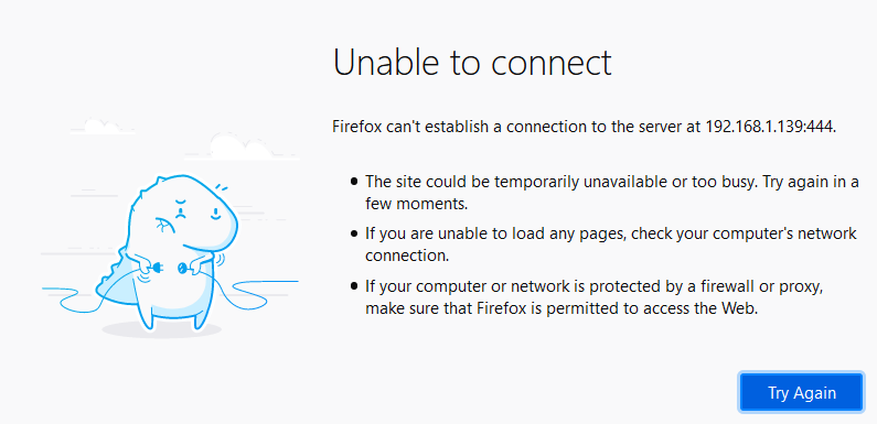

* When you visit localip:port (nextcloud ui) does it work?  or neither external or internal works?

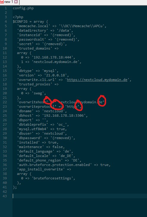

Please also attach config.php from /mnt/user/appdata/nextcloud/wwwn/extcloud/config/config.php
When you say "Unable to connect" it says just that? Or maybe it's "Internal Server Error"

I am in the same boat :-( Nextcloud stopped working, not 100% what was causing it. Collabora update yesterday still worked fine. Did stop Swag and tested with NginxProxyManager to get the same result: Internal server error (see below) - with internal access as well as external.
Went trough the checklist @skois provided:
* Open terminal on unraid and do "docker network ls" -> Does proxynet appears?
The bridge network apears in the list.
* Go to mariadb, nextcloud and swag docker and click edit. Are all of them on "proxynet" or they have defaulted back to bridge or anything else.
Yes, all these dockers are on the correct network.
* Go to /mnt/user/nextcloud (the folder you mapped as /data for nextcloud). Get the nextcloud.log (this is the log that gives you some info about nc instance)
nextcloud.log does not show any entries for my access
Both show same internal server error (see attached).
I got the internal access working with the copy of /mnt/user/appdata/nextcloud/wwwn/extcloud/config/config.php that I took before configuring reverse proxy. I will narrow this down now by removing some of the additions I added later.
Furthermore I will remove Collabora to see if that brings any changes.
* Can you grab a screenshot please

OK, lets start with this, by the eye the syntax looks right.
Try opening config file with nano.  either by using unraid's terminal or docker console.
At line 20 (its the array with the 'swag'). check if there is any space after or anything out of the ordinary.
Try actually deleting the array block and rewriting manually. Save file and restart nextcloud. Try again occ status.
See if it spits any errors for the config file
PS. i just show you have some weird characters in the config. You have ’ instead of ' . I don't know which symbol is that, but i wouldn't see it in this font here. I copied to another editor.
So here is what i found. Fix those and you should be fine

Indeed @skois, after removing both lines it worked with the external address and adding them with the correct characters, it was working again as well. You rock - thanks a million for your time and help!
I hope my piloting your template was also beneficial for you. Let's hope the problem of the other two with similar problems are eaqually easy to sort. I keep fingers crossed.
Happy its working! Also if you keep getting the error you linked on nextcloud.log, its from the Talk app, try disabling if you dont use it

Hi Skois,
I ran "docker network ls" and proxy net appeared.
Mariadb, nextcloud and swag are all on "proxynet"
when I visit localip:port I can't connect either.
I'll fill the template to hopefully help in troubleshooting efforts:
What problem you experience - unable to access nextcloud UI via reverse proxy or localip:port
What error messages you get: image.png.ba5400f95beadcbea5436fe47e5195f9.png

<?php
$CONFIG = array (
  'memcache.local' => '\\OC\\Memcache\\APCu',
  'datadirectory' => '/data',
  'instanceid' => '***************',
  'passwordsalt' => '*********************************',
  'secret' => '**************************************************************',
  'trusted_domains' =>
  array (
    0 => '192.168.1.139:444',
    1 => 'nextcloud.*************.net',
  'dbtype' => 'mysql',
  'version' => '20.0.7.1',
  'overwrite.cli.url' => 'https://nextcloud.*************.net',
  'overwritehost' => 'nextcloud.****************.net',
  'overwriteprotocol' => 'https',
  'dbname' => 'nextcloud',
  'dbhost' => '192.168.1.139:3306',
  'dbport' => '',
  'dbtableprefix' => 'oc_',
  'mysql.utf8mb4' => true,
  'dbuser' => 'nextcloud',
  'dbpassword' => '**********',
  'installed' => true,
  'trusted_proxies' => ['swag'],
apologies for the long post !

Hi Skois,
I've done occ maintenance:update:htaccess and it's updated it but the problem still persists.
To do an ls -la, am I right in saying that I need to use the unraid terminal and navigate to that directory. If so, I apologise but how do I change the directory in the unraid terminal.
I don't know if it's of relevance, but when I click on the nextcloud icon on the docker tab and click Web UI it only navigates to localip and not localip:port.
Thanks,
Myles
