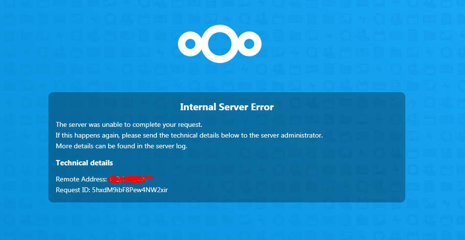

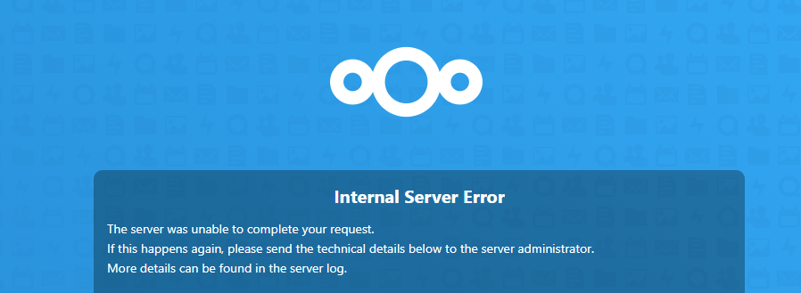

Hi guys,
trying to install nextcloud.
Installed and setup MARIADB to work with
installed Nextcloud docker
tried to open the GUI and I got an internal server error
removed the docker and re installed again, reboot the server, but the problem is still there.
No idea why is happening
here the screenshot with the error statement
Any suggestion ?
thx a lot

I get this error usually if nextcloud have trouble connecting to database.
Is there a way to get nextcloud connected back to the database?
Check if they are on the same docker network eg. bridge.
Check in appdata/nextcloud/www/nextcloud/config/config.php  that ip and port number for db is correct.
Check mariadb docker logs if the db is running correctly
Check nextcloud docker logs if there is anything there.
You can download a db viewer/editor like dbeaver and try to connect to the mariadb and see if you can see your data there. This way you can confirm that mariadb can read the actual db.
Without any logs/ configs can't say much

I too received this message, i was able to solve it after retrying the installation from scratch.
-removed nextcloud and mariadb
-settings run clean up
-remove any shares/folders.
Just move any data files  you have to temp location. Once everything is back and running i moved it back.
clean install was problem free.
