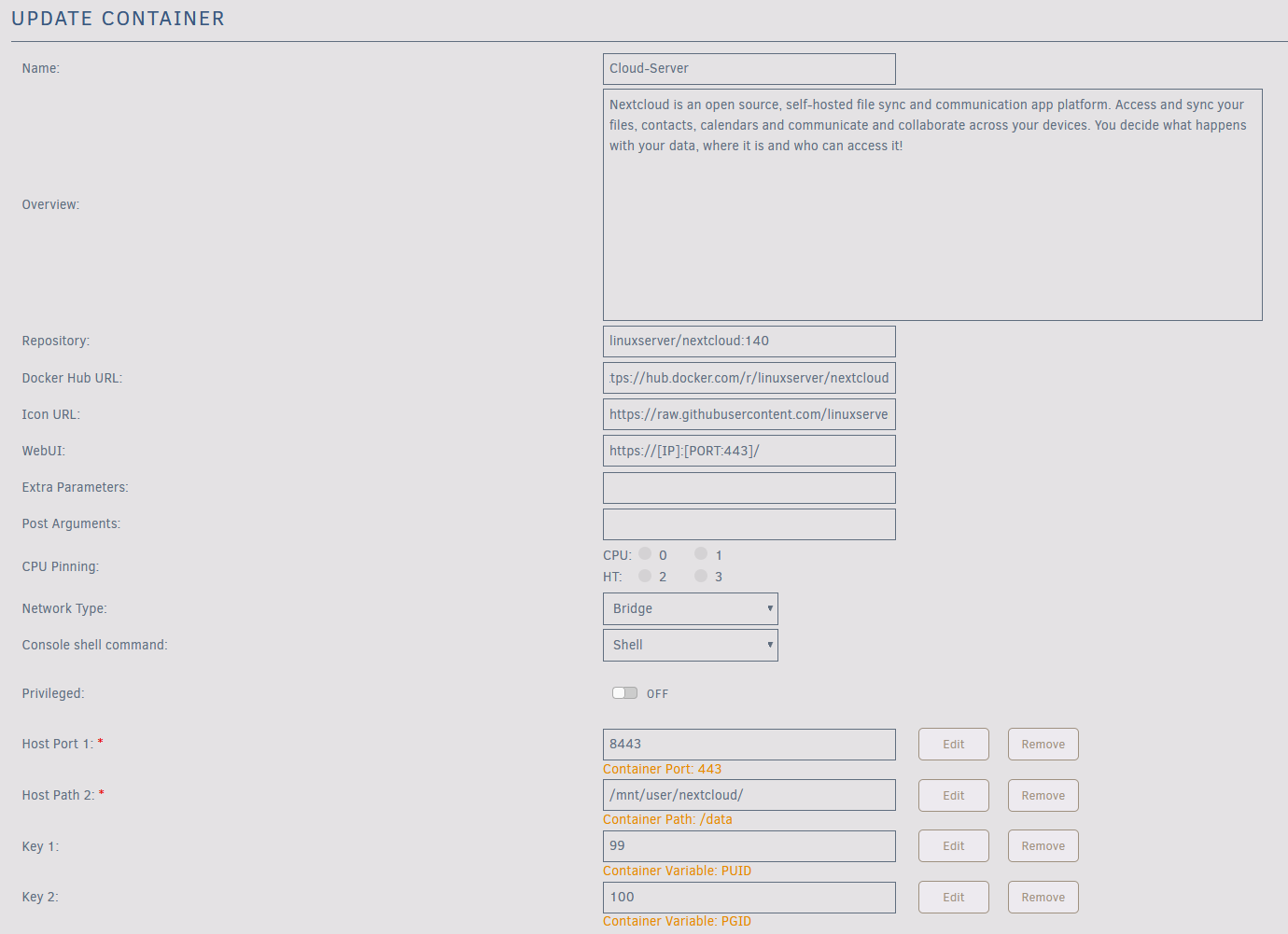

Hello, I'm trying to update my way up into modern times. I'm currently at Nextcloud 17 an stuck. "occ update:check" shows:
Nextcloud 18.0.14 is available. Get more information on how to update at https://nextcloud.com/outdated-php-7-1/
The docker container in unraid is up-to-date and "php --version" shows 7.1.17. I couldn't find a solution anywhere.
What am i missing? Thanks.

Hello,
I tried "updater.phar" and nothing happend
and "occ upgrade" says: "Nextcloud ist already latest version"
But "occ update:check" says:
"Nextcloud 18.0.14 is available. Get more information on how to update at https://nextcloud.com/outdated-php-7-1/.
1 update available"
(same as in the UI)
It still seems I need a newer PHP. This is a standard linuxserver.io unraid docker container and I couldn't find anything about this problem, so the update from Nextcloud 17 to 18 probably worked for most, but why not for me?

updater.phar had NO output at all?
Open nextcloud template (Right click docker , click edit)
Top right corner click advanced
Put a screenshot of it (i need the Repository field)
Hide any personal info if there is any

Yes, updater.phar had NO output at all, or any reaction I could see.
Repository: linuxserver/nextcloud:140
Docker Hub URL: https://hub.docker.com/r/linuxserver/nextcloud
Wow this tag (140) is 3 years old.
try this tag, and try to update and upgrade again.
linuxserver/nextcloud:18.0.4-ls81

Yes, I started my update-journey somewhere around Nextcloud 14.
I will try the tag tonight.
When I reach the current Nextcloud version, is it save to use the "latest" tag, or should I  match the tag with the Nextcloud version?

Thank you very much for your help. With the new tag I was able to update all the way to Nextcloud 20.0.8.1. I also change the tag to "20.0.0-ls122", with "latest" I couldn't log in anymore.
One question: My Nextcloud says it is Version 20 and up-to-date, but I thought version 21 ist the current version of Nextcloud? Even changing to beta channel it says it's up-to-date. Or is Nextcloud Hub different to Nextcloud?
Thanks.
Thanks.
After changing to :latest delete "/config/nginx/site-confs/default" file and restart docker. There was some changes there that need to be re downloaded.
Nextcloud v21 is the stable version, but it's not released to all people the same time, so they can fix any bugs that appear. (im still on 20) But on beta is should show up. Maybe after deleting the mention default file and restarting docker it will show up on beta.
Source: https://hub.docker.com/r/linuxserver/nextcloud/ Bottom of the page there is a changelog
