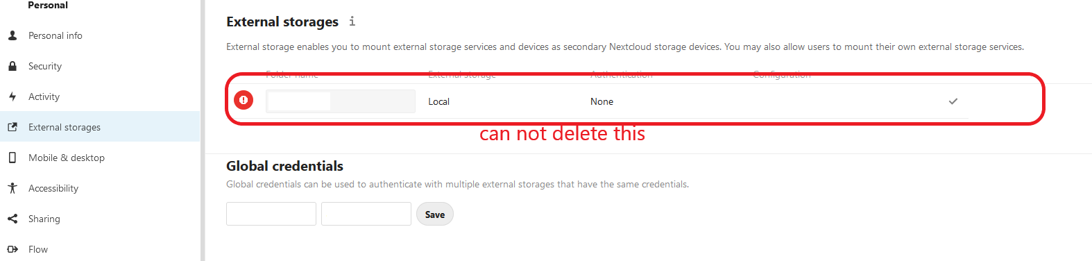

Hi all,
After a reinstall of Nextcloud, there is still an old entry from the former installation in "External storages" which can not be deleted. The link worked fine in the former installation, but doesn't anymore. How can i delete this entry? Thank you for help!
