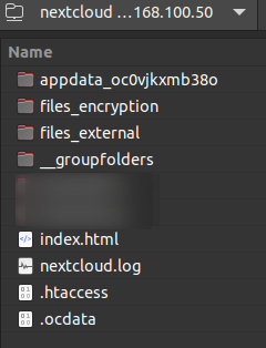

Hello,
I've just set up Nextcloud, by following Space Invader One's video's about it.
When I was done with his videos it came up with the error about untrusted domains, and gave me this link:
https://docs.nextcloud.com/server/20/admin_manual/installation/installation_wizard.html#trusted-domains
So I went in, and added my subdomain, and rebooted.
Then it gave another error I forgot, so I tried to reverse it, by removing the sub domain, and now it says;
"Your data directory is invalid Ensure there is a file called ".ocdata" in the root of the data directory."
- So I checked if the file was missing, and it's not.
I tried googling the error, and some places it says something about cron jobs.
I'm not sure how to proceed from now on, and I would prefer not to set it up again.
Does anyone have a solution?
Don't know if it will help but I have the IP of my unraid server and the domain name of my nextcloud instance (nextcloud.mydomain.com) in the trusted domains. I would suggest you change that back and try to solve the other error.
I started over today, and did the same thing.
Now it works.
I don't know why it didn't work the first time.
