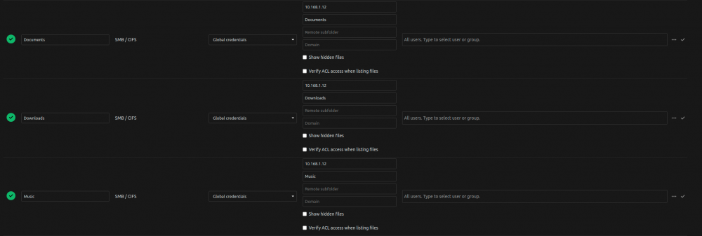

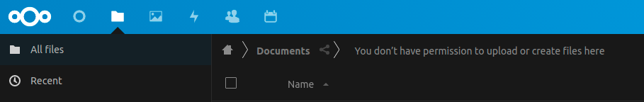

Recently managed to upgrade to 20.05, however I get the notification that I don't have permission to upload or create files in one of my external storage mounts.
I have permissions within each of the directors, just not the root directory of that share (which is mounted via "external storages" in Nextcloud). All my other mounts work fine.
Any idea as to why this has happened?
Is there any chance you have mounted the root is the /mnt/user and not a share? like /mnt/user/downloads
Hi Skois
My shares are all mounted as follows:
It appears to be some kind of weird permissions error, maybe to do with SMB rather than a mounting issue.
Hi Skois
Open unraid's terminal and
go to /mnt/user , do  ls -la
go to /mnt/user/Music , do ls -la
And post results, just to check root and child folders have the same permissions

4 minutes ago, Ntouchable said:
root@Tower:/mnt/user# ls -la
total 24
drwxrwxrwx 1 nobody users  116 Jan 11 18:35 ./
drwxr-xr-x 9 root   root   180 Jan 11 18:24 ../
-rw-r--r-- 1 nobody users  324 Aug 21  2018 .htaccess
-rw-r--r-- 1 nobody users    0 Aug 21  2018 .ocdata
drwxrwxrwx 1 nobody users  167 Jan 28 19:28 YYYY/
drwxrwxrwx 1 nobody users  157 Mar 28  2020 Backups/
drwxrwxrwx 1 nobody users   18 Jan  9 21:55 ZZZ/
drwxrwxrwx 1 nobody users   24 Jan 24 19:01 Documents/
drwxrwxrwx 1 nobody users   60 Jan 17 16:16 Downloads/
drwxrwxrwx 1 nobody users    6 Jan 11 18:29 XXXX/
drwxrwxrwx 1 nobody users   33 Nov 13 19:32 Music/
drwxrwx--- 1 nobody users  292 Nov  6 19:25 Nextcloud/
drwxrwxrwx 1 nobody users  180 Jun 26  2020 Pictures/
drwxrwxrwx 1 nobody users 4096 Nov 12 21:26 TV/
drwxrwxrwx 1 nobody users   20 Aug 19  2018 Videos/
drwxr-xr-x 1 nobody users   71 Jan  3 12:42 admin/
drwxrwxrwx 1 nobody users  178 Jan 23 17:53 appdata/
drwxr-xr-x 1 nobody users   30 Aug 21  2018 appdata_ocsnukqijq95/
drwxrwxrwx 1 nobody users  100 Dec 31 15:06 domains/
-rw-r--r-- 1 nobody users    0 Aug 21  2018 index.html
drwxrwxrwx 1 nobody users    6 Dec 31 15:10 isos/
drwxrwxrwx 1 nobody users   26 Jul 14  2019 system/

Hmm seems okay. Was it working before?
Also 20.0.6 is release. Might worth a shot
Edited by skois
It was working back when I was on version 18 a week ago.
I just tried upgrading to 20.0.6 and it doesn't seem to have made a difference (although that did fix another issue I was having).
Overall it seems very odd. It isn't causing me any headaches at the moment so I might see if the next release fixes it. If not I will raise the issue on the Nextcloud forum.
Appreciate your help.

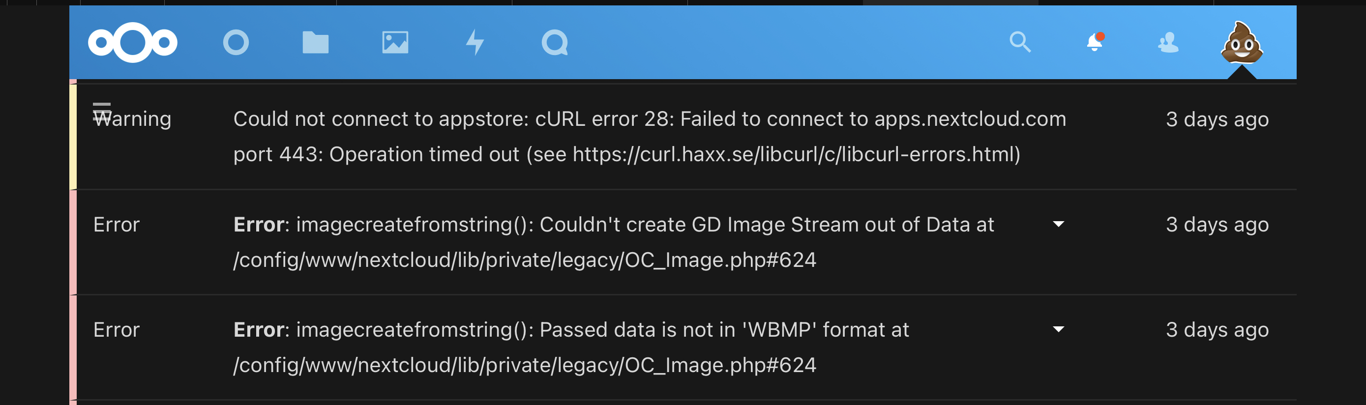

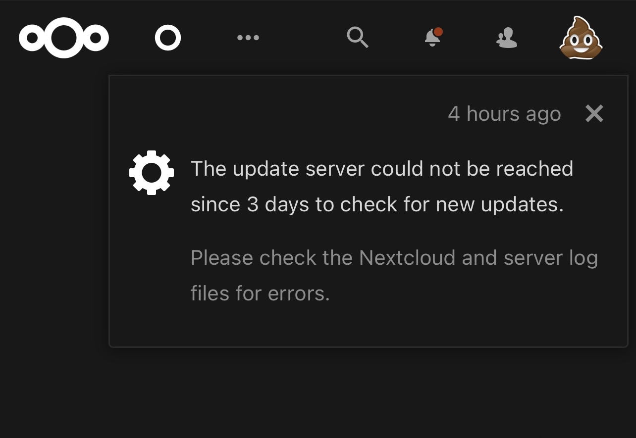

Would that be related to seeing this in my NC instance today? Looks like AppStore opens and such today though? Also seeing update to 20.0.7; maybe that fixes conundrum?
Also, with apps server maybe being broke is it even safe to attempt to update to 20.0.7 today at all? [emoji848]

It seems (at least on my end) that everything is back to normal, so I've disabled the above settings and updated my instance to 20.07 just fine...
Same upgraded to 20.0.7 without incident. Thanks!
