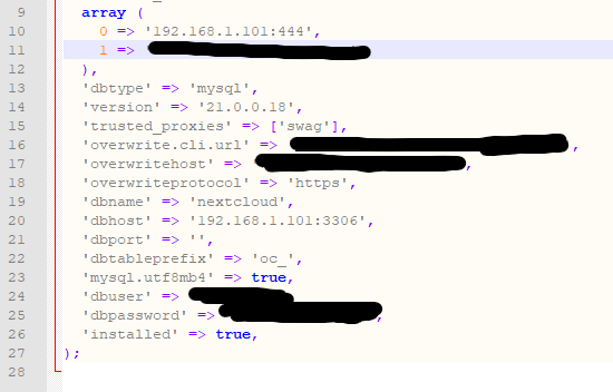

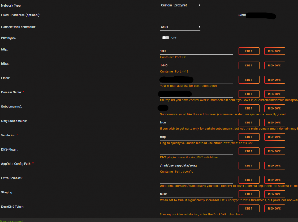

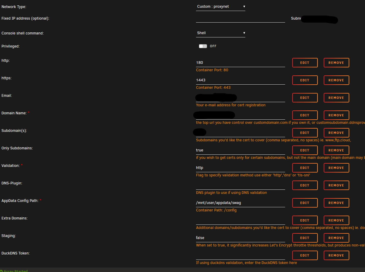

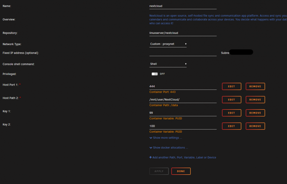

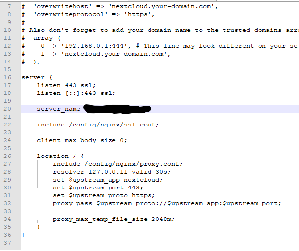

On 3/2/2021 at 12:21 AM, vinckcent said:
Hello guys, i just got into unraid in the last few days, and i follow Spaceinvader One's video on how to set up nextcloud and reverse Proxy.
It was easy to setup nextcloud for home network, i can connect to it no problem.
But when i tried to configure a reverse proxy, it showed the Welcome to your SWAG instance picture below. I can connect to my domain that i typed in swag docker on my phone network, still the same picture though, so i think it is not a port forwarding problem.
I did everything exactly the same as the video except i am using the new swag docker.
Ok I later searched lets-encrypt and nextcloud instead of swag and nextcloud, and I found the solution for my case.
