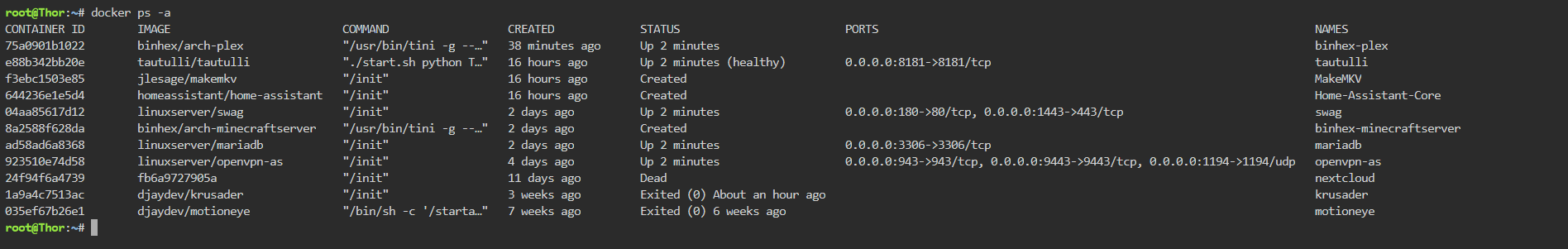

1 minute ago, Michelle Bausager said:
Here you go, and thank for looking into it :)29550909_dockerps-a.thumb.png.eb9460680aa68982daafb7a0c0c8cb1c.png
FIRST go to your nextcloud docker, make a screeshot of the template, then
Ok now do "docker rm nextcloud"
After that try to force update the docker again. If docker isn't in the list after running the above command, dont panic.
Just go to the bottom of docker tab, click add container, click the dropdown list and select the nextcloud template. (check that all is correct) and hit apply.

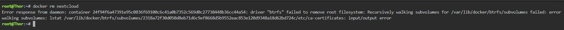

The plot thickens! The "docker rm nextcloud" got an error:Error.thumb.png.ffe7818e05e4f39451d6281a9eea54cf.png
I suspect corrupted docker image, but let's try.
Go Settings -> Docker -> select correct errors and hit scrub.
Try the above again.
Unfortunately I get the same error as before. (It is my bedtime, but I'll surely be back tomorrow! Thank again for the help so far!)
Edited by Michelle Bausager
Spelling
2 minutes ago, Michelle Bausager said:
Unfortunately I get the same error as before. (Tis my bedtime, but I'll surely be back tomorrow! Thank again for the help so far!)
So the other solution is.
Make a screenshot of all your dockers.
Go Settings -> Docker, Stop docker, delete docker image. Start docker.
Go to docker tab, click add container, and select from the dropdown one by one your dockers. and hit apply to install.
will take some time, but you will be back and running.
I'll be out of town for a couple of days and can see there's a new update(6.9.1). I'm going to update it and as soon as i return, I'll try the previous solutions, otherwise I'll try the your new sugestion. But I really don't like deleting things :E Feels like there's a high probability of error from my side, but hey, gotta learn somehow :)
Deleting dockers, don't affect your data (in normal scenarios), And when reinstalling they should be back like they was before!
Seems to have worked. A surprise was I needed to create a network "proxynet" again. But hey, seems to work.
Thank you so much :)
Happy that you are up and running again!!
