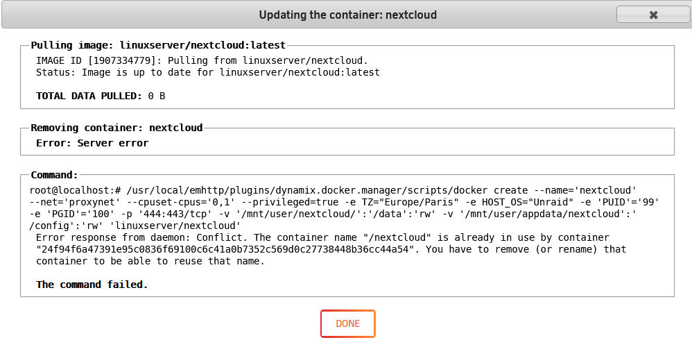

Hello, I'm trying to update my way up into modern times. I'm currently at Nextcloud 17 an stuck. "occ update:check" shows:
Nextcloud 18.0.14 is available. Get more information on how to update at https://nextcloud.com/outdated-php-7-1/
The docker container in unraid is up-to-date and "php --version" shows 7.1.17. I couldn't find a solution anywhere.
What am i missing? Thanks.

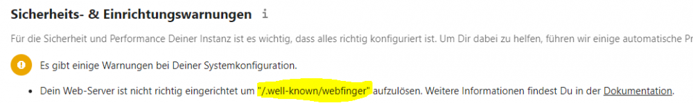

I have a silly question here. With the new update I started getting this I don't know where would I make the change. I'm assuming the let's encrypt file, but i've seen that htaccess somewhere too.
There are some warnings regarding your setup.
Your web server is not properly set up to resolve "/.well-known/webfinger". Further information can be found in the documentation.
Your web server is not properly set up to resolve "/.well-known/nodeinfo". Further information can be found in the documentation.
Your installation has no default phone region set. This is required to validate phone numbers in the profile settings without a country code. To allow numbers without a country code, please add "default_phone_region" with the respective ISO 3166-1 code ↗ of the region to your config file.
Your installation has no default phone region set. This is required to validate phone numbers in the profile settings without a country code. To allow numbers without a country code, please add "default_phone_region" with the respective ISO 3166-1 code [emoji658] of the region to your config file.
It's 4 posts above.

I'm in a funny situtation, ontop of the new update (6.9.0) I got some new gear.; X570 Motherboard with an 3700x AMD.
And my nexcloud suddenly stoped working.  It says it's dead and the logs just repeat:
e":"can not get logs from container which is dead or marked for removal"}dead.thumb.png.c674384946daa03ae71607dd56850231.png
When I try to start it, it says:
But I don't really know what caused it, or what happened?
I hope someone is wiser then me and know where to start troubleshooting or know the root cause.
(Well, chances are most of you are smarter and wiser then me :) )
(Well, chances are most of you are smarter and wiser then me [emoji4] )
Open advanced in docker tab (top right)
And do force update on nextcloud. Might help
Sent from my Mi 10 Pro using Tapatalk
Sad face ;( didn't work
open console (top right) and do "docker ps -a", post results please
Here you go, and thanks for looking into it :)29550909_dockerps-a.thumb.png.eb9460680aa68982daafb7a0c0c8cb1c.png
