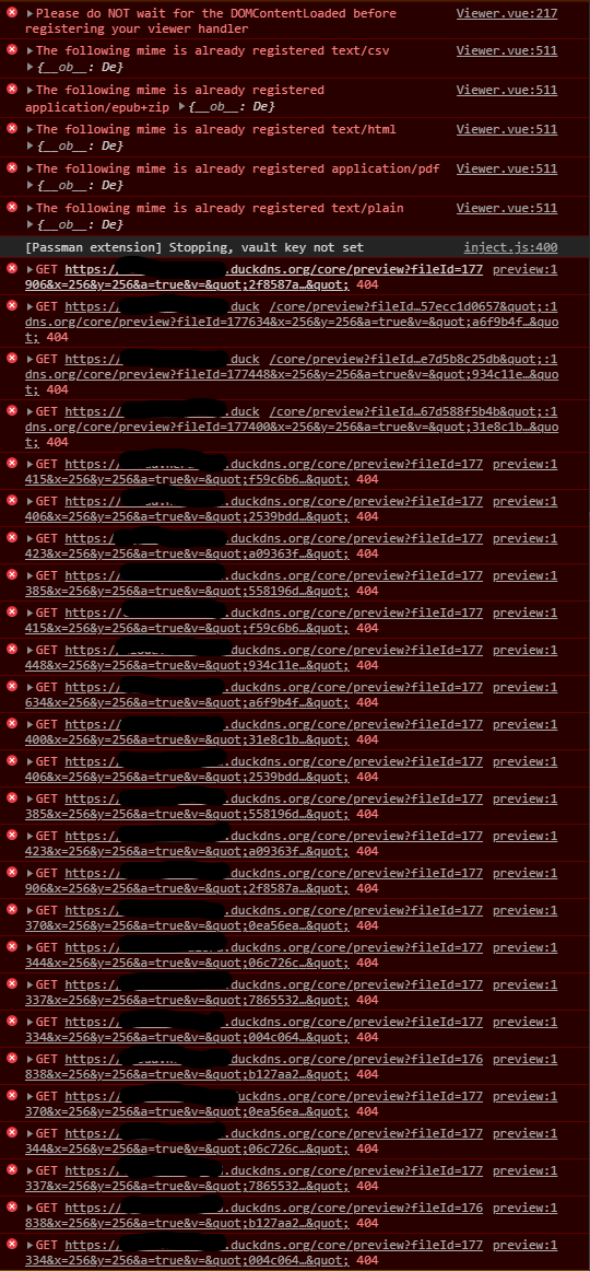

I believe that my upgrade broke something with the Photo viewer and I am getting error 404 for previews.
The photo tab intermittently displays the photos. I tried all kinds of occ commands.
What table do I look in to find fileID and corresponding file loaction?
Also can someone shine some light on how to clear the file cache and the file cache table, is this recommended?
Edited by exist2resist
Try first to do this
Right click on the docker and select console
"occ preview:repair"
"occ preview:delete_old"
"occ preview:generate-all"
This might fix it
This might fix it
It was the preview folder and database file locations that didn't add up.
I purged the appdata_xxxxxxxxx/preview folder, ran file scan and regenerated the previews from scratch.
Ran a bunch of occ repairs on the file system, database stuff, etc.
