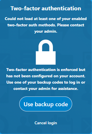

Anyone else have issues with Two-Factor TOTP Provider since the update to 20.0.6? The app has disappeared from my list... Its not in my disabled list, active list nor am I able to download it from the apps section. Problem I have is that it was active prior to the update and nextcloud is still looking for 2FA but says it hasnt been configured, as shown. I have managed to disable it for now but id like to actually have it active. Anyone else experience/fix this?
I was about to upgrade when I saw your message. Were you able to solve the issue and have TOTP working back as normal ?

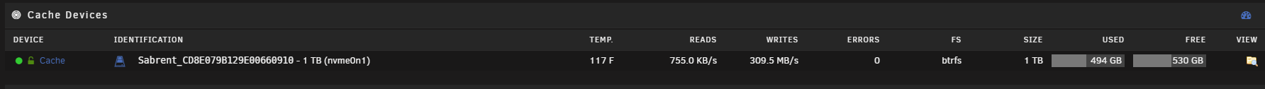

Hi folks, I searched for high IO but couldn't find any references.
below is an image of my cache drive IO with nextcloud docker image on. I added several "external storage" locations as "local" in nextcloud but other than that there's really nothing ON nextcloud. I do believe it's indexing photos metadata or something but I'm trying to find out why my cache drive is at 300-800 MB/s for nearly 24 hours after I install nextcloud. When I stop the nextcloud container the IO goes back to normal.
I do also have my mysql database on this cache drive too which is really only being used by nextcloud ATM. Any ideas on why such high IO?
Another thing to note, it's been writing at these speeds for nearly 24 hours, mover has not run, and yet, no major disk usage impact. The Used/free ratio really hasn't changed...any ideas here?

Ok I disabled the app before upgrading to 20.0.6 and enabled it afterwards without any issue.
 Yea im about to go through the manual process of installing the app now... just looking at the appdata for nextcloud it appears to have fully removed the app files from the app folder. I get that during install it may for whatever reason show the app as incompatible  with that version but im surprised it has disappeared from the app list as a download option!
EDIT
No joy on first attempt....
docker exec -it nextcloud occ app:install twofactor_totp
Error: Could not download app twofactor_totp
EDIT 2
Solved it...
I downloaded the .tar file fully extracted it and put it in the apps folder in the appdata and restarted nextcloud. The app re appeared in the disabled list for me. Enabled it and seems to be working as before. Still held the same link to my Google Auth app too. Was expecting to have to set this up again and delete the old one but seems to be fine.
Edited by tazire
Very strange. I had issues before upgrading (I was still on a 18.x version). The application tab was empty and I got the same message as you when trying via occ command. But it was solve with the update.
Hopefully everything is in order now.
