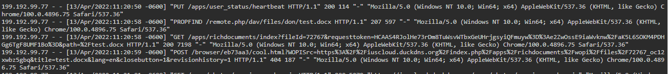

dius Posted April 13, 2022 Share Posted April 13, 2022 I'm still trying to get Collabora & Nextcloud to work together. Nextcloud shows that the Collabora server is reachable: Yet I can't edit any documents using the Collabora server: The swag log shows an error when I try to edit a document: And I get this error showing up in the Collabora log file: followed by several of these: I know it's asking a lot, but I have no real clue how to troubleshoot this. Any suggestions would be greatly appreciated. Thanks in advance... Quote Link to comment

dius Posted April 13, 2022 Share Posted April 13, 2022 38 minutes ago, Tolete said: please see updated variable entry on my post. Thanks for your response. This is how I setup my aliasgroup1 variable. I've tried it with the port 443 and without. Neither works. I'm using Swag as my reverse proxy, so the config files are different. Would it help if I posted it here? Thanks again for your response. Quote Link to comment
JonathanM Posted April 13, 2022 Share Posted April 13, 2022 I just had a breakthrough, don't know if it's luck or the actual solution, but for me, Key: alias_group1 Value: https://my\\.nextcloud\\.domain:443 worked, finally. Apparently the _ between alias and group1 is quite important. Don't know how others have gotten it to work, but that's what did it for me. Quote Link to comment
dius Posted April 13, 2022 Share Posted April 13, 2022 (edited) On 4/13/2022 at 1:34 PM, JonathanM said: I just had a breakthrough, don't know if it's luck or the actual solution, but for me, Key: alias_group1 Value: https://my\\.nextcloud\\.domain:443 worked, finally. Apparently the _ between alias and group1 is quite important. Don't know how others have gotten it to work, but that's what did it for me. Glad that worked for you. Unfortunately it didn't work for me. I'll keep plugging away... *UPDATE* I got it working with a configuration I had previously tried but didn't work at the time. I set the value for the alliasgroup1 key to https://mycloud.mydomain.org:443. This format now works for me. Hopefully it helps others as well. Edited April 18, 2022 by dius Quote Link to comment

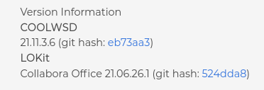

blaine07 Posted April 13, 2022 Share Posted April 13, 2022 I just had a breakthrough, don't know if it's luck or the actual solution, but for me, Key: alias_group1 Value: https://my\\.nextcloud\\.domain:443 worked, finally. Apparently the _ between alias and group1 is quite important. Don't know how others have gotten it to work, but that's what did it for me.What version Collabora you using? Quote Link to comment
JonathanM Posted April 13, 2022 Share Posted April 13, 2022 6 minutes ago, blaine07 said: What version Collabora you using? Quote Link to comment
blaine07 Posted April 13, 2022 Share Posted April 13, 2022 Yeah I don’t see the _ anywhere defined. I’m super confused by all this lol Quote Link to comment
JonathanM Posted April 13, 2022 Share Posted April 13, 2022 2 minutes ago, blaine07 said: Yeah I don’t see the _ anywhere defined. I’m super confused by all this lol Neither did I, except in the logs as an error message. I was watching the collabora container logs in realtime as I attempted to edit a document, and it called out my FQDN and said it wasn't authorized in the alias_groups. So I added 1+1 and got 3. If that is indeed the case, and all the stuff I found online with aliasgroup1 is erroneous, I'm going to be rather upset that the internet wasted half my day. 🤣 All I know is, I made the change, and now it works, and no nastygrams in the logs about my domain not being authorized. Quote Link to comment
