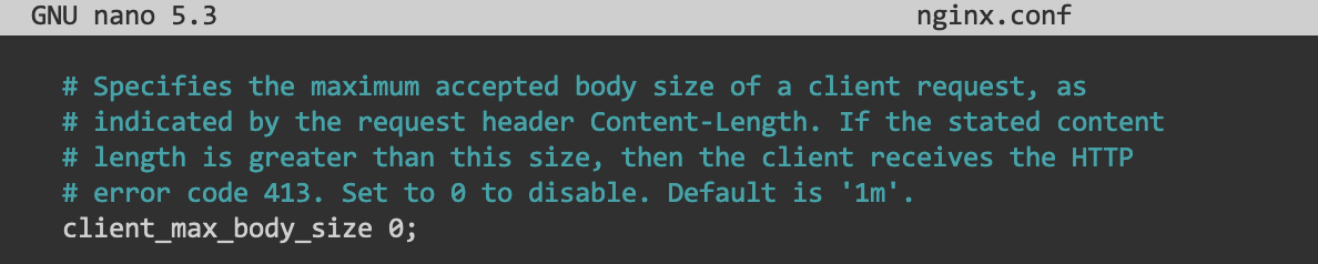

malebron Posted February 25, 2022 Share Posted February 25, 2022 Hi I just installed this Docker along with Mariadb and Swag, exactly as per Space Invader One's video, and everything is working fine. I'm brand new to Unraid and Dockers, so I followed every step very carefully. My problem is that there seems to be an upload size limit. Files over 1GB are not uploaded and my Mac desktop app shows the error "Server replied "413 Request Entity Too Larg..." I have searched this thread and the web without finding a clear resolution that I can understand. Are there some clear instructions to increase the max file size somewhere? Thanks! Quote Link to comment

malebron Posted February 25, 2022 Share Posted February 25, 2022 Thanks snowboarder714, Yeah I looked at these but the situation doesn't look like my issue ...and I don't see a resolution. I have a brand spanking new clean install on a brand new server. I have only installed the required Dockers for Nextcloud -- everything exactly done per Space Invader One's video. Other than upload file size, its working well. So... 1) Is there SUPPOSED to be a file size limit? In which case, I'm looking for the settings or parameters to increase this value? OR 2) Is file size SUPPOSED to be unlimited, and this condition is an error which needs troubleshooting? Also: total noob here, so you know... Thanks. Quote Link to comment
alturismo Posted February 25, 2022 Share Posted February 25, 2022 1 hour ago, malebron said: 1) Is there SUPPOSED to be a file size limit? In which case, I'm looking for the settings or parameters to increase this value? may start here https://docs.nextcloud.com/server/latest/admin_manual/configuration_files/big_file_upload_configuration.html#:~:text=The default maximum file size,filesystem and operating system allows. its been also discussed several times here, now depending on your setup (i assume lsio and reverse proxy etc) i would look at the nginx parts on all documentations about file size upload limits. Quote Link to comment
gacpac Posted February 25, 2022 Share Posted February 25, 2022 @snowborder714 @malebron I found it That's I did, and I think it should be added to a F.A.Q somewhere in the top of the forum who knows @linuxserver.io https://github.com/nextcloud/docker/issues/762#issuecomment-504225433 Quote Link to comment
malebron Posted February 25, 2022 Share Posted February 25, 2022 Hmm. This talks about a parameter for letsencrypt -- which I don't have installed. Just swag (per the video). I found a "client_max_body_size" parameter in ~appdata/swag/nginx/nginx.conf, but that was correctly set to 0. However, IF that had been set too low, it would have generated the 413 error I'm seeing. Just for grins I tried changing it to 10G and restarting the container, but no change. Are there any other conf files I should be looking for? Quote Link to comment
JonathanM Posted February 25, 2022 Share Posted February 25, 2022 1 hour ago, malebron said: This talks about a parameter for letsencrypt -- which I don't have installed. Just swag The swag container was originally known as letsencrypt, before the people running the letsencrypt service objected. Quote Link to comment

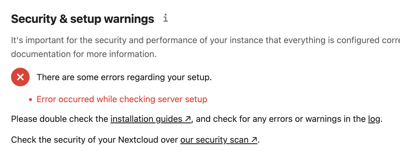

Tucubanito07 Posted February 25, 2022 Share Posted February 25, 2022 On 2/17/2022 at 11:12 AM, Tucubanito07 said: Anyone has this issue on their Nextcloud instance? I have searched multiple times everywhere and nothing. I also checked the logging screen in nextcloud and nothing comes up. I am on version 23.0.2. Any help is greatly appreciated. Hello, Has anyone encounter this issue or does anyone know how to resolve this? I dont see anything on the logs. Quote Link to comment

FiNakoma Posted March 5, 2022 Share Posted March 5, 2022 On 2/25/2022 at 7:55 PM, Tucubanito07 said: Hello, Has anyone encounter this issue or does anyone know how to resolve this? I dont see anything on the logs. Error occurred whilst checking server setup Yeah I'm stuck with this same issue. Fresh install with Postgres14 and NginxProxyManager following SpaceInvaders guide. Anyone got any ideas? Quote Link to comment
