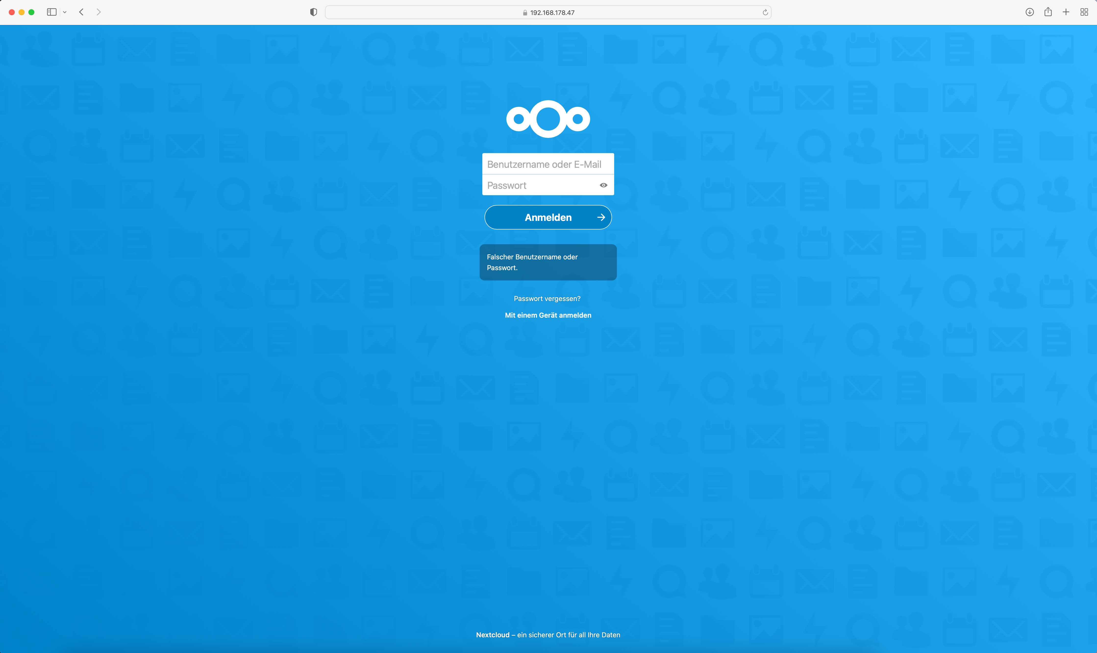

Near Posted March 11, 2022 Share Posted March 11, 2022 Hey! I am new to Unraid and accordingly to nextcloud. I have been trying to install nextcloud (linuxsserverio) on my Unraid server. Along with MariaDB and I followed exactly the steps in Space Invader One's video. Up to the point 9:14 (https://youtu.be/id4GcVZ5qBA?t=554). But as soon as I try to log in again the next day to continue with the setup I get the error "Wrong username or password". I have checked the data several times and also completely rebuilt nextcloud & MariaDB (including cache clean). However, I keep getting the same error. Also resetting the password via terminal as mentioned in your documentation does not work. Screenshots attached. What can I do to get nextcloud to work? Thank you! Quote Link to comment

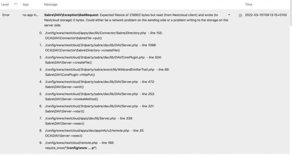

Profezor Posted March 15, 2022 Share Posted March 15, 2022 Trying to upload a file from the Nextcloud app. Folder is an external storage folder linked to Paperless-ng. Worked easily in the past, now only errors. Any suggestions ? I am sure it is a easy thing, but I am missing it. Thanks Quote Link to comment

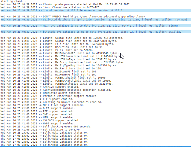

Tolete Posted March 17, 2022 Share Posted March 17, 2022 (edited) Need a hand, trying to confirm whether or not Nextcloud and ClamAV are playing nicely together. Nextcloud + 'Antivirus for files' app ClamAV; I went with 'mkodockx/docker-clamav:alpine' repository next I went to the Nextcloud container and used the --link flag under 'Extra Parameters:' -not sure if this is required still or deprecated. --link ClamAV:ClamAV I guess I'm expecting ClamAV to scan any file uploaded. I tested by simply uploading both non-infected and EICAR test files. I guess i can check the ClamAV logs, but will or is there a visual indication that the file is getting scan by ClamAV? Edited March 17, 2022 by Tolete Quote Link to comment

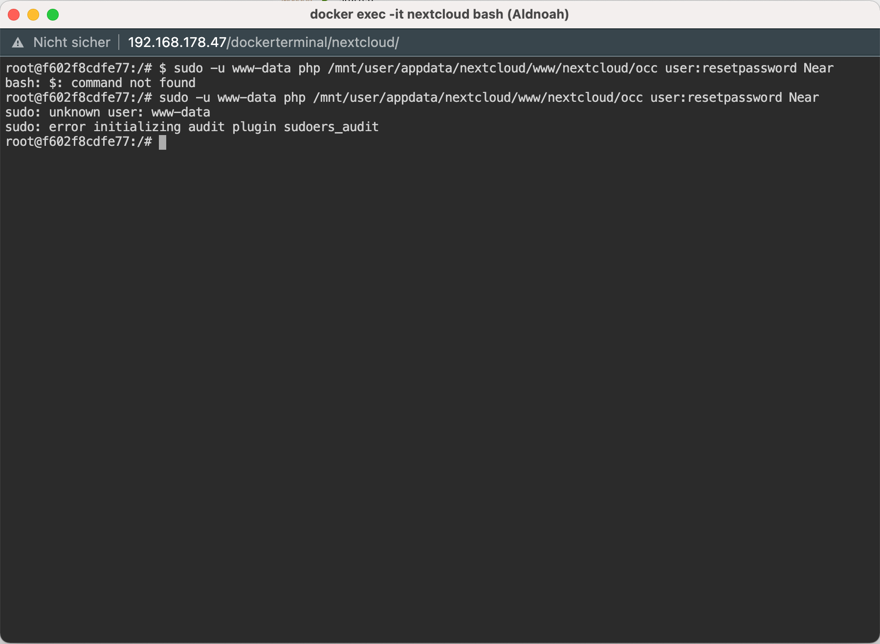

tallbill Posted April 6, 2022 Share Posted April 6, 2022 (edited) 13 hours ago, Archonw said: @tallbill of course you can reset the admin passwort. Open the console for this container. Follow the official documentation. https://docs.nextcloud.com/server/latest/admin_manual/configuration_user/reset_admin_password.html Yeah I've tried that and several variants with no luck. Unknown user: www-data error initializing audit plug sudoers_audit Edited April 6, 2022 by tallbill Quote Link to comment
RiDDiX Posted April 6, 2022 Share Posted April 6, 2022 1 hour ago, tallbill said: Yeah I've tried that and several variants with no luck. Unknown user: www-data error initializing audit plug sudoers_audit linuxserver uses the PUID and PGID. Therefore you have to look up what user you set up. Quote Link to comment
