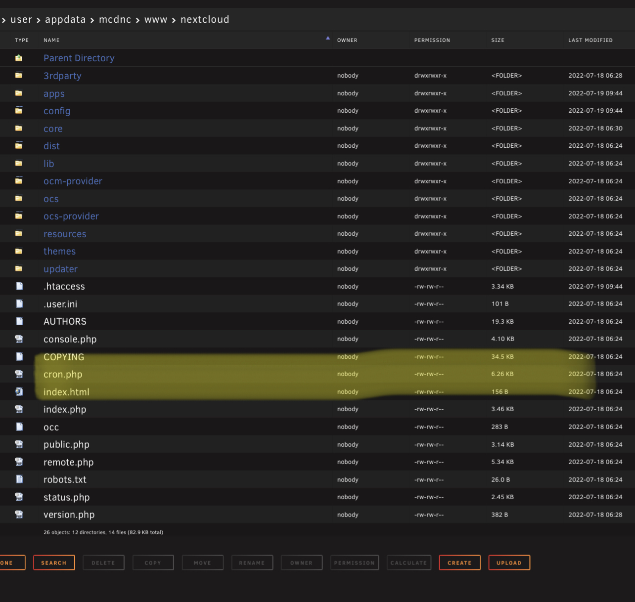

Seeking assistance with an issue I've been fighting for several months and several updates of Nextcloud:
My Nextcloud container will crash my entire Unraid server ever 1 to 4 days by producing a large number of cron calls that never finish and can't be killed. I've attached a screenshot of the zombie nextcloud cron jobs; sometimes this will grow to hundreds long. This appears to happen randomly; independent of server load or any other factors I can tell.
When this happens I can't stop (or kill) the Nextcloud container. Nextcloud is completely unresponsive and some basic Unraid fucntions/shares will fail. The only way to get the system functioning again is to disable Docker and then reboot Unraid.
Currently running Nextcloud 24.0.3 but the issue was present in past versions (22, 23).
Container is up to date linuxserver/nextcloud:24.0.3
Unraid 6.10.3
Unraid 6.10.3
Can you post cron file it’s referencing? Is their some incorrect syntax in it or something?
Potentially make a new cron.php file and make sure permissions are right? I’d backup old one but don’t think any install specific info is in the file but not positive.
https://github.com/nextcloud/server/blob/master/cron.php
Edited by blaine07
Sure! Cron file attached. Thanks for taking a look.
cron.php
Both my instances of cron file show as this FWIW. I’d just shut down NC, rename old cron.php. Make a new one, then set permissions as:
then start NC Back and see what happens. Keep old file. I don’t think anything install specific is in it but I’m known to be wrong.. a lot.

On 1/8/2022 at 1:20 PM, Vitor Ventura said:
Hello,
Im having a problem, cant make it work, nextcloud is tell me, that is updating, but never finish.
Log is simple:
Could not open input file: /config/www/nextcloud/cron.php
dit you find the solution?
yeah, change appdata folder name do something nextcloud.backup, and redo everything

On 6/18/2022 at 12:23 PM, daniel329 said:
Hello all,
I'm unable to get this image running. I can get to the setup page of Nextcloud but after entering the info I get a 504 error and then redirected to the setup page. I have to manually clear the AppData for nextcloud each time because if I keep trying it tells me the user already exists. The logs have this repeating message:
Exception: Not installed in /config/www/nextcloud/lib/base.php:282
Stack trace:
#0 /config/www/nextcloud/lib/base.php(663): OC::checkInstalled()
#1 /config/www/nextcloud/lib/base.php(1104): OC::init()
#2 /config/www/nextcloud/cron.php(43): require_once('/config/www/nex...')
#3 {main}
I've searched and haven't come up with any solutions. I did notice the download from Community Applications was quite slow but maybe the servers are just under load. Thanks!
Did you figure out what was causing this? I am having the same problem.
