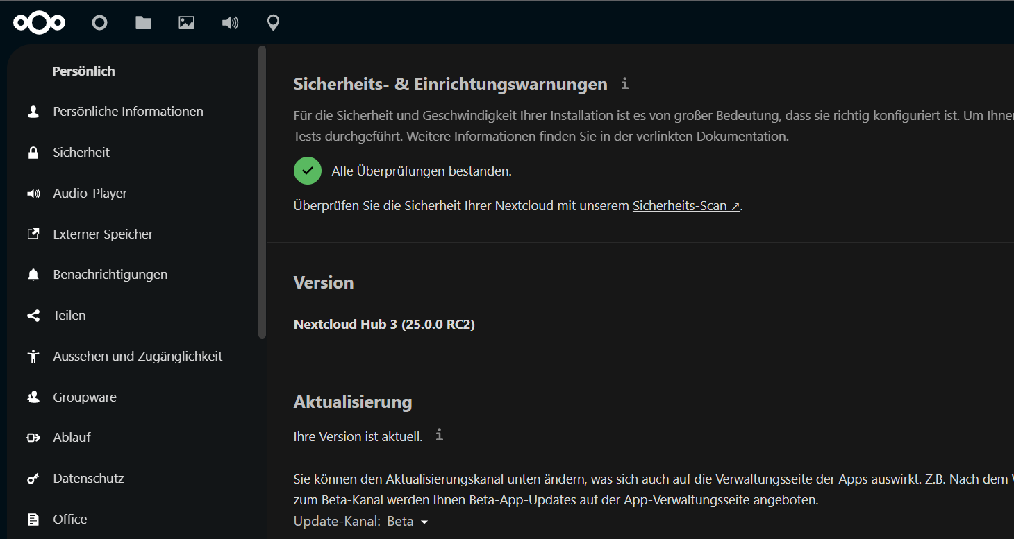

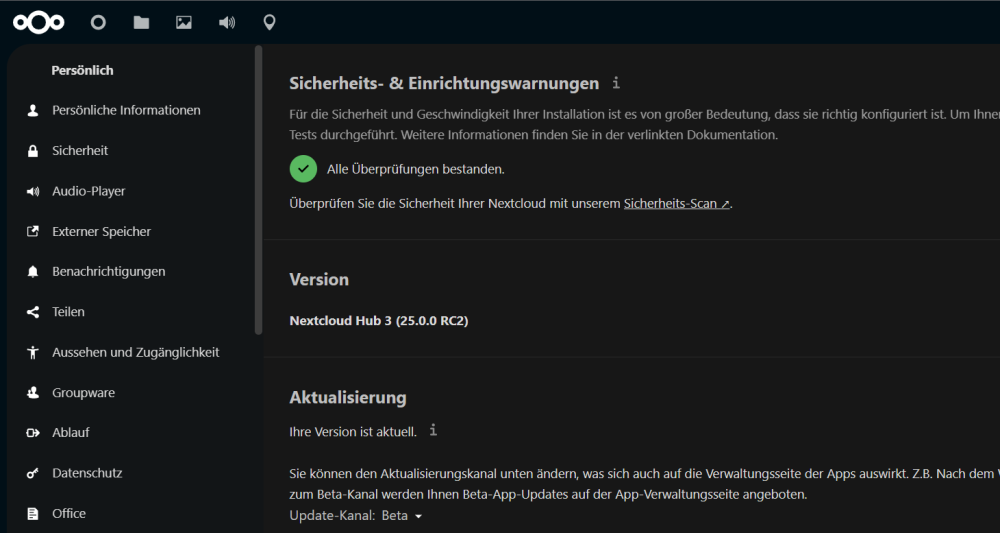

11 hours ago, Serverless said:
anyone tried to install the new Nextcloud Hub 3 on the beta channel?
worked fine here without issues, dark mode needs some adjustments ;)

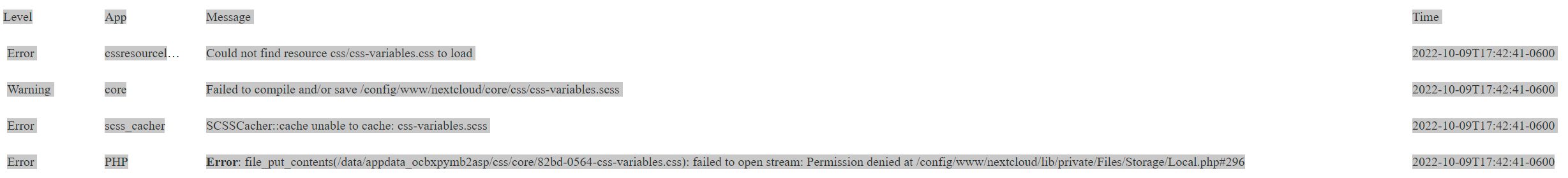

Hi
I updated unraid to version 6.11.0 and then Nextcloud to the latest version.
Then came the error message that "Your data directory is not writable..."
I sent a chown for www-data in the docker itself. No change
So I sent off with the addon "New Permissions" on the unraid-shares of nextcloud.
Now it comes alternately when reloading the page an internal sever error and the 0700 error. I would be very grateful for your help. I hope I can still easily fix this?
