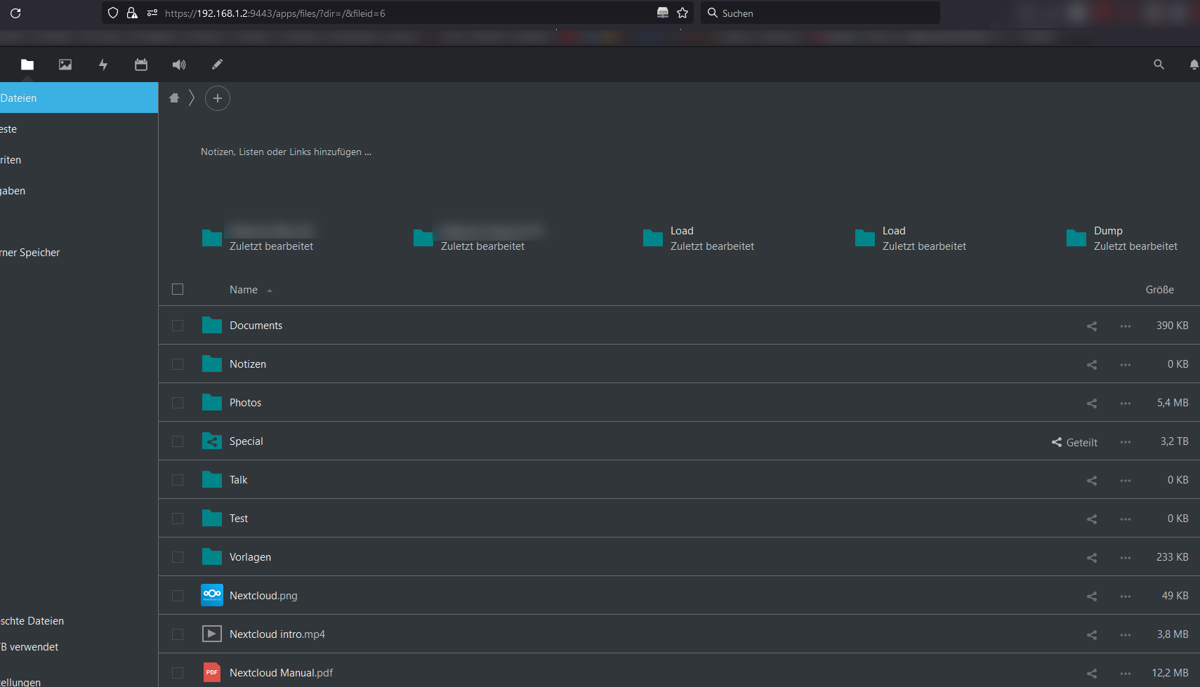

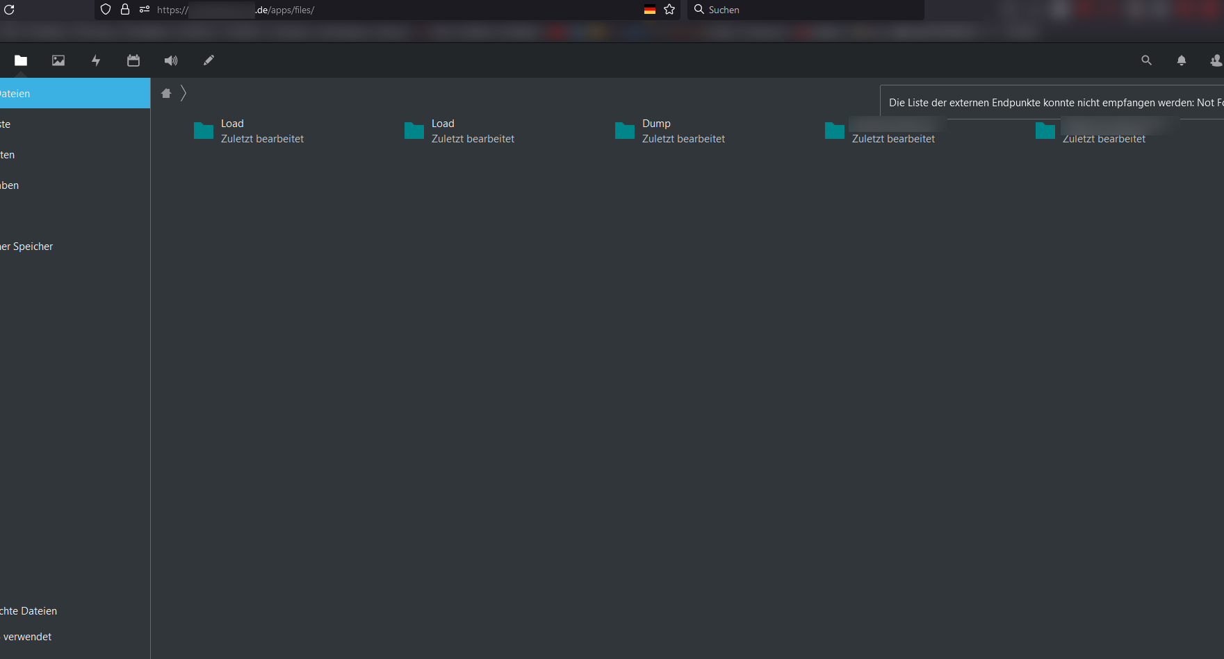

Hey, I got an error if I want to access via domain.
The error is translatet: "The list of external endpoints could not be received: Not Found"
If I log in the domain it doesn't show me the list of files. ( look at the picture )
In the local ip adress everyhting works fine.
I think it is my nginx/site-confs/default file, what do you say?
Components:
Nextcloud version: 24.0.5
Operating system: Unraid 6.11.1
Apache or nginx : nginx/1.20.2
PHP version: 7.4.26
config.php:
<?php
$CONFIG = array (
  'memcache.local' => '\\OC\\Memcache\\APCu',
  'datadirectory' => '/data',
  'instanceid' => 'ocrdy75awbjE',
  'passwordsalt' => 'pw',
  'secret' => 'pw',
  'trusted_domains' =>
  array (
    0 => '192.168.1.2:9443',
    1 => 'main.de',
  'dbtype' => 'mysql',
  'version' => '24.0.5.1',
  'overwrite.cli.url' => 'https://main.de',
  'dbname' => 'user',
  'dbhost' => '192.168.1.2:3306',
  'dbport' => '',
  'dbtableprefix' => 'oc_',
  'mysql.utf8mb4' => true,
  'dbuser' => 'user',
  'dbpassword' => 'pw',
  'installed' => true,
  'auth.webauthn.enabled' => false,
  'mail_smtpmode' => 'smtp',
  'mail_smtpsecure' => 'ssl',
  'mail_sendmailmode' => 'smtp',
  'mail_smtphost' => 'smtp.domain.de',
  'mail_from_address' => 'info',
  'mail_domain' => 'main.de',
  'mail_smtpauthtype' => 'LOGIN',
  'mail_smtpauth' => 1,
  'mail_smtpport' => '465',
  'mail_smtpname' => '[email protected]',
  'mail_smtppassword' => 'pw',
  'maintenance' => false,
nginx/site-confs/default:
upstream php-handler {
    server 127.0.0.1:9000;
server {
    listen 80;
    listen [::]:80;
    server_name _;
    return 301 https://$host$request_uri;
server {
    listen 443 ssl http2;
    listen [::]:443 ssl http2;
    server_name _;
    ssl_certificate /config/keys/cert.crt;
    ssl_certificate_key /config/keys/cert.key;
    # Add headers to serve security related headers
    # Before enabling Strict-Transport-Security headers please read into this
    # topic first.
    #add_header Strict-Transport-Security "max-age=15768000; includeSubDomains; preload;" always;
    # WARNING: Only add the preload option once you read about
    # the consequences in https://hstspreload.org/. This option
    # will add the domain to a hardcoded list that is shipped
    # in all major browsers and getting removed from this list
    # could take several months.
    # set max upload size
    client_max_body_size 512M;
    client_body_timeout 300s;
    fastcgi_buffers 64 4K;
    # Enable gzip but do not remove ETag headers
    gzip on;
    gzip_vary on;
    gzip_comp_level 4;
    gzip_min_length 256;
    gzip_proxied expired no-cache no-store private no_last_modified no_etag auth;
    gzip_types application/atom+xml application/javascript application/json application/ld+json application/manifest+json application/rss+xml application/vnd.geo+json application/vnd.ms-fontobject application/wasm application/x-font-ttf application/x-web-app-manifest+json application/xhtml+xml application/xml font/opentype image/bmp image/svg+xml image/x-icon text/cache-manifest text/css text/plain text/vcard text/vnd.rim.location.xloc text/vtt text/x-component text/x-cross-domain-policy;
    # HTTP response headers borrowed from Nextcloud `.htaccess`
    add_header Referrer-Policy                      "no-referrer"   always;
    add_header X-Content-Type-Options               "nosniff"       always;
    add_header X-Download-Options                   "noopen"        always;
    add_header X-Frame-Options                      "SAMEORIGIN"    always;
    add_header X-Permitted-Cross-Domain-Policies    "none"          always;
    add_header X-Robots-Tag                         "none"          always;
    add_header X-XSS-Protection                     "1; mode=block" always;
    # Remove X-Powered-By, which is an information leak
    fastcgi_hide_header X-Powered-By;
    root /config/www/nextcloud/;
    # display real ip in nginx logs when connected through reverse proxy via docker network
    set_real_ip_from 172.0.0.0/8;
    real_ip_header X-Forwarded-For;
    # Specify how to handle directories -- specifying `/index.php$request_uri`
    # here as the fallback means that Nginx always exhibits the desired behaviour
    # when a client requests a path that corresponds to a directory that exists
    # on the server. In particular, if that directory contains an index.php file,
    # that file is correctly served; if it doesn't, then the request is passed to
    # the front-end controller. This consistent behaviour means that we don't need
    # to specify custom rules for certain paths (e.g. images and other assets,
    # `/updater`, `/ocm-provider`, `/ocs-provider`), and thus
    # `try_files $uri $uri/ /index.php$request_uri`
    # always provides the desired behaviour.
    index index.php index.html /index.php$request_uri;
    # Rule borrowed from `.htaccess` to handle Microsoft DAV clients
    location = / {
        if ( $http_user_agent ~ ^DavClnt ) {
            return 302 /remote.php/webdav/$is_args$args;
    location = /robots.txt {
        allow all;
        log_not_found off;
        access_log off;
    # Make a regex exception for `/.well-known` so that clients can still
    # access it despite the existence of the regex rule
    # `location ~ /(\.|autotest|...)` which would otherwise handle requests
    # for `/.well-known`.
    location ^~ /.well-known {
        # The rules in this block are an adaptation of the rules
        # in `.htaccess` that concern `/.well-known`.
        location = /.well-known/carddav { return 301 /remote.php/dav/; }
        location = /.well-known/caldav  { return 301 /remote.php/dav/; }
        location /.well-known/acme-challenge    { try_files $uri $uri/ =404; }
        location /.well-known/pki-validation    { try_files $uri $uri/ =404; }
        # Let Nextcloud's API for `/.well-known` URIs handle all other
        # requests by passing them to the front-end controller.
        return 301 /index.php$request_uri;
    # Rules borrowed from `.htaccess` to hide certain paths from clients
    location ~ ^/(?:build|tests|config|lib|3rdparty|templates|data)(?:$|/)  { return 404; }
    location ~ ^/(?:\.|autotest|occ|issue|indie|db_|console)                { return 404; }
    # Ensure this block, which passes PHP files to the PHP process, is above the blocks
    # which handle static assets (as seen below). If this block is not declared first,
    # then Nginx will encounter an infinite rewriting loop when it prepends `/index.php`
    # to the URI, resulting in a HTTP 500 error response.
    location ~ \.php(?:$|/) {
        # Required for legacy support
        rewrite ^/(?!index|remote|public|cron|core\/ajax\/update|status|ocs\/v[12]|updater\/.+|oc[ms]-provider\/.+|.+\/richdocumentscode\/proxy) /index.php$request_uri;
        fastcgi_split_path_info ^(.+?\.php)(/.*)$;
        set $path_info $fastcgi_path_info;
        try_files $fastcgi_script_name =404;
        include /etc/nginx/fastcgi_params;
        fastcgi_param SCRIPT_FILENAME $document_root$fastcgi_script_name;
        fastcgi_param PATH_INFO $path_info;
        fastcgi_param HTTPS on;
        fastcgi_param modHeadersAvailable true;         # Avoid sending the security headers twice
        fastcgi_param front_controller_active true;     # Enable pretty urls
        fastcgi_pass php-handler;
        fastcgi_intercept_errors on;
        fastcgi_request_buffering off;
        fastcgi_max_temp_file_size 0;
    location ~ \.(?:css|js|svg|gif|png|jpg|ico|wasm|tflite|map)$ {
        try_files $uri /index.php$request_uri;
        expires 6M;         # Cache-Control policy borrowed from `.htaccess`
        access_log off;     # Optional: Don't log access to assets
        location ~ \.wasm$ {
            default_type application/wasm;
    location ~ \.woff2?$ {
        expires 7d;         # Cache-Control policy borrowed from `.htaccess`
    location /remote {
        return 301 /remote.php$request_uri;
    location / {
        try_files $uri $uri/ /index.php$request_uri;
Domain

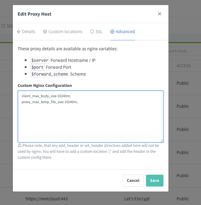

On 6/12/2022 at 1:57 PM, Rayce185 said:
Did anyone find a solution to this? It doesn't seem that anyone has answered/fixed this...
I'm using the dockers cloudflare ddns, mariadb, swag, and obviously nextcloud.
/etc/php/php.ini setting "memory_limit = 2G" didn't help
/appdata/nextcloud/www/nextcloud/.htaccess setting this didn't help either:
# PHP 7.x
<IfModule mod_php7.c>
  php_value mbstring.func_overload 0
  php_value default_charset 'UTF-8'
  php_value output_buffering 0
  php_value memory_limit 2G
  php_value upload_max_filesize 16G
  php_value post_max_size 16G
  php_value max_input_time 3600
  php_value max_execution_time 3600
  <IfModule mod_env.c>
    SetEnv htaccessWorking true
  </IfModule>
</IfModule>
# PHP 8+
<IfModule mod_php.c>
  </IfModule>
</IfModule>
This didn't help either:
/appdata/swag/nginx/proxy-confs/nextcloud.subdomain.conf "proxy_max_temp_file_size 2048m;"
I'm going out of ideas to fix this and can't find any other place to  check. Is there something in Cloudflare that I must set up differently?
I think I have been having the same issue as you with large files not uploading. In my Nextcloud appdata folder I have a file called php-local.ini located in this directory, /mnt/user/appdata/nextcloud/php.
I edited the php-local.ini file and added the following lines.
memory_limit = 8G
upload_max_filesize = 16G
This would allow the large file I wanted to add to start the upload process, however, it failed with a 413 error. This was due to a web server error. This got me looking through the appdata folder again and I eventually ended up in the Nextcloud nginx, specifically in this folder /mnt/user/appdata/nextcloud/nginx/site-confs. Looking in the file called default.conf I had to edit one line to look like this
client_max_body_size 10240M;
This increased the max file size the web server would accept to 10GB (10240MB).
After another restart of the Nextcloud docker the file started to upload again, but this time there was a timeout error. I went back into  /mnt/user/appdata/nextcloud/php so that I could edit php-local.ini again. I increased the input time to 600s (10 minutes) and the execution time to 3600s (1 hour). The contents of this file now looked as follows
date.timezone = Europe/London # this is my timezone, I am not sure if I added this are it was done on during docker creation
memory_limit = 8G
post_max_size = 16G
max_execution_time = 3600
max_input_time = 600
After another restart of the Nextcloud docker the 4GB file I wanted to add to Nextcloud synced without issue.
In summary my changes were as follows
1) Edit this file, /mnt/user/appdata/nextcloud/php/php-local.ini
2) Edit what was there and add additional lines so that it looked like this
memory_limit = 8G
post_max_size = 16G
3) Edit this file /mnt/user/appdata/nextcloud/nginx/site-confs/default.conf
4) Find client_max_body_size and edit the value as below
Locally on my network I use Network Proxy Manager to handle SSL certificates. In the advanced section for my Nextcloud SSL I added the following lines
client_max_body_size 10240m;
proxy_max_temp_file_size 10240m;
I am not sure if they were needed but at some point during my testing I added them. This was before I had changed the client_max_body_size in default.conf, so I am not sure if they made any difference. I just thought it best to include this information as it could be another point of failure for the upload.
I hope this helps you fix the issue you are having.
