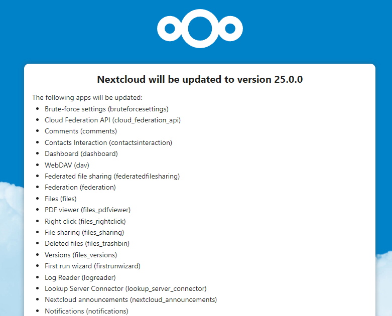

When loading the nextcloud webui I keep getting this message - i've tried to downgrade the installation of nextcloud to a lesser version, but nothing works.
I know the version installed is 25.0.18, shown below - so no idea why it's trying to downgrade to 25.0.0?
When clicking the download button at the bottom of page - or using occ upgrade - same error, which is:
Can't get this to go away.
Any help?

Same problem here, since updating Docker container and upgrading Nextcloud to 25.0.0, getting 504 error whenever I want to access a file...
Tried to rolled back to the older repo version but that doesn't work.
What would be the best thing to do? Migrate both mariadb and Nextcloud to the official Docker repos instead of Linuxserver? Is there an easy way to do this?
