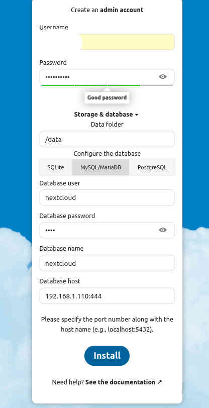

Newbie here:
followed spaceinvaders recent tutorial to the letter.
Mariadb runs and no errors in log, same for nextcloud.
My problem is when setting up the admin account and database from the web interface i get an nginx 504 Gateway Time-out.
Any help would be appreciated, my command line knowledge is poor so go easy THX
im a little furter along now using
192.168.1.110:3306 with the following error
Error while trying to create admin user: Failed to connect to the database: An exception occurred in the driver: SQLSTATE[HY000] [1045] Access denied for user 'nextcloud'@'172.17.0.1' (using password: YES)
Create an admin account
make sure you created a user "nextcloud" in your DB with the same password you're specifying here.
Ill give it a go thanks.
