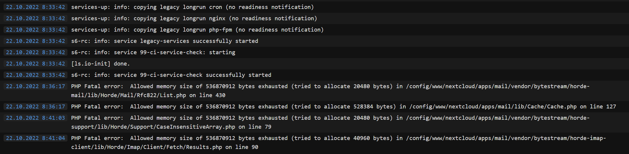

PHP Fatal error: Allowed memory size of 536870912 bytes exhausted (tried to allocate 20480 bytes) in /config/www/nextcloud/apps/mail/vendor/bytestream/horde-mail/lib/Horde/Mail/Rfc822/List.php on line 430

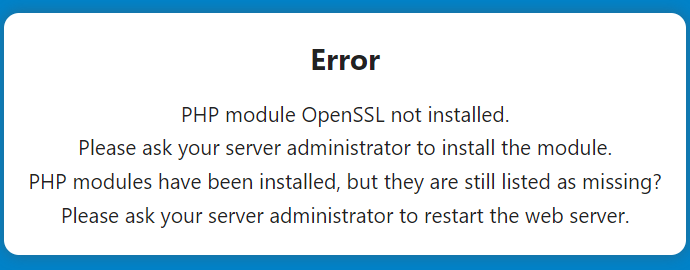

Same issue here:
This version of Nextcloud is not compatible with > PHP 7.4.
You are currently running 8.0.18.

This version of Nextcloud requires at least PHP 7.2
You are currently running 7.1.17. Please update your PHP version.

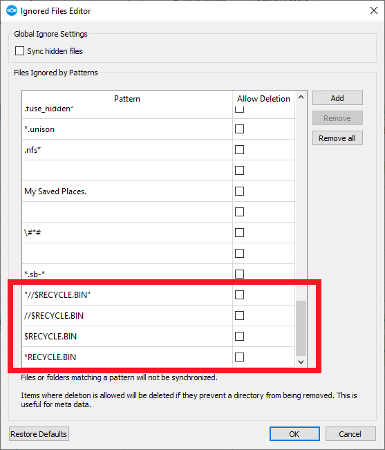

Hi Guys
I have finally got round to setting up a fresh NextCloud server after my last instance failed catastrophically.
Anyway, I am syncing a data drive on my work PC and all seems to be working except I am getting one annoying warning message which I don't seem to be able to fix. I have searched on numerous NextCloud forums and can see others have the same issue, but as yet no way of fixing it - so I am hoping someone here can help.
On the Windows desktop client (3.6.1) I get an error stating "Some files could not be synced!"...
Obviously I dont want the RECYCLE.BIN from my PC to be synced... so I tried adding "//$RECYCLE.BIN", plus every variant which I thought may work, to the global ignore list;
But it still keeps showing this error - has anyone else seen this, or have any ideas how to fix it?
Many thanks
Edited by SliMat
You are currently running 7.1.17. Please update your PHP version. 😭
