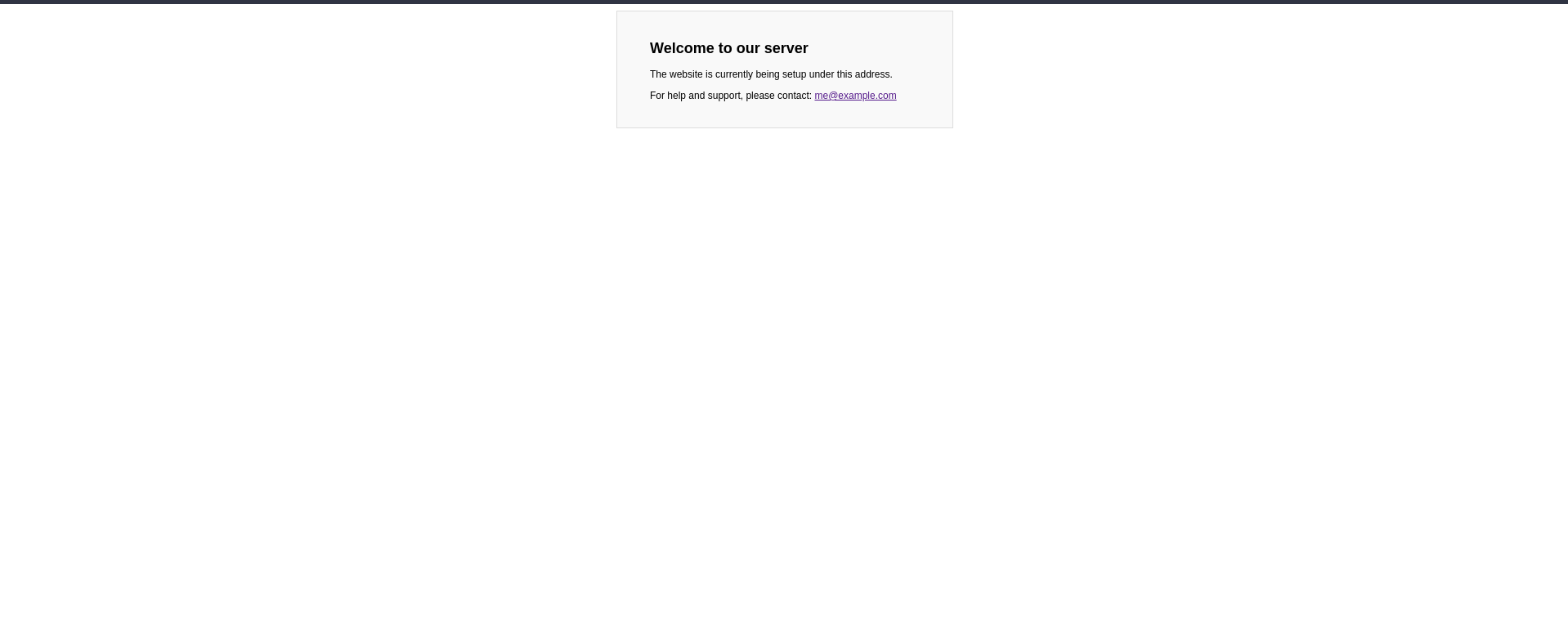

Hello All,
I a couple of days ago I updated the nextcloud docker and now the site is stuck at a Welcome to Our Server screen. I've been trying to troubleshoot myself, but have not found a solution. I did not change anything so I don't know what happened. There is nothing in the logs for nextcloud or swag that gives me a clue as to what the problem is. I updated nextcloud using the update command docker exec -it nextcloud updater.phar to the latest version 24.0.5 thinking that would fix it, but still nothing. I saw there was another docker update today and I ran that, but still the same Welcome to Our server message. Anyone know how to fix this?
Edited by Ben4
4 hours ago, Ben4 said:
Hello All,
It's probably because of swag container. You have to add the .conf extension to your configuration files now. It wasn't the case before.
Have a look at the logs of nextcloud and swag.
@andreidelait
Thank you. Once I added the .conf to my nextcloud config file my site came up. Much appreciated. Do you mind sharing the link with the documentation of this change.
10 minutes ago, Ben4 said:
@andreidelait
I remember mine specified this in the docker log.
I don't have the exact documentation but I guess this is related:
https://info.linuxserver.io/issues/2022-08-20-nginx-base/
