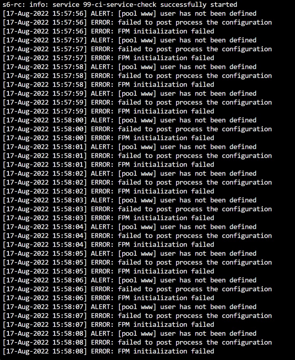

Recently had to reboot my server, but now Nextcloud won't fully start and keeps spitting the following out to the docker log. What's this pool that must be defined?
[11-Aug-2022 17:09:20] ERROR: FPM initialization failed
[11-Aug-2022 17:09:21] ERROR: No pool defined. at least one pool section must be specified in config file
[11-Aug-2022 17:09:21] ERROR: failed to post process the configuration
[11-Aug-2022 17:09:21] ERROR: FPM initialization failed
[11-Aug-2022 17:09:22] ERROR: No pool defined. at least one pool section must be specified in config file
[11-Aug-2022 17:09:22] ERROR: failed to post process the configuration
[11-Aug-2022 17:09:22] ERROR: FPM initialization failed
[11-Aug-2022 17:09:23] ERROR: No pool defined. at least one pool section must be specified in config file
[11-Aug-2022 17:09:23] ERROR: failed to post process the configuration
[11-Aug-2022 17:09:23] ERROR: FPM initialization failed
Apparently I just had to keep restarting my container until it stuck, as it's working now.

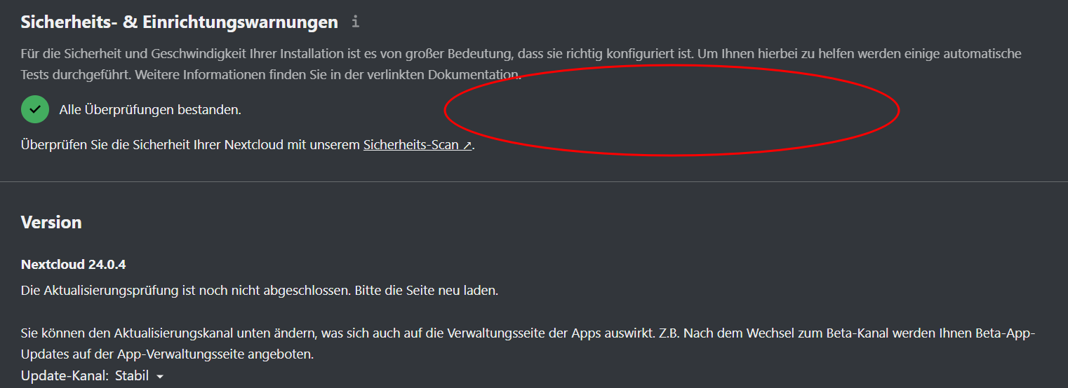

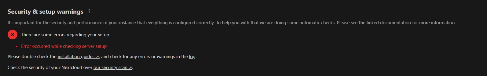

Update
I've updated to NC24 recently, but since then the Security Check or Code Integrity Check always returns 'Error occurred while checking server setup'. If I look in the logs there are no errors and/or warnings. I was wondering is there someone out there with the same problem, or perhaps had the same problem in the past and knows the solution for it?
usually on major updates the needed changes are described here, most common some occ database update lines todo ...
Thanks for you reply, I was hoping that some occ commands was going to be the solution for this. But all it shows is this:
And a log full with Debug notifications, would a reinstall be recommended?
hmm, thats really odd ... sorry, then its really log searching or may start at the NC Forums to get some hints where to look for ...
In Basic Settings do you have background jobs reported as working normally? Sometimes this can cause issues...

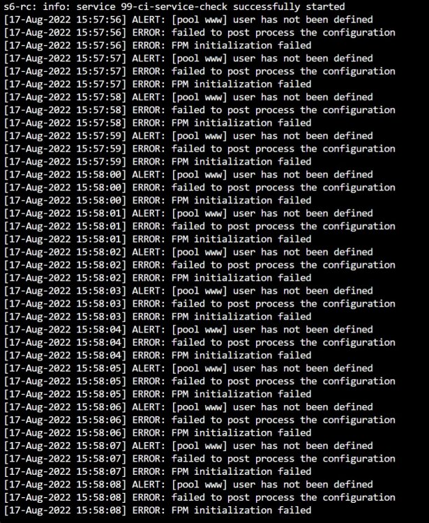

Heres a fun thing my Nextcloud is doing now whenever I try to run it. Does anyone know what might have happened?
Well as it turns out I just have no idea what I am doing :D Slowly learning...

Tried updating Nextcloud. I am stuck at level 6 and not proceeding.
Log is as follows:
cont-init: info: running /etc/cont-init.d/99-custom-files
cont-init: info: /etc/cont-init.d/99-custom-files exited 0
s6-rc: info: service legacy-cont-init successfully started
s6-rc: info: service init-mods: starting
s6-rc: info: service init-mods successfully started
s6-rc: info: service init-mods-package-install: starting
s6-rc: info: service init-mods-package-install successfully started
s6-rc: info: service init-mods-end: starting
s6-rc: info: service init-mods-end successfully started
s6-rc: info: service init-services: starting
s6-rc: info: service init-services successfully started
s6-rc: info: service legacy-services: starting
services-up: info: copying legacy longrun cron (no readiness notification)
services-up: info: copying legacy longrun nginx (no readiness notification)
services-up: info: copying legacy longrun php-fpm (no readiness notification)
s6-rc: info: service legacy-services successfully started
s6-rc: info: service 99-ci-service-check: starting
s6-rc: info: service 99-ci-service-check successfully started
[custom-init] no custom files found exiting...
[ls.io-init] done.
Could not open input file: /config/www/nextcloud/cron.php
Any ideas on how to proceed?
Thank you.
