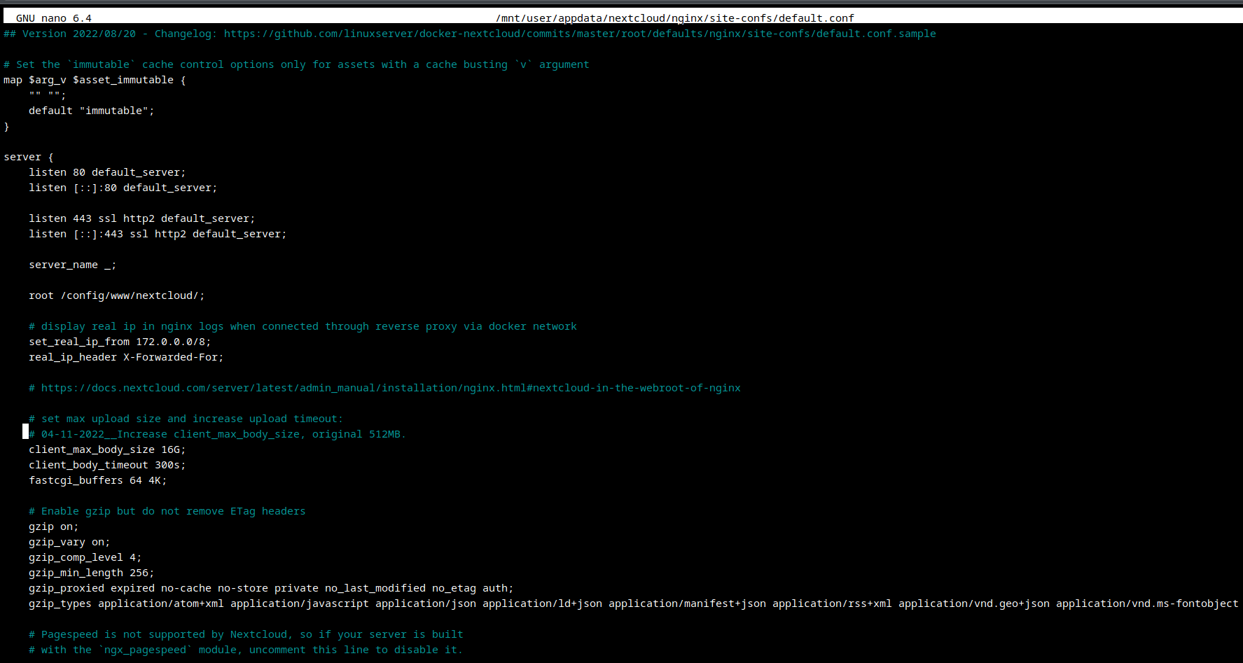

On 11/4/2022 at 1:58 PM, mrdavvv said:
Hello guys!
Im having a lot of trouble with the syncing of big archives in Nextcloud. It seems like its a common problem, but i have tried a lot of proposed solutions in the web, with no avail.
Setup:
Unraid 6.11.1
Nextcloud Server: Latest LSIO Docker V25, Maria DB LSIO Container.
Nextcloud Client: Latest APPImage 3.6.1 (Kubuntu Linux 20.04)
Problem:
  • Nextcloud client in desktop gives the error " 413 Request entity too large", in all my files bigger than around 500MB.
  • Web client / Android with no issues.
Attempted Solutions:
nano /mnt/user/appdata/nextcloud/nginx/nginx.conf
# Original:
    client_max_body_size 0;
#Test 1:
    client_max_body_size 16G;
#Test 2:
    client_body_buffer_size 400m;
nano nano /mnt/user/appdata/nextcloud/php/php-local.ini
post_max_size = 10G
upload_max_filesize = 10G
post_max_size = 10G
max_input_time = 3600
max_execution_time = 3600
memory_limit = 1024M
Restarting the docker service between al the testing.
appreciate any help!
Solution:
Aparently the Nextcloud LSIO image uses this addres for nginx config's:
nano /mnt/user/appdata/nextcloud/nginx/site-confs/default.conf
Instead of: nano /mnt/user/appdata/nextcloud/nginx/nginx.conf
So just adjusted this line in the former and it worked:
    # 04-11-2022_Increase client_max_body_size, original 512MB.
After restarting the instance, NX keep insisting on the 413 error. I tried renaming the files, as it has worked for me before. After renaming some files, NX just "unfreezed" and starting uploading my big files. Finally!

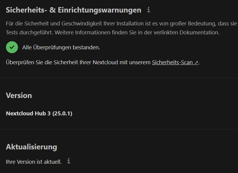

On 11/5/2022 at 9:08 AM, blaine07 said:
I am almost afraid to ask...
Is there anyone on 25.0.1 without issue and doing good?
I'm on 25.01 no issues that I have found, the default to a dark theme, my eyes can't handle that so i switch back but other than that. Seems to work fine as frog hair.
Edited by ijuarez
Ok, so here is an update folks. After going through all the steps I outlined in my previous post I managed to get my Nextcloud container updated to version 24, and now the linuxserver nexcloud container  works fine without any PHP errors 😁
Thanks Ccheese4 for pointing me in the right direction!
I moved a test instance(w/ PostgreSQL) to 25.0.1 after you said this yesterday and it does indeed seem to be going fine! Thank you!
On 11/7/2022 at 2:08 PM, mrdavvv said:
Solution:
Could you explain where you changed these lines for the nginx config?
There are so many files, that I don't know where to look.
I tried copying the files to the right location and renaming it, but then it just started giving errors.
So I hope adjusting the path will help

Hi, I'm sure this is something simple I am overlooking.
I'm trying to update to Nextcloud 25, but in the Web UI > Settings it says I am on 24.0.7 and that it is the latest version. There is no option to upgrade to 25.
Thank you
It seems, that the web update doesn't recognize the possible update correct.
I went over from web update to cli update.
Open a console for your nextcloud container there you can use this
root@f471a5390c23:/# cd /config/www/nextcloud/updater/
root@f471a5390c23:/config/www/nextcloud/updater# sudo -u abc php updater.phar
Nextcloud Updater - version: v25.0.0beta3-17-gef6cf2d
Current version is 25.0.1.
No update available.
Nothing to do.
This a capture from my file:
