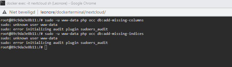

Hi All,
I have been looking around, but can't find a topic about this...
I have been using my nextcloud for about 2 years now, without any issues, until someone wanted to download some files >2GB and got a timeout. I always updated the docker of Nextcloud (and the others), but never realized I could update nextcloud itself from the settings, so I just updated a bunch of times from version 21.0.1 I think and am currently on 25.0.1 (talk about an upgrade) ;-).
So all went well and as far as I can tell, the files and everything is still there. I had an error about mailbox not being connected, but that is sorted now. However, I have a list of warnings and can't seem to find a post about these issues or how to solve them :
Missing index "fs_size" in table "oc_filecache".
Missing index "fs_id_storage_size" in table "oc_filecache".
Missing index "fs_storage_path_prefix" in table "oc_filecache".
Missing index "properties_pathonly_index" in table "oc_properties".
Missing index "job_lastcheck_reserved" in table "oc_jobs".
Missing index "direct_edit_timestamp" in table "oc_direct_edit".
Missing index "preferences_app_key" in table "oc_preferences".
I was hoping that in doing this update, the download error (Gateway error), might be fixed too?
As almost everyone, I followed the installation of SpaceInvaderOne for initial setup and have mariadb, Swag and duckdns dockers running and all are up-to-date (I usually keep my dockers up-to-date when a new version comes out).
Any help will be greatly appreciated!
Thanks a lot,
DrBobke
20 hours ago, Kilrah said:
Thanks a lot for that, but the link you provided only has a few examples of things one might do, but it doesn't have anything to do with the errors I see...?
Also looked up this article: https://docs.nextcloud.com/server/latest/admin_manual/configuration_server/occ_command.html
But I don't even have a clue where to start.
From your article, I input the "$ sudo -u www-data php occ db:add-missing-columns" to test in Unraid webterminal, but I get "command not found".  I am handy with computers and stuff, but this kind of thing is not my cup of tea, it would be handy if it was written where I actually have to go and input which commands?
Do I have to change something in the Nextcloud docker settings?
Or is it in Nextcloud webui itself in the settings?
Or is it in unraid?
Or is it in a folder of nextcloud on unraid?
Any help is greatly appreciated, as this is a little out of my comfort zone.
Thanks, DrBobke

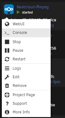

In the container's console
Thanks a lot for that, that really helps!
But which commands do I have to input there? The ones in the article you mentioned are examples to fix other things?
The ones stated as examples, don't work for me:
The '$' isn't part of the command

1 hour ago, DrBobke said:
Thanks a lot, but the others don't work either :
I know I read smth about the user www-data that that is the admin user or smth like that, but how can I log into that? All docker settings are set correctly as far as I'm aware...
The commands in nextcloud docs refer to a standard/official install, they may need to be adapted to the way a given 3rd-party install/container is implemented.
linuxserver uses 'abc' as the user for their containers, and the location the app is stored in is different as well, so you need to modify the commands accordingly, e.g.
sudo -u abc /config/www/nextcloud/occ db:add-missing-indices
