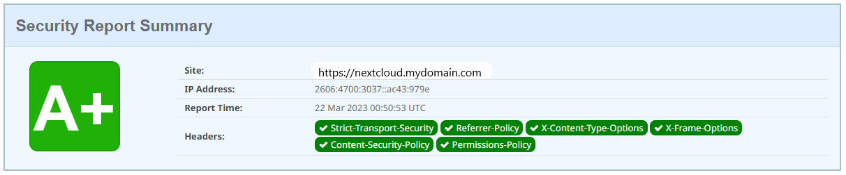

currently sitting on A+ here, no errors 👨‍💻
Edited by Tolete
13 minutes ago, Tolete said:
please post your
# HTTP response headers borrowed from Nextcloud `.htaccess`
section from your default.conf file.
Where did you run that test at?

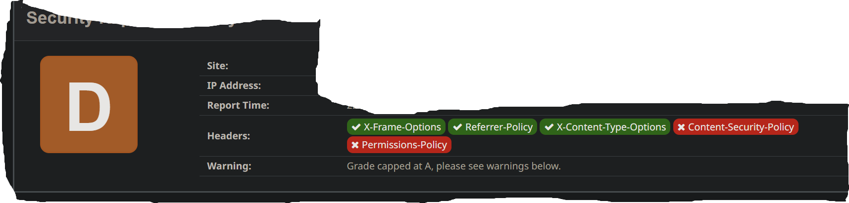

2 minutes ago, Tolete said:
Interesting. The best I can get is a A but “permissions-policy” i’m missing.
I wonder if permissions policy was fixed/added in 26 or?
not NC version related, you are just missing it.
4 minutes ago, blaine07 said:
How do I add it or? Reverse proxy or?
all I could find: https://github.com/nextcloud/server/issues/22792
post your
9 hours ago, darcon said:
It's fixed for me with the new docker image
Yes fixed with lasted image
@Tolete @blaine07 are you using a copy of default.conf.sample in your default.conf ?
becose i have some old version not equal to default.conf.sample , i can just copy it to default.conf ?
10 hours ago, Tolete said:
post your
This:
    add_header Referrer-Policy                      "no-referrer"       always;
    add_header X-Content-Type-Options               "nosniff"           always;
    add_header X-Download-Options                   "noopen"            always;
    add_header X-Frame-Options                      "SAMEORIGIN"        always;
    add_header X-Permitted-Cross-Domain-Policies    "none"              always;
    add_header X-Robots-Tag                         "none"              always;
    add_header X-XSS-Protection                     "1; mode=block"     always;
It looks a update was pushed out by Linuxserver mere hours ago that updates this file again; I wonder what changes were this time.
EDIT: changes pushed our hours ago turned the Robots tag stuff back to be correct for NC 26 it appears: https://github.com/linuxserver/docker-nextcloud/commit/c1568bac547f6f660849487ed7e443520417a1b7
Edited by blaine07
