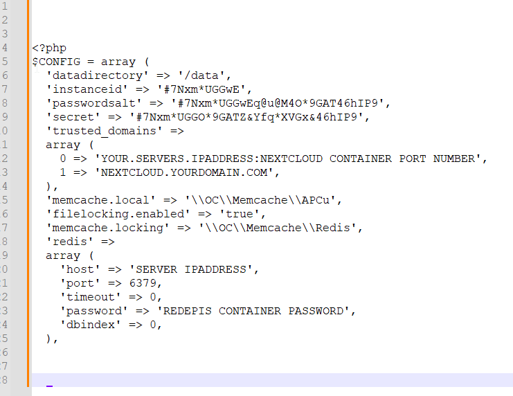

The error message "Cannot declare class OC\Memcache\Redis, because the name is already in use" suggests that the Redis class has already been declared, and attempting to declare it again is causing a fatal error.
I would check your Nextcloud config file for code related to Redis/Memcache | Nextcloud documentation on Memcache.
your config should look something like this.
Edited by Tolete
config added

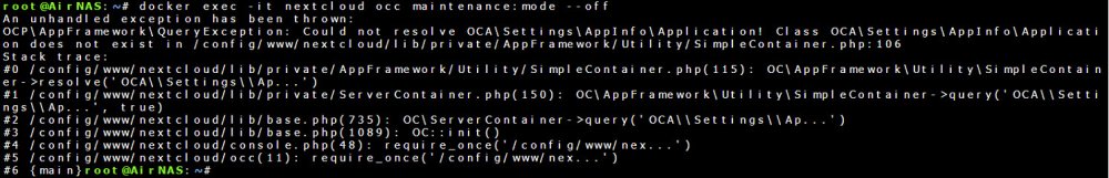

Last night I was updating dockers and my next cloud installation.  First shut down the NextCloud docker, updated Maria, then updated NextCloud, turned the docker back on.
Went to the admin page and ran the update to go from v25 to 26, but its stuck on step 3.  I saw other solutions about removing the updater files, but I don't see any of those.
Updating from command line gives me the same please wait message.
NextCloud is not in maintenance mode.

I'm trying to edit the config.php file to include "'filesystem_check_changes' => 1,". I go into the console for the "nextcloud-aio-nextcloud" container and cd my way to the config folder, and the config.php file is there. I can't figure out how to edit the file. Also, where in the world is that file located on my unraid server? I've tried to find it using krusader but no luck.
The biggest draw back to AIO on unraid is that i can't find any of these types of files anywhere! I just need help editing that config.php file so the system will check for new files. I've also tried using the OCC command but get errors using it.
I can use "cat config.php" and it displays the file, but from there can't seem to make any edits. If i "nano config.php" i get "nano not found." I've tried just about every command out there and can't find a way to edit that file. Please help!
Side note: If there's a way to browse these files with krusader i'd love to know how! I'm not sure why these files are impossible to find on Unraid?
edit: if i open a console to the nextcloud-aio-nextcloud container and enter 'sudo -u www-data php occ files:scan" i get "Fatal error: Allowed memory size of 2097152 bytes exhausted (tried to allocate 491520 bytes) in /var/www/html/3rdparty/composer/autoload_real.php on line 35"

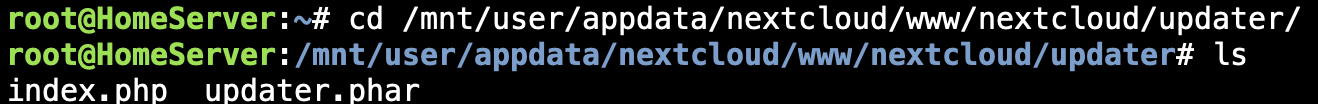

The other option is to upgrade via the command line within the docker shell.
sudo -u abc php /config/www/nextcloud/updater/updater.phar
occ upgrade

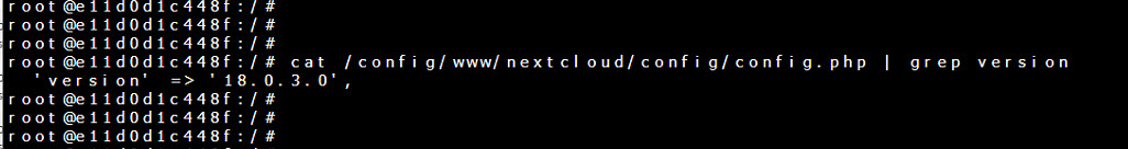

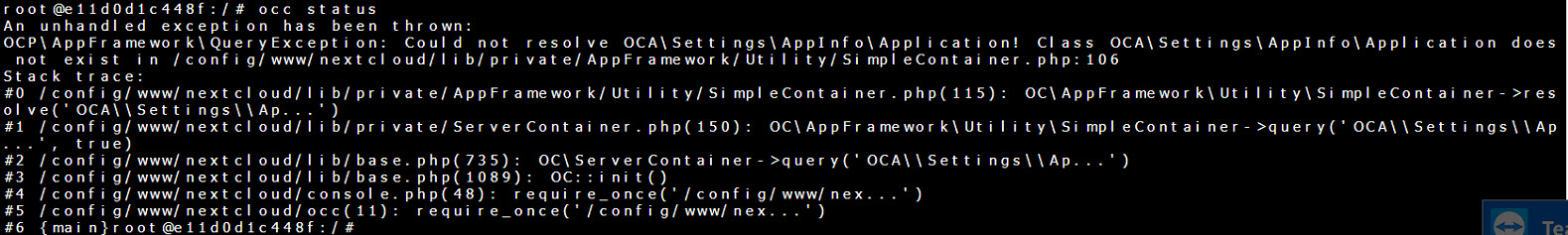

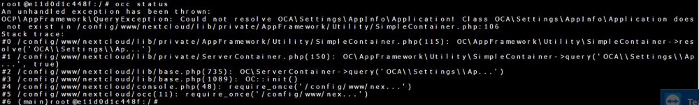

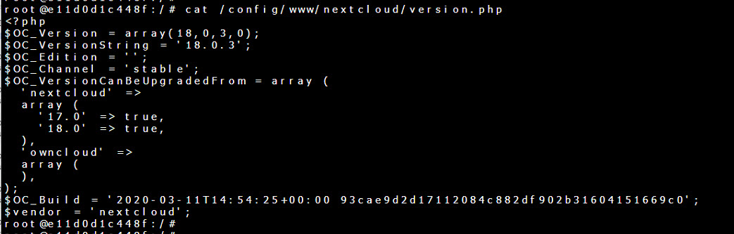

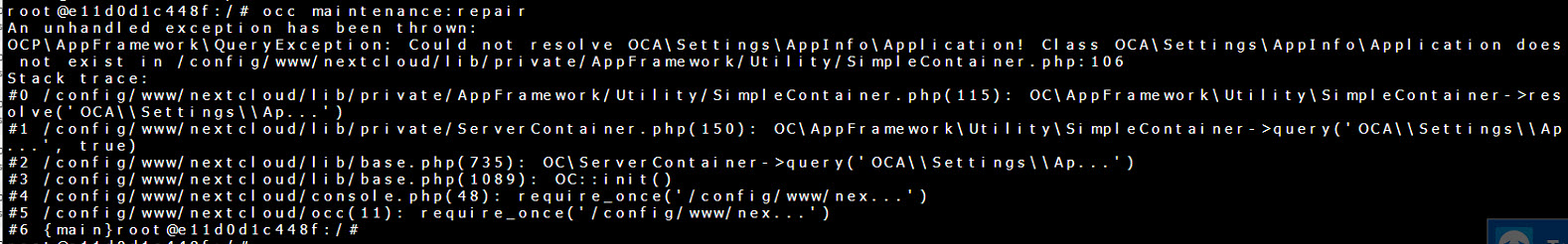

Yes, I only use NextCloud for file storage. It is harder than I thought. "_"
Great so you're config and version files both seem to be in sync with version 18.0.3 so that's a good start.
I think your upgrade then downgrade of the docker has introduced this PHP issue.
You must be on a version (I think you said 7.4.33) that is not compatible with 18.0.3.
According to the PHP release history, 7.4.33 was the last 7.4 release and came out in Nov 2022.
It is probably too new for NC 18.0.3 which is from years earlier.
You could try downgrading to 18.0.3-ls76 which is the linuxserver.io version for NC 18.0.3 but I don't know if that specifies an older PHP as well or if it will just pull the latest. But it's worth a shot.
