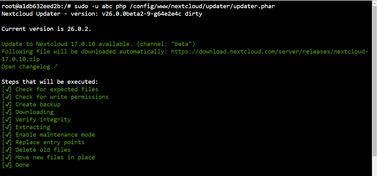

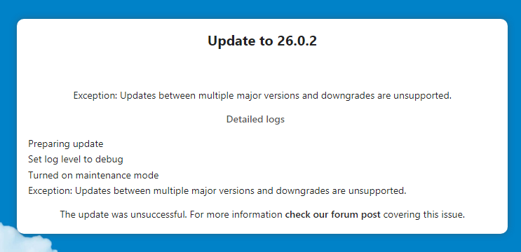

I get something similar to @johnwhicker, except mine is telling me the next update is Nextcloud 17.0.10, and my channel is beta. IT says my current version is 26.0.2, but even in the GUI its asking me to update, which fails giving the same error about updates/downgrades between major versions not supported. Not sure what went wrong and I've been at it for almost two days.  Any help would be greatly appreciated.

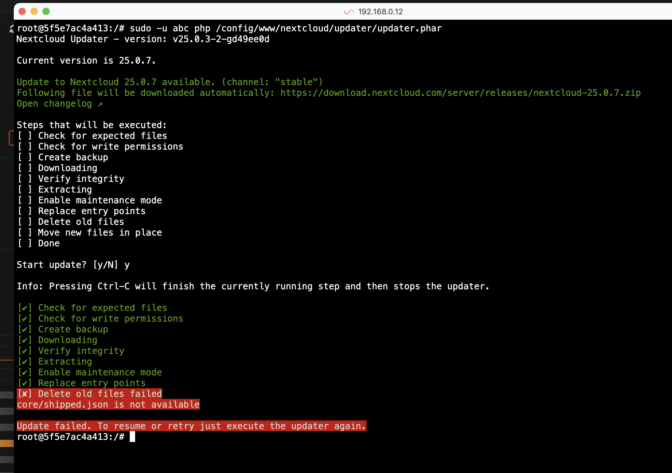

I could really use some help here. I'm banging my head against the wall trying to fix this issue. I attempted to update nextcloud using the web gui (i know, my first mistake)
It failed on Step 7. I have tried multiple times to get past it, and nothing I do seems to work. I can no longer get into nextcloud as it's hung at the "update in process" page. Does anyone have any clue where to go from here?
Error I'm getting:
[✘] Delete old files failed
core/shipped.json is not available
Update failed. To resume or retry just execute the updater again
I found other threads where people mentioned just creating the file.. but the file already exists within the /var/www/nextcloud/core directory
EDIT: Had an appdata backup from yesterday, just went ahead and restored it to get nextcloud working again. Going to leave it for today and try the upgrade again tomorrow using the recommended steps outlined in the first post.
