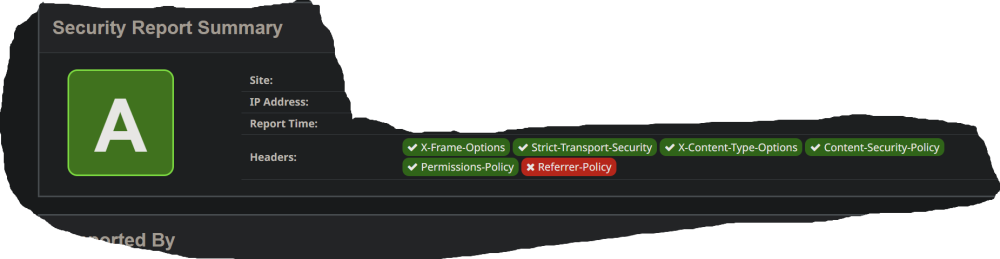

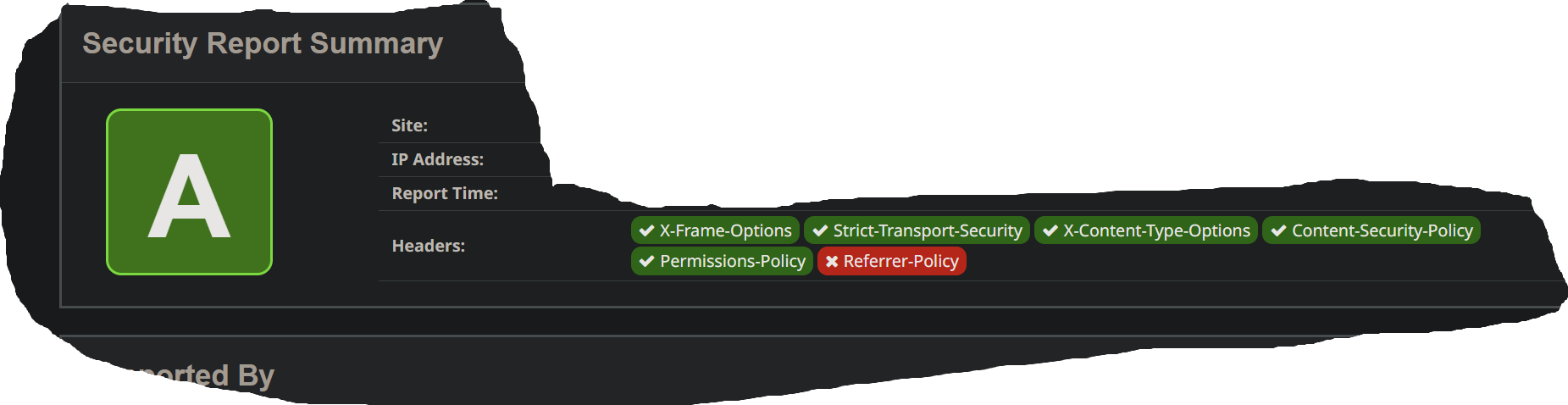

5 hours ago, Masterwishx said:
@Tolete
After changed to container defaults /config/nginx/site-confs/default.conf.sample and nginx.conf.sample and updated Nextcloud to 26.0.1
i see no refferrer policy :
but it still present in file default.conf.:
and .htaccess :
Maybe you know where the problem ?
yup, its missing on Cloudflare side. add it to cloudflare and re-scan
OK, Thanks but it strange, before it was working without Cloudflare side

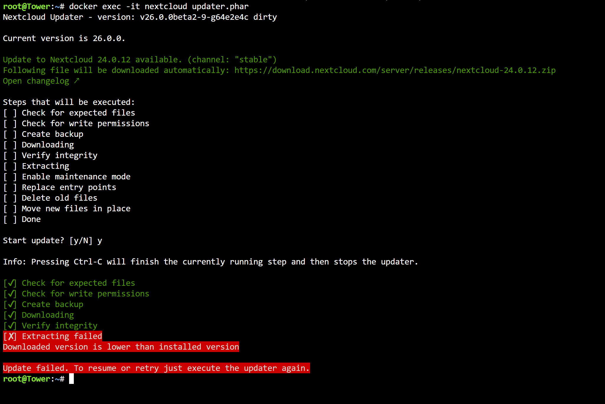

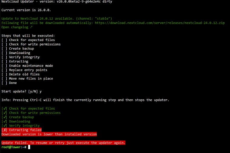

Yes, I tried this. But I always get stuck at
"Extracting failed"
I've tried all 3 different update steps on the first page aswell..

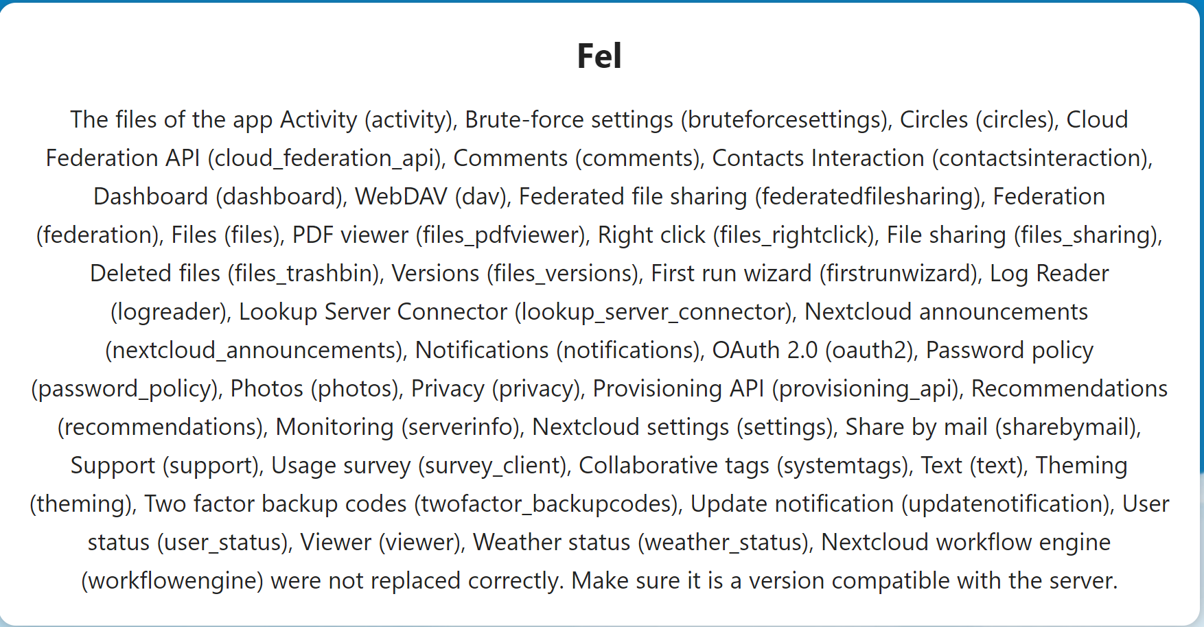

Looks like your install is in a limbo state where parts of things have been updated but not all (says it's running 26.0.0 but the update it offers is 24.0.12).
Not sure of how to go about fixing this, might need to manually extract the files from the distribution archive into appdata. Maybe someone else has a better solution.
Edited by Kilrah

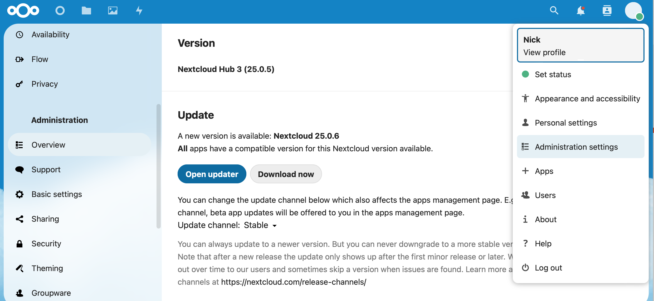

20 hours ago, gevsan said:
How do I upgrade the GUI?
This is taken from a post I did in Feb which was about the same issue of PHP and NextCould being out of sync...
Unlike most docker software, upgrading the docker does not upgrade NextCloud itself. NextCloud needs to be upgraded from within its own web interface. (Click on "administration settings" in your profile icon in the top right corner of your Home Screen. That should take you to the Administration Overview link in the left hand toolbar. Scroll down and you should see an Update heading. See the attached image.)
I suspect that you have not upgraded NextCloud in such a long time that the docker environment and the software are now too far out of sync to be compatible.
Probably the easiest fix would be to downgrade your docker. Then from the NextCloud web interface, you can upgrade to the latest and then upgrade the docker again.
You can manually set the repository from within the docker settings.
Try going back to the docker for 24.0.6 from a few months ago.
If you are using the docker from linuxserver.io then you can see all the available tags on their page.
Just edit the NextCloud docker un Unraid and change the repository line to read lscr.io/linuxserver/nextcloud:<tag> where <tag> is the version you want to roll back to. Once you are done, just set it back to "latest".

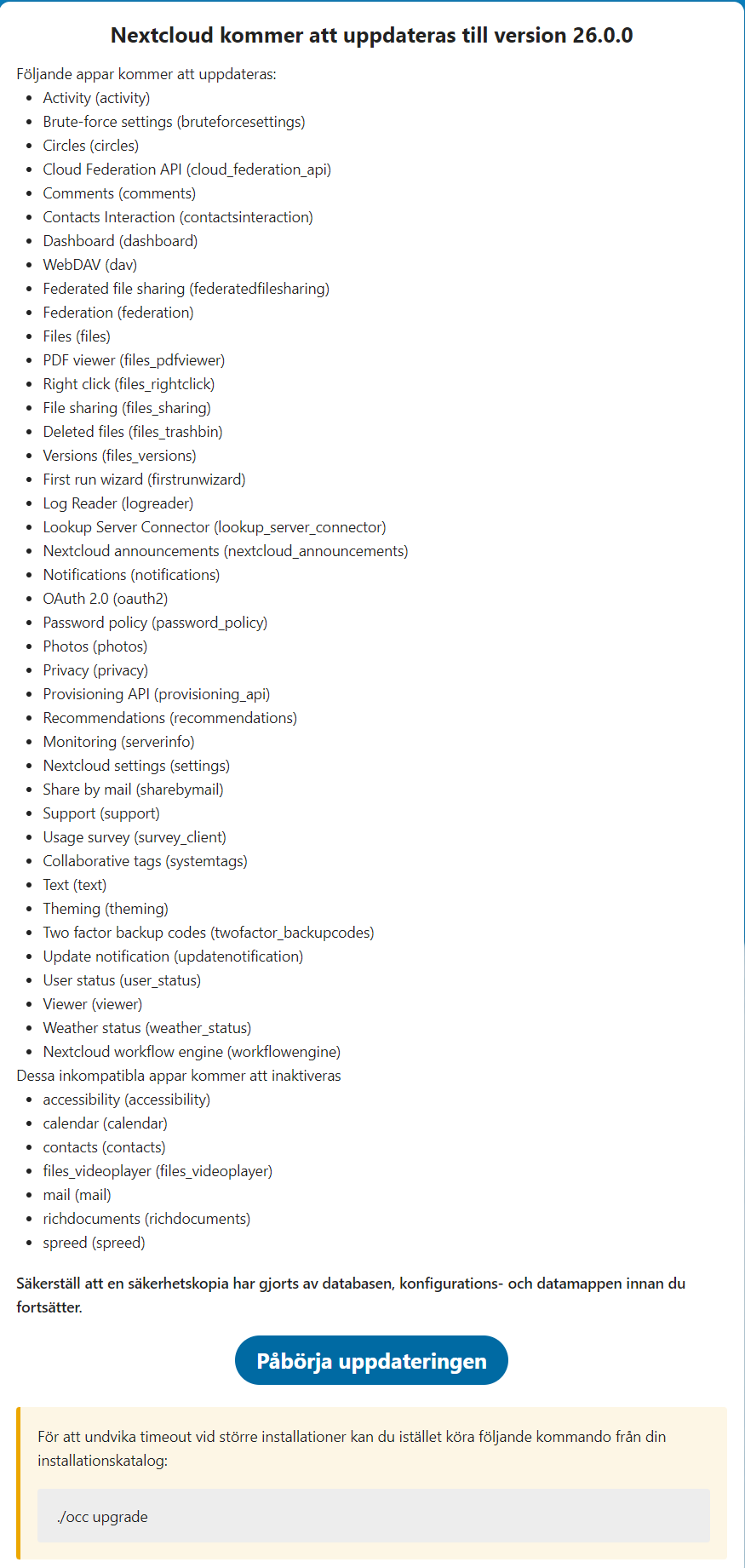

I see..
I changed to "lscr.io/linuxserver/nextcloud:latest"
Now when i acces nextcloud I'm getting this message
Edited by gevsan
That looks fine.
It's just warning you that it might timeout due to the size of the update.
I have found that can happen but you just re-run the update and it continues where it left off.
Just give it a try or you can perform the update from the command line which should work now that you have updated to docker.

The problem is that I don't know how to proceed from this message.. :D

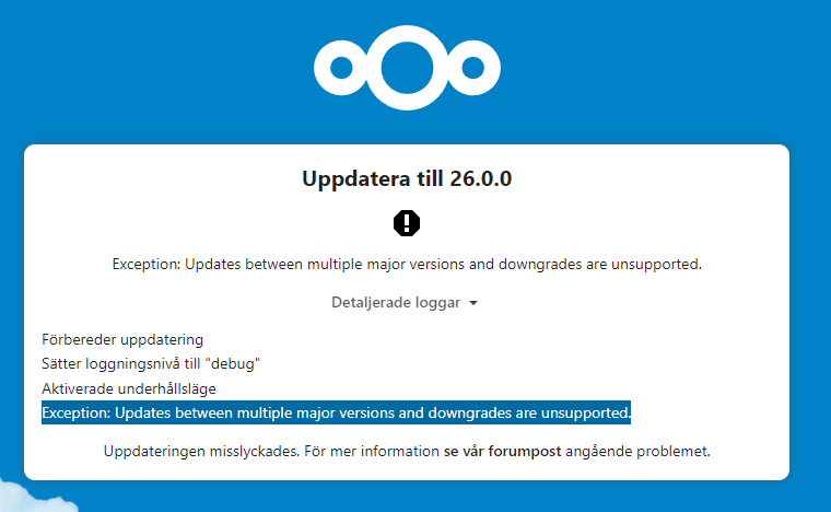

If i press "Start Upgrade" I will get this error, "Exception: Updates between multiple major versions and downgrades are unsupported."
Edited by gevsan
So I have not hit this myself but it looks like NextCloud is either trying to upgrade or downgrade in an unsupported way. It is normally only allowed to upgrade one major release at a time.
Eg if it is currently on 22.x.x then it can go to 23.x.x but not to 24.x.x or higher.
This usually happens when it gets confused because of a failed upgrade attempt in the passed so it thinks it is on a higher version than it actually is.
Eg it thinks it's on 25.x and wants to upgrade to 26.x but it actually is on 24.x
Check what version of NextCloud the GUI thinks it is on and what it wants to upgrade to.
This can be seen on the administration overview page (like I posted yesterday).
Then go into the docker shell and run the command "occ status". You should see something like;
root@1384826c6432:/# occ status
  - installed: true
  - version: 25.0.5.1
  - versionstring: 25.0.5
  - edition:
  - maintenance: false
  - needsDbUpgrade: false
  - productname: Nextcloud
  - extendedSupport: false
Then check what the version.php thinks;
root@1384826c6432:/# cat /config/www/nextcloud/version.php
<?php
$OC_Version = array(25,0,5,1);
$OC_VersionString = '25.0.5';
$OC_Edition = '';
$OC_Channel = 'stable';
$OC_VersionCanBeUpgradedFrom = array (
  'nextcloud' =>
  array (
    '24.0' => true,
    '25.0' => true,
  'owncloud' =>
  array (
    '10.11' => true,
$OC_Build = '2023-03-23T12:04:47+00:00 28add7e896b24fee2714b21a12151e4042ab677c';
$vendor = 'nextcloud';
Also check what version the config file thinks;
root@1384826c6432:/# cat /config/www/nextcloud/config/config.php | grep version
  'version' => '25.0.5.1',
All of these should be in agreement. I suspect that they are not because of a previous failed install.
I would guess that you are actually on 23.x or 24.x but the installer thinks you are on 25.x and it trying to take you straight to 26.0
You need to bring them all back so the system thinks it's on the correct version then it should be happy to upgrade and all going well, no further problems. Here is a blog that walks through the issue. Just keep in mind that since you are using the LinuxServer.io docker the path to the files above is slightly different than what is in the blog. Also it is possible depending on what version you are going from, you might need downgrade the docker by using a specific docker tag, but I wouldn't do that unless you hit a problem.
NextCloud have some nice instructions on the normal upgrade process if you want to get your head around it.

Unfortunately it wasn't that "easy" xD
Im now getting this message..
