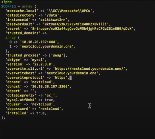

overwrite.cli.url will make NC rewrite the url with this regardless of how it's accessed.
@Kilrah how can I edit this config to use the IP when I'm home and WAN when away?
Just remove the overwrite.cli.url and overwritehost lines.
Edited by Kilrah

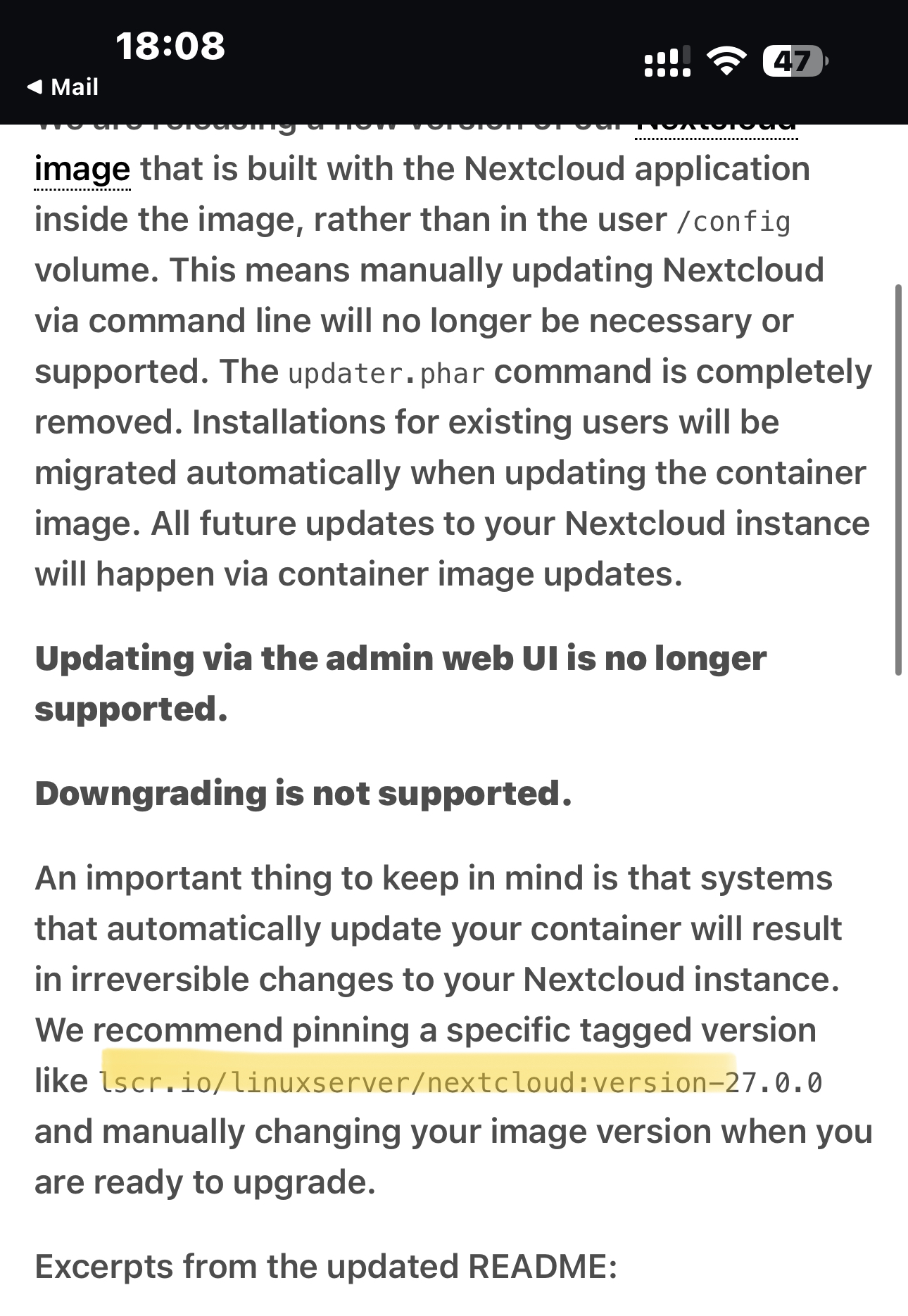

This is expected. Please read https://info.linuxserver.io/issues/2023-06-25-nextcloud/
tldr; no more manual updates
Oh wow, this is a big deal. I don’t see a tag for 27 that I’m on… I’m just on “latest”m

49 minutes ago, iXNyNe said:
As for the core files, it actually looks like those are no longer in a user accessible location, but you could recreate the image and those should be fixed. The easiest way to recreate the image it switch the image to lscr.io/linuxserver/nextcloud:version-27.0.0 and then back to lscr.io/linuxserver/nextcloud
For my own curiosity sake why would he change image to “…/nextcloud:version-27.0.0” and then back down to “…/nextcloud”
I am on Nextcloud 27; is it fine to just leave myself locked to “…/nextcloud:version-27.0.0” or after the upgrade are we supposed to change back to “…/nextcloud”?

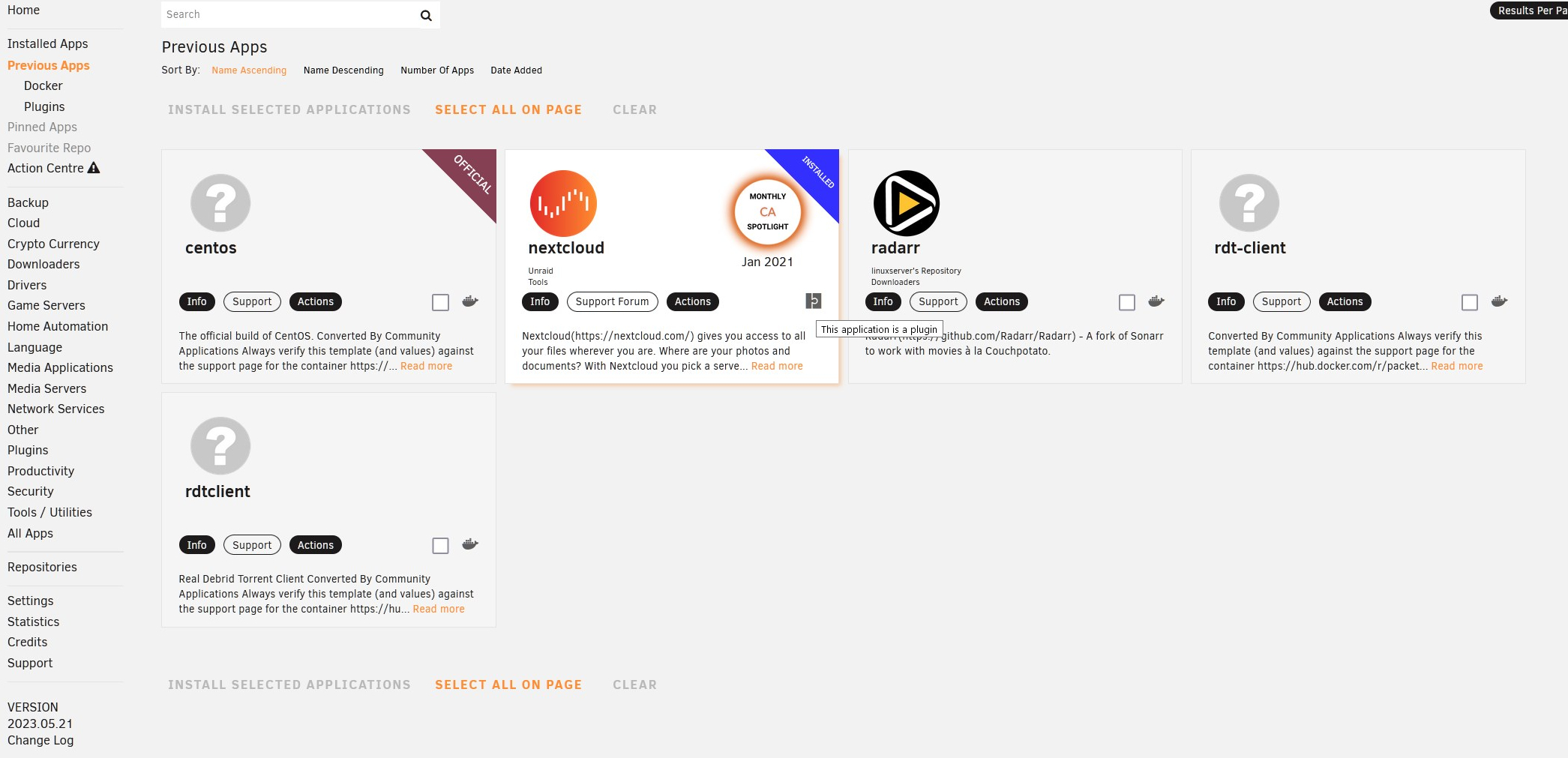

UPDATE TO THIS POST :
Under previous app its showing as plugin.
someone pls help.
Changing the image forces docker to recreate (not just restart) the container. That's the trick to solve some problems, such as the core files inside the container (they would not exist if you recreate the container).

The major version (the first number in the version before the decimal) is all that you need to worry about. Using
lscr.io/linuxserver/nextcloud:version-25.0.4 should be fine, even if your install is 25.0.3 or 25.0.0
The key thing you missed in the tag is the prefix: version-
It should have all the info you need. If you still have issues feel free to reply here, or message on the LSIO discord (response time might be faster there).
