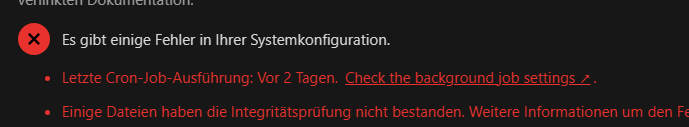

hi, just updated to 27.0.0
i do get a message in nextcloud
`Some files have not passed the integrity check. Further information on how to resolve this issue can be found in the documentation ↗. (List of invalid files… / Rescan…)` pressing rescan does nothing, any fix for this ?
Link to comment
The integrity check message shouldn't cause any functional issue and should be resolved in the next release. If you're interested in testing the fix before it is fully released see my message above.
Edited by iXNyNe
Link to comment
The latest test image is
lspipepr/nextcloud:27.0.0-pkg-34240624-dev-d151fd013f86933409d88dbdd26222232842031f-pr-325
It has a bunch of small fixes and tweaks, among them the integrity check extra files should be resolved.
Shouldn't be long before this is released as lscr.io/linuxserver/nextcloud:latest for those who would like to wait.

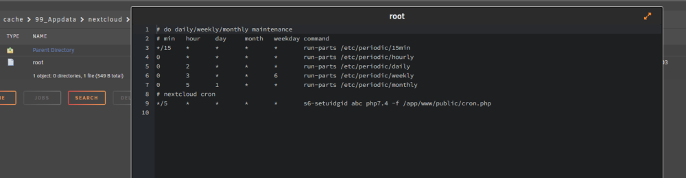

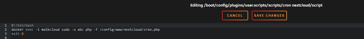

5 hours ago, maikki said:
Hi
I have still another issue. The cronjob doesn't work anymore.
The file is not more available. How i can fix this?
Thank and greez mAik
The container comes with its own cron, you shouldn't need a user script. If you look in /config/crontabs/ there should be a file called root, and I'm guessing it has an incorrect path in it. You can delete the file and restart the container and it will recreate the file with the correct path.
  • Thanks 1
Thx for help..
I deletet the file and restart the cotainer.. The file was new create but the issue is the same. (Uptime Container 10min)
s6-applyuidgid: fatal: unable to exec php7.4: No such file or directory
cp: not replacing '/config/crontabs/root'
[migrations] started
[migrations] 01-nginx-site-confs-default: skipped
[migrations] 02-default-location: skipped
[migrations] done
usermod: no changes
   Brought to you by linuxserver.io
To support LSIO projects visit:
https://www.linuxserver.io/donate/
GID/UID
User UID:    99
User GID:    100
using keys found in /config/keys
# do daily/weekly/monthly maintenance
# min   hour    day     month   weekday command
*/15    *       *       *       *       run-parts /etc/periodic/15min
0       *       *       *       *       run-parts /etc/periodic/hourly
0       2       *       *       *       run-parts /etc/periodic/daily
0       3       *       *       6       run-parts /etc/periodic/weekly
0       5       1       *       *       run-parts /etc/periodic/monthly
# nextcloud cron
*/5     *       *       *       *       s6-setuidgid abc php7.4 -f /app/www/public/cron.php
**** The following active confs have different version dates than the samples that are shipped. ****
**** This may be due to user customization or an update to the samples. ****
**** You should compare the following files to the samples in the same folder and update them. ****
**** Use the link at the top of the file to view the changelog. ****
│  old date  │  new date  │ path                                                                   │
│ 2021-10-24 │ 2023-04-13 │ /config/nginx/nginx.conf                                               │
│            │ 2023-06-23 │ /config/nginx/site-confs/default.conf                                  │
[custom-init] No custom files found, skipping...
[ls.io-init] done.
Edited by maikki
Containerlog
Link to comment

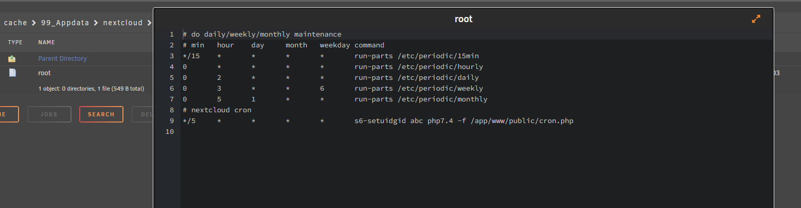

1 hour ago, maikki said:
Thx for help..
[migrations] done
usermod: no changes
GID/UID
User UID:    99
User GID:    100
# nextcloud cron
[ls.io-init] done.
That's definitely not the most up to date cron file. It should look like this https://github.com/linuxserver/docker-nextcloud/blob/master/root/etc/crontabs/root

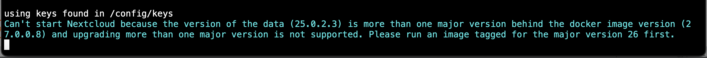

Hi, today I started up nextcloud after a week and it won’t start because the data is from NC 25 and yesterday it was automatic updated to NC 27. I use appdata backup v2.5, it’s possible that rolling back a backup of appdata can fix the problem or I need to reinstall NC? The backup was from 20/06/2023
thanks
Link to comment
thanks
https://info.linuxserver.io/issues/2023-06-25-nextcloud/
You should not need to restore from backup. You will need to change your image (as instructed in the post I'm linking) and follow the steps to get updated. Future updates shouldn't require manual action.
