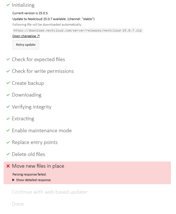

None of the steps here work for me and I think my NextCloud is even more screwed up than before I started.
Can I just delete NextCloud and re-install it?  Would I lose the settings and content?
So frustrating and annoying :(
I'm in the same boat.  I tried @Danuel @allinvain and @dodgypast steps.  I even get the error about permissions being needed, but they are correct from what I can tell.
And when I try to run the docker exec -it nextcloud updater.phar command, I get this mess:
Nextcloud Updater - version: v26.0.0beta2-9-g64e2e4c dirty
Current version is 26.0.2.
Update to Nextcloud 17.0.10 available. (channel: "beta")
Following file will be downloaded automatically: https://download.nextcloud.com/server/releases/nextcloud-17.0.10.zip
Open changelog ↗
Why is it looking for 17.0.10 and even beta now? Really just thinking about blowing it all away and restarting lol.
Thoughts?

"Should the "occ upgrade" command be executed? [Y/n] y
This version of Nextcloud is not compatible with PHP>=8.2.<br/>You are currently running 8.2.6"
If you edit the nextcloud container, what is the exact content of your Repository: line?
Mannnn, you ain't even following the issue here dude, just move on PLEASEEEEE? You are not adding any value nor helping OK.
For you humble information,  NextCloud recent update broke everything and people are trying to fix it.

I downgraded the docker and tried to run an update. Getting an error
PHP Warning:  fopen(/data/updater.log): Failed to open stream: Permission denied in phar:///config/www/nextcloud/updater/updater.phar/lib/Updater.php on line 1128
Could not open updater.log
