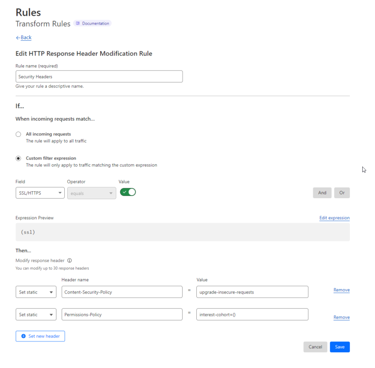

FYI, this is not related, to any NC version updates, this is just for 'server hardening' these are extra security 'headers' you can add. The scan points out where you can improve. So just add this missing two security headers for the A+
double check/add to your default.conf file
# HTTP response headers borrowed from Nextcloud `.htaccess`
    add_header Referrer-Policy                      "no-referrer"               always;
    add_header X-Content-Type-Options               "nosniff"                   always;
    add_header X-Download-Options                   "noopen"                    always;
    add_header X-Frame-Options                      "SAMEORIGIN"                always;
    add_header X-Permitted-Cross-Domain-Policies    "none"                      always;
    add_header X-Robots-Tag                         "noindex, nofollow"         always;
    add_header X-XSS-Protection                     "1; mode=block"             always;
Save.

i use Cloudflare, so you will need to add it on there also.
so Cloudflare > YOURDOMAIN > Rules > Transform Rules > Modify Response Header
Save.
restart container, then rescan.

4 hours ago, Tolete said:
Save.
Thanks, i think i have same headers but without 'always', also using cloudflare so will add headers to it.
Do you have same picture twice ?
I wanted to know if i can use default.conf.sample instead my default.conf and will have no problems....
I did. The default might break something and all you need optional security headers. I would just update, add to CF, restart and rescan, you should be golden. lmk
Save.
What problems might or cause for other sites I have hosted through this domain with Cloudflare? Will these be breaking changes to other services I host since I can't define "per subdomain"?
Adding security headers using transform rules in Cloudflare should not cause any direct problems for other sites hosted through the same domain. However, it is important to keep in mind that the security headers will be applied to all traffic to the domain, including traffic to subdomains. This means that if any subdomains have different security policies or settings, those services may be impacted by the new security headers.
I haven't seen any, but do note, the Content Security Policy (CSP) and Permissions Policy headers protect your site or in this case sites against a variety of attacks, such as cross-site scripting (XSS), code injection, clickjacking, and unauthorized access to sensitive features and APIs. CSP allows you to specify which sources of content are trusted, while Permissions Policy allows you to control which features and APIs are available to your site. By using these headers, you can improve the security of your site and reduce the risk of data breaches and other security incidents.
you can always add/monitor/test.

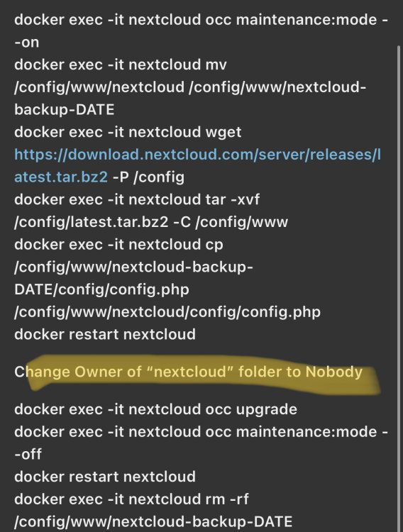

On 12/9/2022 at 10:00 AM, tazire said:
Currently trying to upgrade from 25.0.1 to 25.0.2 via CLI and got the following error
docker exec -it nextcloud occ upgrade
Nextcloud or one of the apps require upgrade - only a limited number of commands are available
You may use your browser or the occ upgrade command to do the upgrade
Cannot write into "config" directory.
This can usually be fixed by giving the web server write access to the config directory. See https://docs.nextcloud.com/server/25/go.php?to=admin-dir_permissions. Or, if you prefer to keep config.php file read only, set the option "config_is_read_only" to true in it. See https://docs.nextcloud.com/server/25/go.php?to=admin-config
Cannot write into "apps" directory.
This can usually be fixed by giving the web server write access to the apps directory or disabling the App Store in the config file.
An unhandled exception has been thrown:
Exception: Environment not properly prepared. in /config/www/nextcloud/lib/private/Console/Application.php:166
Stack trace:
#0 /config/www/nextcloud/console.php(99): OC\Console\Application->loadCommands()
#1 /config/www/nextcloud/occ(11): require_once('...')
I'm guessing I need to change permissions on the config and apps files as stated? or should I set it to read only?
Did you ever get this working? I've having a very similar issue
Look at who owns config folder and who had owned and what rights of the old one. Last few times I’ve upgraded Nextcloud I’ve had to change owner and permissions back to “what they were”. I could look at mine later and tell you if I needed. Never the les same thing. Upgraded would fail because when following manual upgrade instructions new folder permissions and owner weren’t correct.
When manually upgrading this is when I’ve had to fix owner and permissions in the process:
As blaine07 already said its an ownerr/ permissions issue. resettibg these to nobody and rw permissions solved my issue. Although I've had to do this everytime I update since first having the issue, which isnt ideal.
Yes, I have had to do this the last several updates to. Not quite sure why but it's kind of a nuisance.
