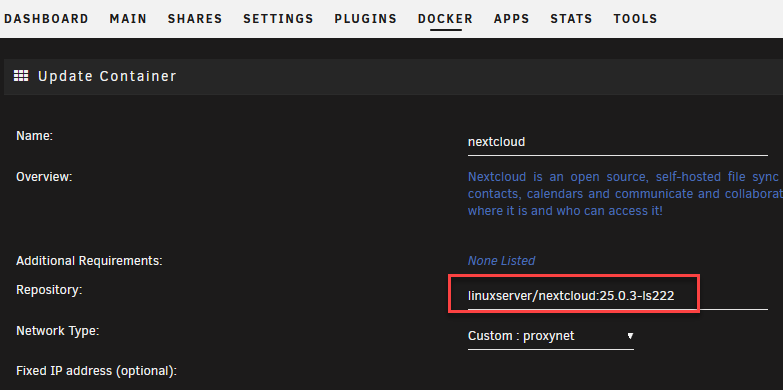

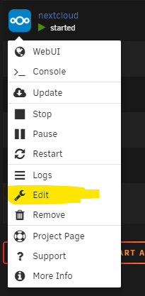

I got some valuable help from a few folks on this forum.  Here are my notes:
Upgrading Nextcloud is best done through the command line. The Docker doesn't upgrade it.
In my case, I had to first downgrade my Nextcloud docker image until I found one that worked.  To do this, edit the Nextcloud Docker container template.
Change the repository line.
I changed mine to linuxserver/nextcloud:23.0.0 after a bit of digging.
I actually did this incrementally by trying an earlier version of Nextcloud until I found one that worked.
You can find the different versions (tags) here: https://hub.docker.com/r/linuxserver/nextcloud at the bottom of the page.

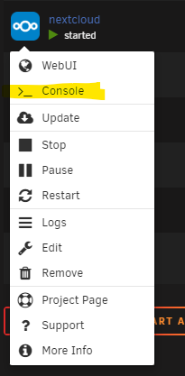

Use the following command line to upgrade:
sudo -u abc php /config/www/nextcloud/updater/updater.phar
This will run the updater and when finished it will ask if you want to run occ, answer yes.

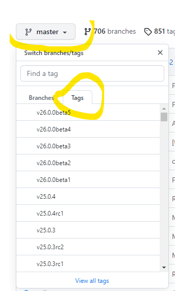

To get the correct version of version.php, in the git repo, you can select the tag that matches the version you need.
The version.php file is at the top level of the repo, so it should be copied to /config/www/nextcloud.
I had to re-run the updater multiple times, fixing my mistakes - once it ran successfully, I just kept running it until it said there were no more updated.
Then I went into the Nextcloud template again, and changed the repo line to linuxserver/nextcloud:latest.
I hope this helps get you back up and running. Please let me know if you run into anything that these instructions don't help with.  I will try help in any way I can.  I'm not the expert by any means, but I will try.

Looks like it won't be fixed until NC 26, and I'm not waiting for it to just break again. It was too much of a pain to decrypt my old files and rebuild the instance numerous times trying to get it to work.
I really agree with you. I ended up making it to work though.
Simply edit your docker and change the repository for this : linuxserver/nextcloud:25.0.3-ls222
This version will work until v26.
This being said, I also disabled encryption, it wasn,t worth it since it's not really that much secure considering the keys reside next to the encrypted data.

On 3/5/2023 at 6:34 PM, leprechaun17 said:
How did you execute the docker commands on unraid?
Sorry for the noob question.
While executing the commands from the same answer you were looking at I have time over ;-)
I see that @blaine07 already answered your question, but I think he is missing what you are asking about.
A command line window can be opened from the top right corner of the Unraid GUI  >_
