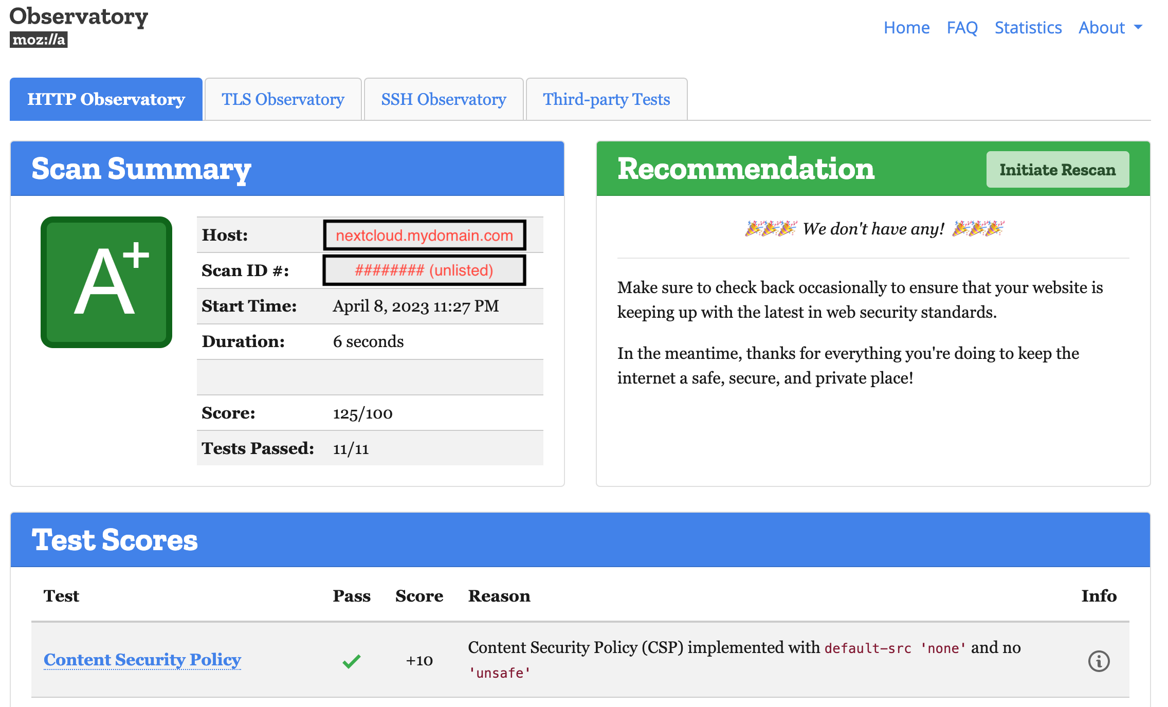

@Толете Thanks for your help with Security headers on Cloudflare . A+ is on all my domains in https://securityheaders.com/
Just wanted to ask about ' upgrade-insecure-requests ' is it safe to use only this header ?
after searched and tryed some header found very difficult to get right headers and not block some stuff in nextcloud and other domains ,also found tool CSP Generator for chrome but still trying :(...
Also not really found what the  (interest-cohort=()) mean ?

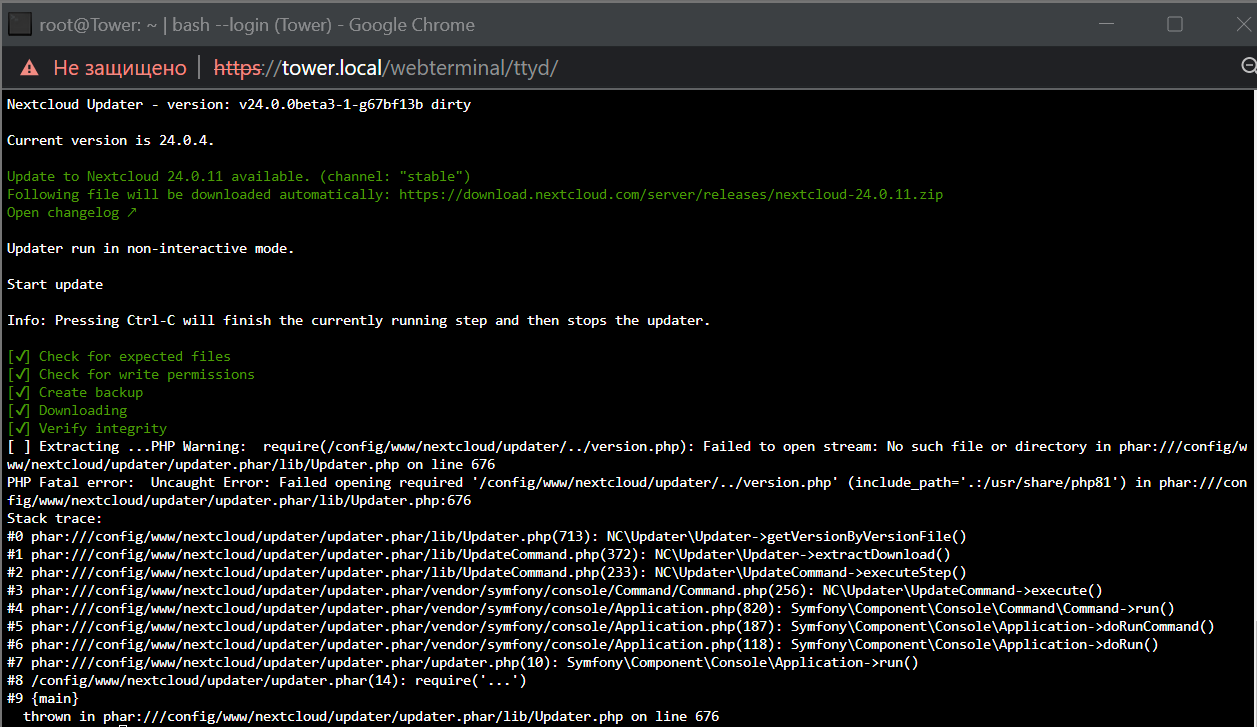

Hi All,
Can anyone please help with updating the nextcloud version
Tried everything, UI, CLI, deteling the updater-xxxxx folder, etc.
Nothing helped, nextcloud UI returns: "Update in process"
Updater returns: "Step 6 is currently in process. Please reload this page later."
Error:
[ ] Extracting ...PHP Warning:  require(/config/www/nextcloud/updater/../version.php): Failed to open stream: No such file or directory in phar:///config/www/nextcloud/updater/updater.phar/lib/Updater.php on line 676
PHP Fatal error:  Uncaught Error: Failed opening required '/config/www/nextcloud/updater/../version.php' (include_path='.:/usr/share/php81') in phar:///config/www/nextcloud/updater/updater.phar/lib/Updater.php:676
Stack trace:
#0 phar:///config/www/nextcloud/updater/updater.phar/lib/Updater.php(713): NC\Updater\Updater->getVersionByVersionFile()
#1 phar:///config/www/nextcloud/updater/updater.phar/lib/UpdateCommand.php(372): NC\Updater\Updater->extractDownload()
#2 phar:///config/www/nextcloud/updater/updater.phar/lib/UpdateCommand.php(233): NC\Updater\UpdateCommand->executeStep()
#3 phar:///config/www/nextcloud/updater/updater.phar/vendor/symfony/console/Command/Command.php(256): NC\Updater\UpdateCommand->execute()
#4 phar:///config/www/nextcloud/updater/updater.phar/vendor/symfony/console/Application.php(820): Symfony\Component\Console\Command\Command->run()
#5 phar:///config/www/nextcloud/updater/updater.phar/vendor/symfony/console/Application.php(187): Symfony\Component\Console\Application->doRunCommand()
#6 phar:///config/www/nextcloud/updater/updater.phar/vendor/symfony/console/Application.php(118): Symfony\Component\Console\Application->doRun()
#7 phar:///config/www/nextcloud/updater/updater.phar/updater.php(10): Symfony\Component\Console\Application->run()
#8 /config/www/nextcloud/updater/updater.phar(14): require('...')
#9 {main}
  thrown in phar:///config/www/nextcloud/updater/updater.phar/lib/Updater.php on line 676
The 'upgrade-insecure-requests' header instructs the browser to automatically upgrade HTTP requests to HTTPS. This is a useful security measure to protect against man-in-the-middle (MITM) attacks and mixed content vulnerabilities. However, using this header alone is not enough to provide full Content Security Policy protection for your website.
Content Security Policy (CSP) is a security standard designed to mitigate the risk of cross-site scripting (XSS), clickjacking, and other code injection attacks. It is recommended to use a properly configured CSP in addition to the 'upgrade-insecure-requests' header to provide a more comprehensive security posture for your website.
Regarding the 'interest-cohort=()' directive, it is a new feature introduced by Google to combat online tracking by preventing websites from accessing a user's unique identifier or "cohort" information. The cohort information is used by Google to group similar users together for interest-based advertising. By adding 'interest-cohort=()' to your CSP, you are telling the browser to disallow the use of this feature, which could help protect user privacy. However, this directive is not yet widely supported by all browsers, and its impact on website functionality is still being studied.
On 4/7/2023 at 1:06 PM, Masterwishx said:
In .htaccess file:
# Content Security Policy (CSP)
Header always set Content-Security-Policy "default-src 'none'; frame-ancestors 'none'; connect-src 'self'; font-src 'self'; img-src 'self'; manifest-src 'self'; script-src 'self'; style-src 'self';"
In default.conf file:
add_header Content-Security-Policy "default-src 'none'; frame-ancestors 'none'; connect-src 'self'; font-src 'self'; img-src 'self'; manifest-src 'self'; script-src 'self'; style-src 'self';" always;
in cloudflare, modify the values for 'Content-Security-Policy' with:
It is possible that this can break some of your subdomains ,those subdomain websites are using external resources (such as scripts, stylesheets, or images) that are not hosted on your domain. In this case, you may need to add additional directives to your CSP to allow those external resources.
To debug this issue, you can use the browser console to see which resources are being blocked by the CSP, and adjust the CSP directives accordingly. You can also use a CSP reporting tool (such as the one provided by Google) to get more detailed reports on CSP violations.
In general, it is important to be careful when implementing CSP, as it can have unintended consequences if not done properly. It is recommended to start with a more permissive policy (such as "default-src 'self'") and gradually tighten it as needed, while monitoring for any issues.
i would recommend just going with "upgrade-insecure-requests" to keep it from breaking other sites/apps you maybe running.

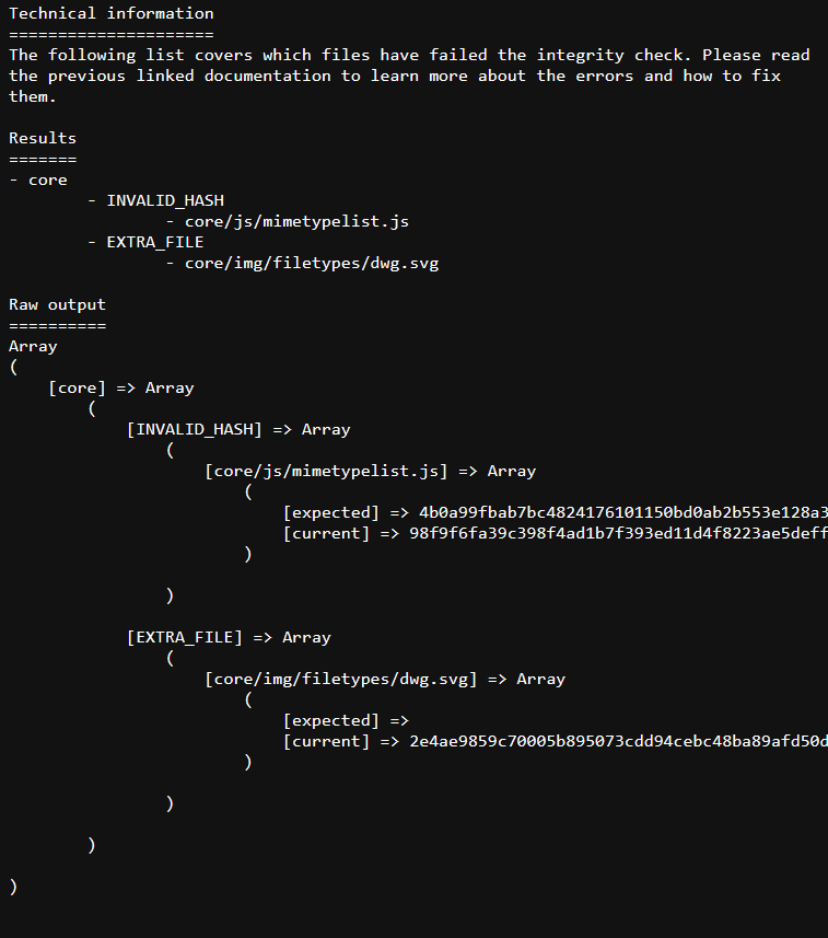

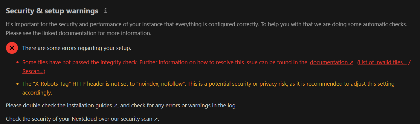

On 3/21/2023 at 12:30 PM, Tolete said:
 after upgrading to NC 26.0.0
Administration settings > Overview
error-
The "X-Robots-Tag" HTTP header is not set to "noindex, nofollow". This is a potential security or privacy risk, as it is recommended to adjust this setting accordingly.
The Fix:
update [line 54] on your default.conf file
appdata > nextcloud > nginx > site-confs > default.conf
from
add_header X-Robots-Tag "none" always;
to
add_header X-Robots-Tag "noindex, nofollow" always;
Restart container.
Still getting this warning even though i updated default.conf and .htacces and restarting container on 25.0.5
Here's default.conf
  # The settings allows you to optimize the HTTP2 bandwitdth.
    # See https://blog.cloudflare.com/delivering-http-2-upload-speed-improvements/
    # for tunning hints
    client_body_buffer_size 512k;
    # HTTP response headers borrowed from Nextcloud `.htaccess`
    add_header Referrer-Policy                      "no-referrer"   always;
    add_header X-Content-Type-Options               "nosniff"       always;
    add_header X-Download-Options                   "noopen"        always;
    add_header X-Frame-Options                      "SAMEORIGIN"    always;
    add_header X-Permitted-Cross-Domain-Policies    "none"          always;
    add_header X-XSS-Protection                     "1; mode=block" always;
    # Remove X-Powered-By, which is an information leak
    fastcgi_hide_header X-Powered-By;
here's .htaccess
  <IfModule mod_env.c>
    # Add security and privacy related headers
    # Avoid doubled headers by unsetting headers in "onsuccess" table,
    # then add headers to "always" table: https://github.com/nextcloud/server/pull/19002
    Header onsuccess unset Referrer-Policy
    Header always set Referrer-Policy "no-referrer"
    Header onsuccess unset X-Content-Type-Options
    Header always set X-Content-Type-Options "nosniff"
    Header onsuccess unset X-Frame-Options
    Header always set X-Frame-Options "SAMEORIGIN"
    Header onsuccess unset X-Permitted-Cross-Domain-Policies
    Header always set X-Permitted-Cross-Domain-Policies "none"
    Header onsuccess unset X-Robots-Tag
    Header always set X-Robots-Tag "noindex, nofollow"
    Header onsuccess unset X-XSS-Protection
    Header always set X-XSS-Protection "1; mode=block"
    SetEnv modHeadersAvailable true
  </IfModule>
Edited by ffhelllskjdje

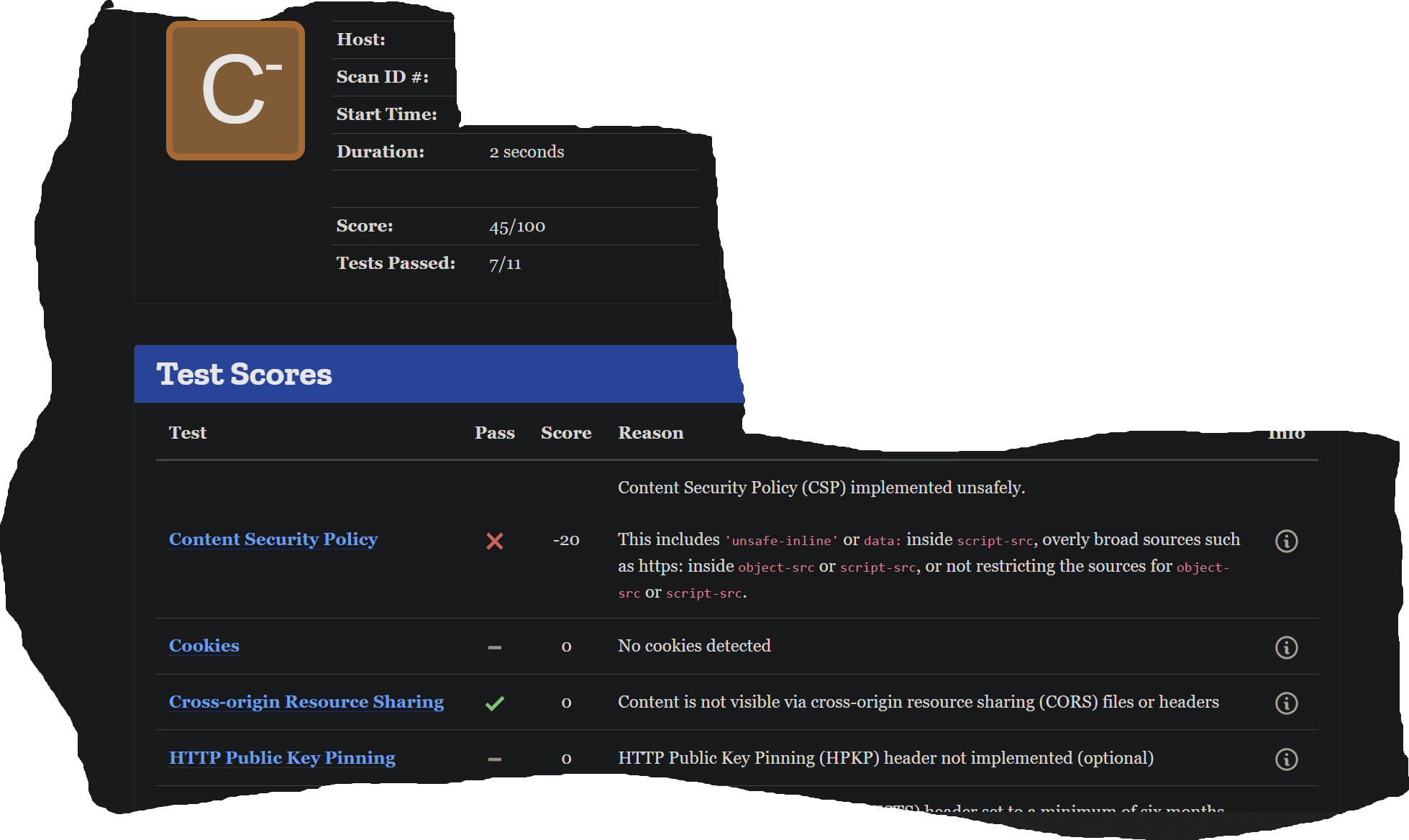

Thanks for explaining, I used chrome extension to generate CSP for nextcloud with 'self' and all other parameters but only in cloudflare not in nextcloud nginx. So breaked some stuff. Of course used console for check it. Also using Matomo + Cloudflare app matomo for Analytics so it's a little harder for setup becose external js. So leaved "upgrade-insecure-requests" for now but will check you example and will check it again.

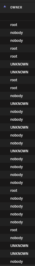

Hello,
I have problems with updating nextcloud. Im trying to manual upgrade using occ.
I get this message and i don't know how to change the permissions. I was trying to figure it out from some of the posts above but I don't understand how i should change it.
My Repository is linuxserver/nextcloud
Im getting this error:
docker exec -it nextcloud occ upgrade
Nextcloud or one of the apps require upgrade - only a limited number of commands are available
You may use your browser or the occ upgrade command to do the upgrade
Cannot write into "config" directory.
This can usually be fixed by giving the web server write access to the config directory. See https://docs.nextcloud.com/server/26/go.php?to=admin-dir_permissions. Or, if you prefer to keep config.php file read only, set the option "config_is_read_only" to true in it. See https://docs.nextcloud.com/server/26/go.php?to=admin-config
Cannot write into "apps" directory.
This can usually be fixed by giving the web server write access to the apps directory or disabling the App Store in the config file.
An unhandled exception has been thrown:
Exception: Environment not properly prepared. in /config/www/nextcloud/lib/private/Console/Application.php:167
Stack trace:
#0 /config/www/nextcloud/console.php(99): OC\Console\Application->loadCommands()
#1 /config/www/nextcloud/occ(11): require_once('...')
@gevsan
It is probably an issue with file owner. In you nextcloud appdata folder you can check it by doing:
ls -la
it should say "nobody users" as owner. If it dosnt, you can run:
chown nobody:users -R *
then re-run the update command
3 hours ago, squarebob said:
@gevsan
ls -la
I will try this.

10 hours ago, squarebob said:
You could use the terminal in web gui (from the row on the top right in gui), then
cd /mnt/user/appdata/nextcloud/
Thanks!
I tried
ls -la
and I had no owner.
So i typed
 and it still doesn't give me owner.
Below is the output after I typed "chown nobody:users -R *"
root@Tower:/mnt/user/appdata/nextcloud# ls -la
total 145856
drwxrwxrwx 1 nobody users       192 Apr 12 09:34 ./
drwxrwxrwx 1  65534 users       606 Mar 29 10:56 ../
drwxrwxrwx 1 nobody users        20 Jan 24  2022 .cache/
-rw-r--r-- 1 nobody users        28 Oct 19 17:01 .migrations
-rw------- 1 nobody users      1024 Apr 10 19:39 .rnd
drwxrwxrwx 1 nobody users         8 Apr 13 07:54 crontabs/
drwxr-xr-x 1 nobody users         0 Feb 27 12:51 custom-cont-init.d/
drwxr-xr-x 1 nobody users         0 Feb 27 12:51 custom-services.d/
drwxrwxrwx 1 nobody users        32 Jan 24  2022 keys/
-rw-r--r-- 1 nobody users 149346219 Apr 12 09:34 latest.tar.bz2
drwxrwxrwx 1 nobody users        48 Apr 13 02:00 log/
drwxrwxrwx 1 nobody users       212 Apr 13 07:54 nginx/
drwxrwxrwx 1 nobody users        44 Jan 24  2022 php/
drwxrwxrwx 1 nobody users        70 Apr 13 07:52 www/
Your output looks correct now. Did you try and run the update again?
Yes I did.
I get this message:
root@Tower:~# docker exec -it nextcloud occ upgrade
Stack trace:
#2 {main}root@Tower:~#
I get the same message when im trying to
docker exec -it nextcloud occ maintenance:mode --off
I don't know what to do :/
After i typed
Some of my folders changed owner to "UNKNOWN"
I also lost my VMs somehow...
5 hours ago, gevsan said:
After i typed
I think you have to use
chown -R nobody:users *
instead.
chown help says:
chown [OPTIONS] USER[:GROUP] FILE(s)
Recently just updated my Nextcloud docker to 26.0.0 Can anyone guide me on how to solve the security red warning here? I have solved the orange warning only. image.thumb.png.813d9159d6bcb58faadfd2fff01413cd.pngimage.thumb.png.7d55535f3578a52d1632544338294857.png
Edited by Wong
Solved orange warning
Since Nextcloud 26, the default nginx config has changed.
Open the NextCloud docker terminal and edit the file /config/nginx/site-confs/default.conf
Change the line
add_header X-Robots-Tag “none” always;
to
add_header X-Robots-Tag “noindex, nofollow” always;
Restart and you should be good. You check your Nextcloud headers before and after at: https://headers.4tools.net/
@Tolete
After changed to container defaults /config/nginx/site-confs/default.conf.sample and nginx.conf.sample and updated Nextcloud to 26.0.1
i see no refferrer policy :
but it still present in file default.conf.:
and .htaccess :
Maybe you know where the problem ?
