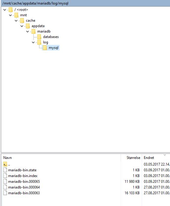

1 hour ago, CHBMB said:
Logs from Mariadb/MySQL?
I do not find any logs here.
Only this
The logs from the docker container.... like this

I do not get that. It just shows the same thing over and over again:
