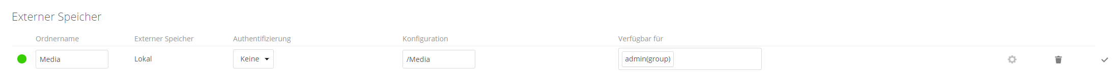

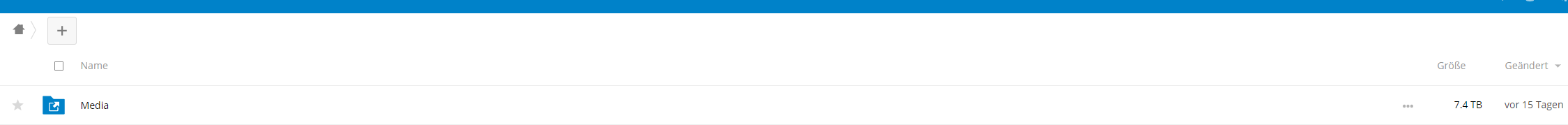

both works, either you mount the pathes in nextcloud docker and then they are available to add as local pathes in nextcloud,
or you simply just add your network shares in there ... pretty self explained.
all in the external storage plugin, local, SMB, google drive, etc ...
for example, i mounted media to nextcloud docker
then i added this in external storage, here u also specify access and priviledges.
then in nextcloud its shown as share
pretty simple and working ;)

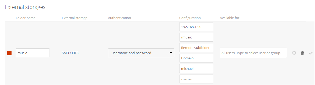

Im getting a red square and not sure why. Can you see what's wrong with the config? I added a path variable called /music to the docker.
Nextcloud is running on its own IP 192.168.1.91:443
UNRAID host is running on 192.168.1.90
Edited by mikeyosm
avoid empty fields, use dot for Domain, and choose some subfolder too..

17 minutes ago, mikeyosm said:
Not made a difference. Doesn't "." imply localhost? My UNRAID is running on a different IP.
Can you show me your external storage config please?
ahh, just looked at my config, i have no value for Domain field. Remove slash for share name, use just "music" ..
and for SMB/CIFS you don't need local folder mapping, just a proper samba share from your unRAID.
Edited by uldise

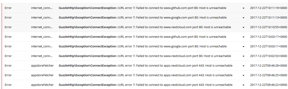

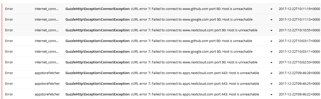

UNRAID 6.4 RC17 has broken the docker for me. I run nextcloud on its own IP and now it doesnt have any internet connectivity so I cant access nextcloud from outside my network or even load the nextcloud apps page. Loads of connection problems in the log...
This was all working fine with 6.4 RC15e.
Anything I can do within nextcloud to troubleshoot the internet connection? All other dockers that share the UNRAID host IP appear to work fine.
Hmm just checked and I think my installation is broken on 17b - just upgraded today.  Will check properly when get home.  My address is nextcloud.domain.com - my other dockers e.g domain.com/sonarr are working
Update: False alarm - restarting the docker did the trick
