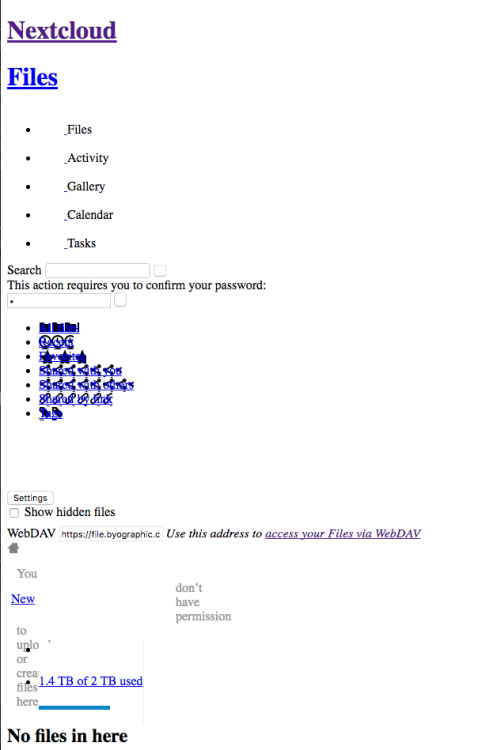

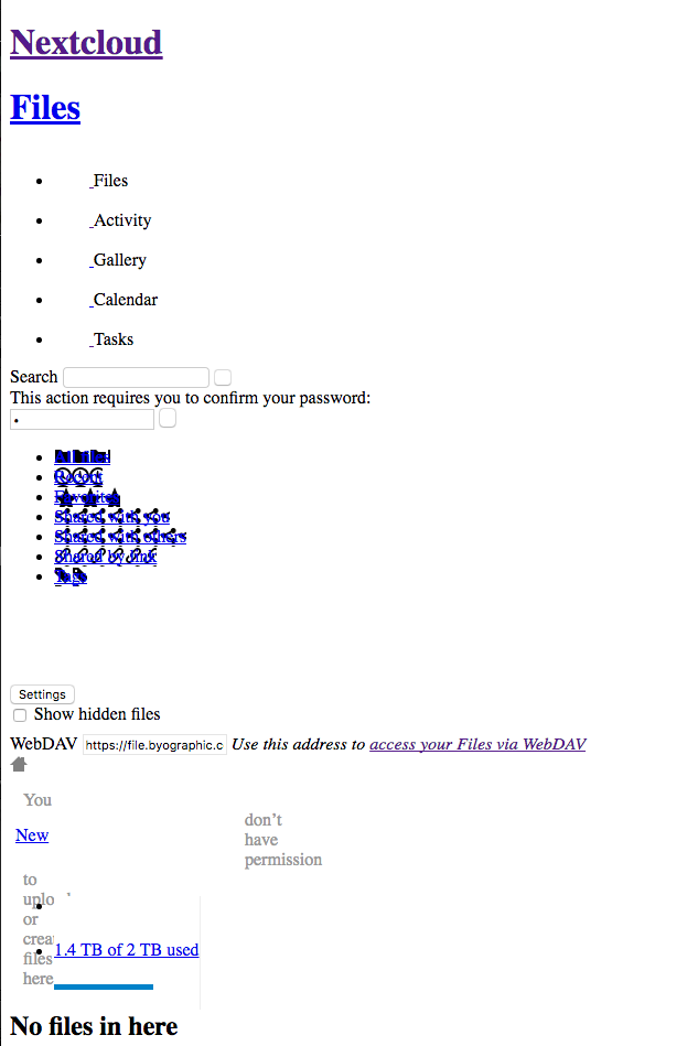

i've followed the procedure at the link, the only thing that doesn't work is the web interface, as if there were no css style in the webapp
59c68a5622480_ScreenShot2017-09-23at18_22_08.thumb.png.05f968db44b805cb1eab02730d35f26b.png
Share this post
Link to post
Probably some config change in the proxy.  Take a look at my setup guide and make sure the setup files match.

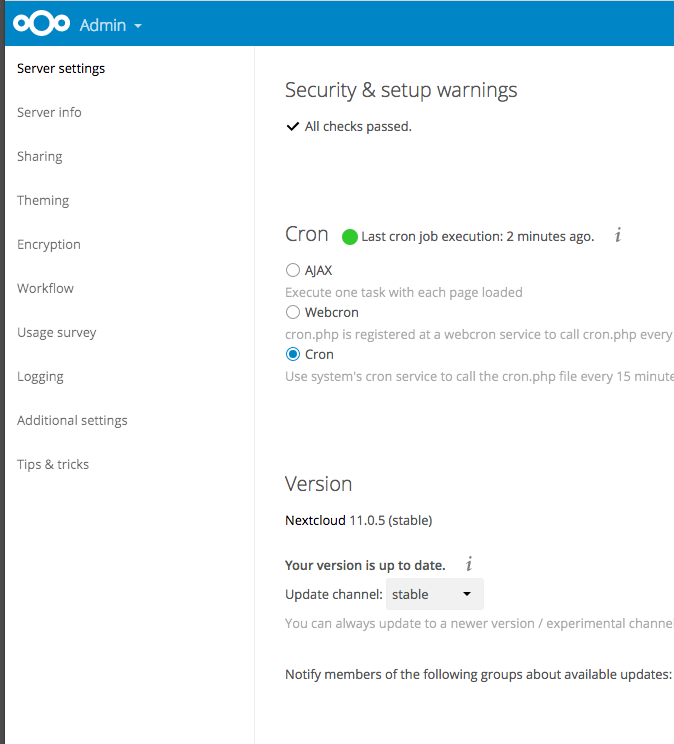

Hello,
I recently went in to my admin page and saw that there was a stable update available. I am always a bit weary of these as in the past have had issues after upgrades. This time when following the prompt, I see that the version which is listed is different from the suggested. Please see attached pages. It should be 11.0.5 but shows up as 12.0.3. If I go into "production" then I see 11.0.5.
Am I missing something? Before proceeding, can someone please shine some light on this?
Thanks,
Lev
