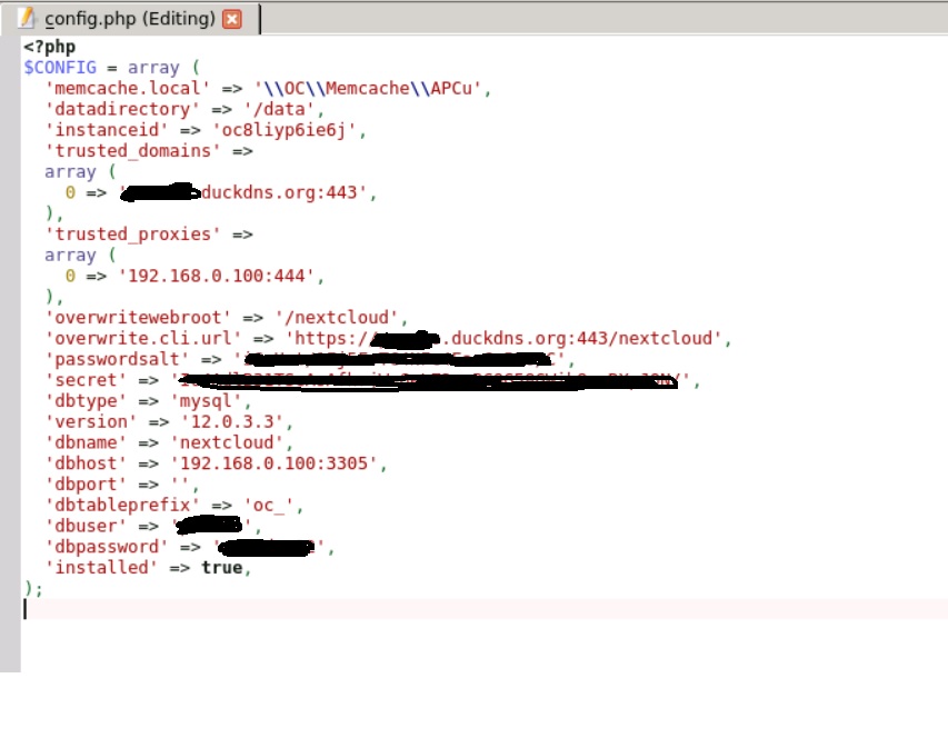

Hi, I just installed this using the LSIO tutorial (up to the letsencrypt reverse proxy) since I had already set it up using cyanlab's tutorial (https://cyanlabs.net/tutorials/the-complete-unraid-reverse-proxy-duck-dns-dynamic-dns-and-letsencrypt-guide/#comment-171).
I'm able to access xxxxx.duckdns.org/nextcloud. However, when I go to my array and add/remove a picture (and i'm sure any other file), it does not reflect that when I access it online. Do I need to do something else? I attached the config file below in case that helps. Thanks!

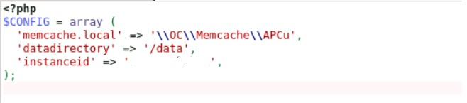

Re-installed nextcloud and trying to follow the guide:
https://www.linuxserver.io/2017/05/10/installing-nextcloud-on-unraid-with-letsencrypt-reverse-proxy/
seems to have got to the point near the end to edit the config.php file. However, when I open it, I only have a few lines:
This looks to be wrong, but where is it going wrong?
Also, I'm looking to make it xxx.duckdns.org/nextcloud instead of nextcloud.server.com as per the guide. Do I just change the instances of nextcloud.server.com w/ the former duckdns one? Thanks!
