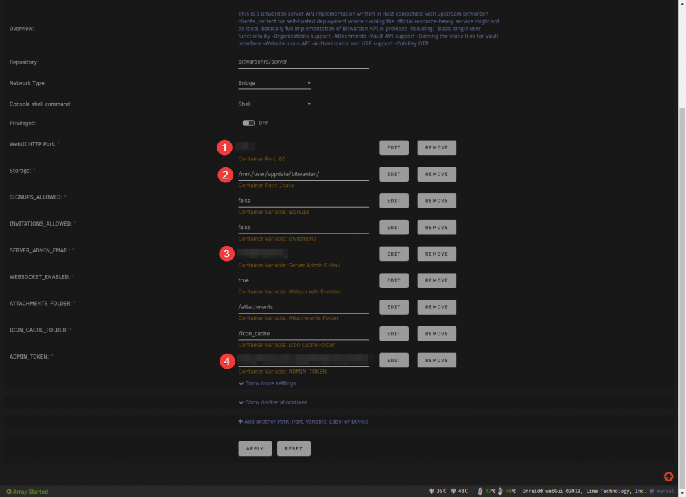

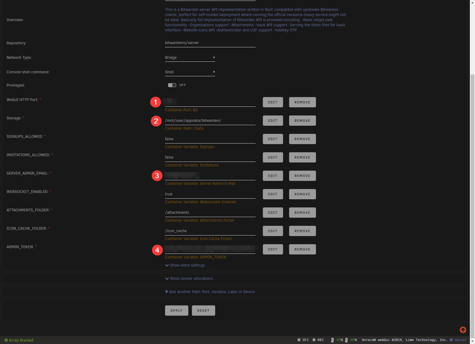

Not 100% sure if this is the best way to do it or not, but here is what I did to migrate to the bitwardenrs docker
!!!!! Stop your existing bitwarden docker and then make a backup of your existing bitwarden appdata folder !!!!!
I did this using the unraid web terminal as follows:
  • cd /mnt/user/appdata/
  • tar -cvzf bw.tgz /mnt/user/appdata/bitwarden
Copy that tgz file to at least 3 places. You should see it in the root of your appdata share.
Now that you've backed up your precious bitwarden data, let's do the migration.
Go to CA and open the template to install the bitwardenrs docker
  1. set the webui port to the same port you had previously used for bitwarden.
  2. make sure the appdata folder matches your old appdata folder
  3. set your server admin email address
  4. lastly, set your admin token with a long random string. I used 'openssl rand -base64 48' to make the string.
You should be able to hit Apply now and it should create the new docker for you.
Hope this helps.

Hello,
Thanks for the answer.
It worked perfectly.
My only doubt though, is why on earth is the ADMIN_TOKEN mandatory?
I don't want the ADMIN CONSOLE to be available all the time - only when needed, like with the "old" version...
Since the ADMIN CONSOLE doesn't support 2FA; it would be better to be able to disable it when it's not needed.
Edited by TDA

Regarding the admin thing. That's a question for the new bitwarden_rs maintainers. I no longer maintain the template, hence the depreciation notice. Follow the support link in the new template
