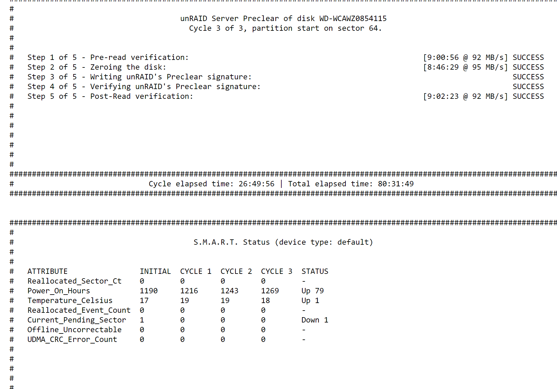

So i  ran the unclear plugin with the Joe. L - 1.20 script and i did not do the pre read only the zeroing and the post read. When completed and i tried to assign the disk to the array unraid is clearing the disk. This never happened when i used the other preclear plugin script, although on those occassions i did do the preread, zeroing and the post read. Does anyone know why unriad is clearing the disk on assignment when its not happened to the other disks i use preclear plugin with before.
what does current sector pending mean?  it happened in the 1st round of preclear but 0    does it say anything in the diagnostic logs.. is it a bad old drive?
backupserver-diagnostics-20211216-0920.zip
A pending sector is one whose contents could not be read reliably.  Can be corrected when the sector is next written, and if not the sector might then be reallocated instead.
oh ok so then it fixed itself above.. as i didnt see no smart errors either..
learn something new everyday
thanks

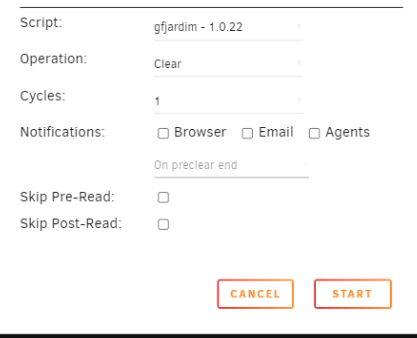

Are the options below the correct ones to use when I get a new drive and want to verify its integrity?
yes

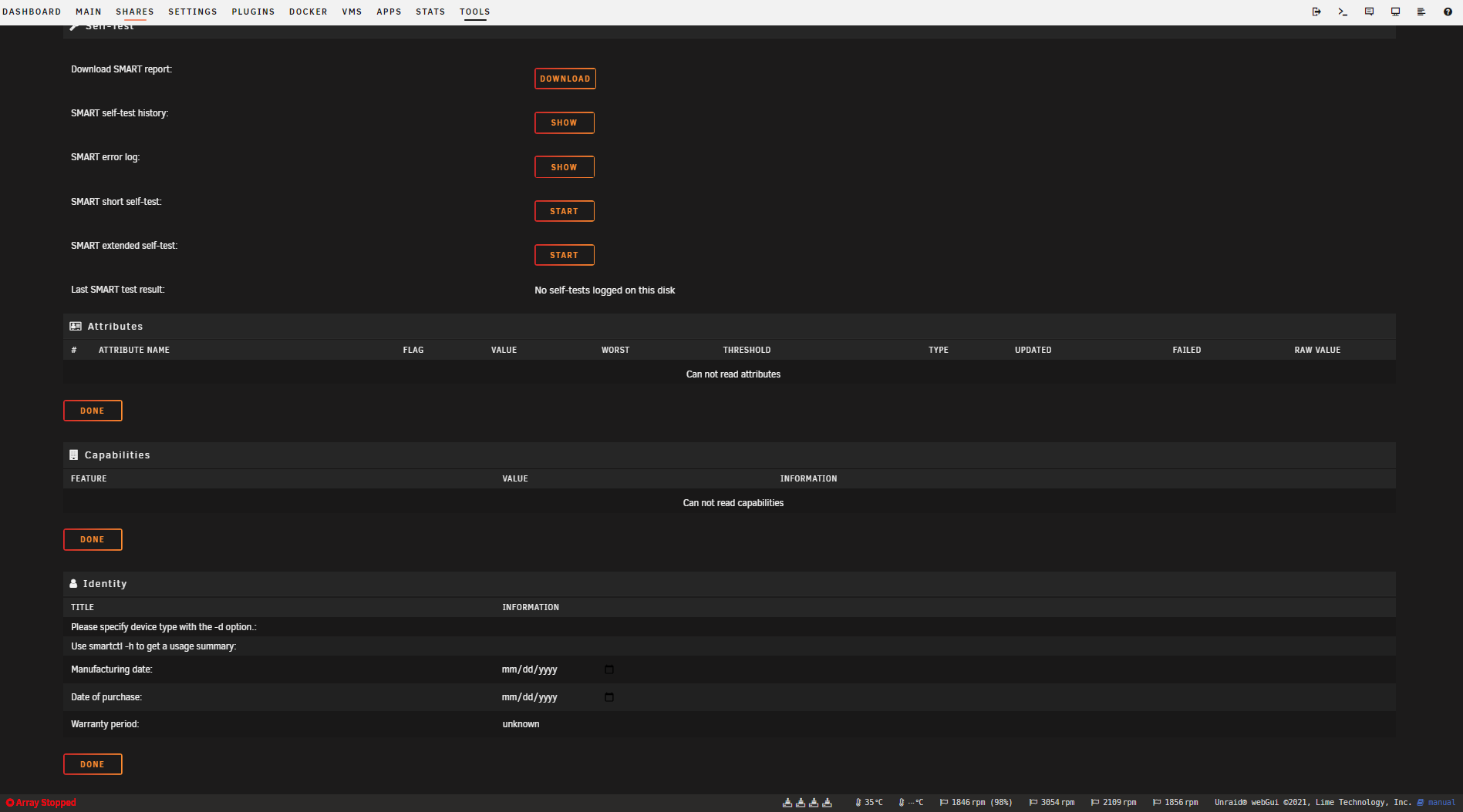

1 hour ago, Giga12 said:
I just want to confirm that below means the drive is bad, and my only option is to replace it.
No. A SMART report and possibly diagnostics covering that time may be more informative.
Does below help?

Yeah I am not getting that at all. I don't think I have ever gotten it work. The short test doesn't work either.
You may have to disable spindown on the disk to get the test to complete.
 Below is what I am seeing on the current drive. I do not have it as an active disk in my array and my array is stopped.
Edited by Giga12
You want to click the START button next to SMART extended self test
It changes to "Stop", then instantly changes back to "Start" as if it not running. There is no progress or anything.

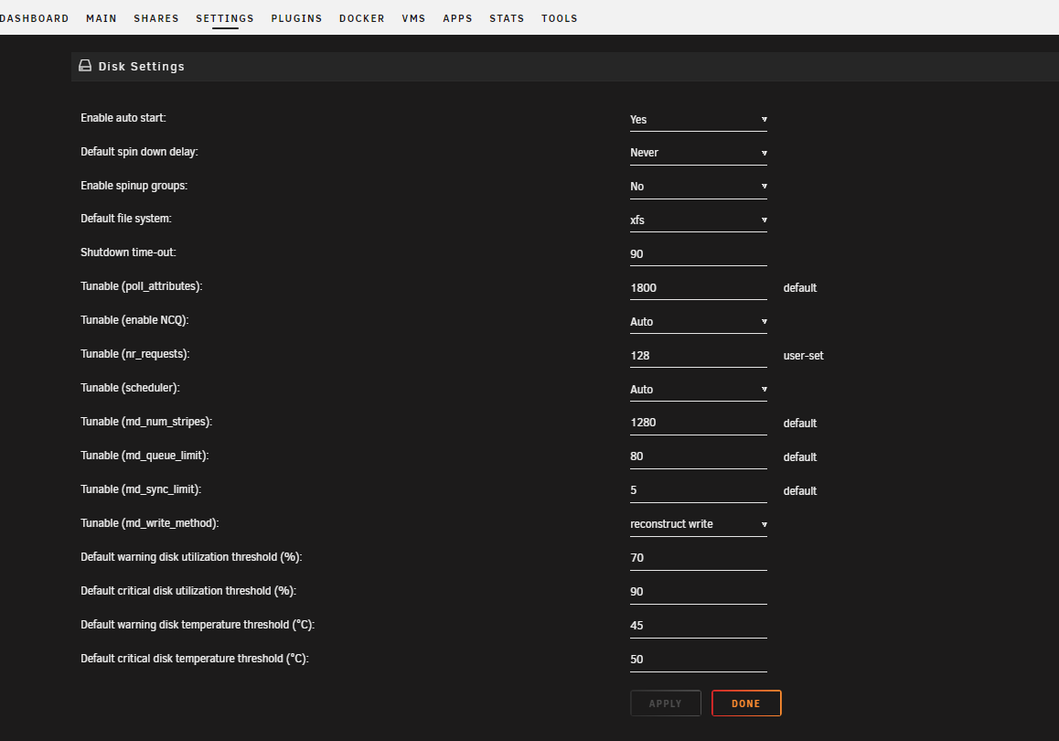

Below are my disk settings. I don't see where spin down is enabled.
Edited by Giga12
