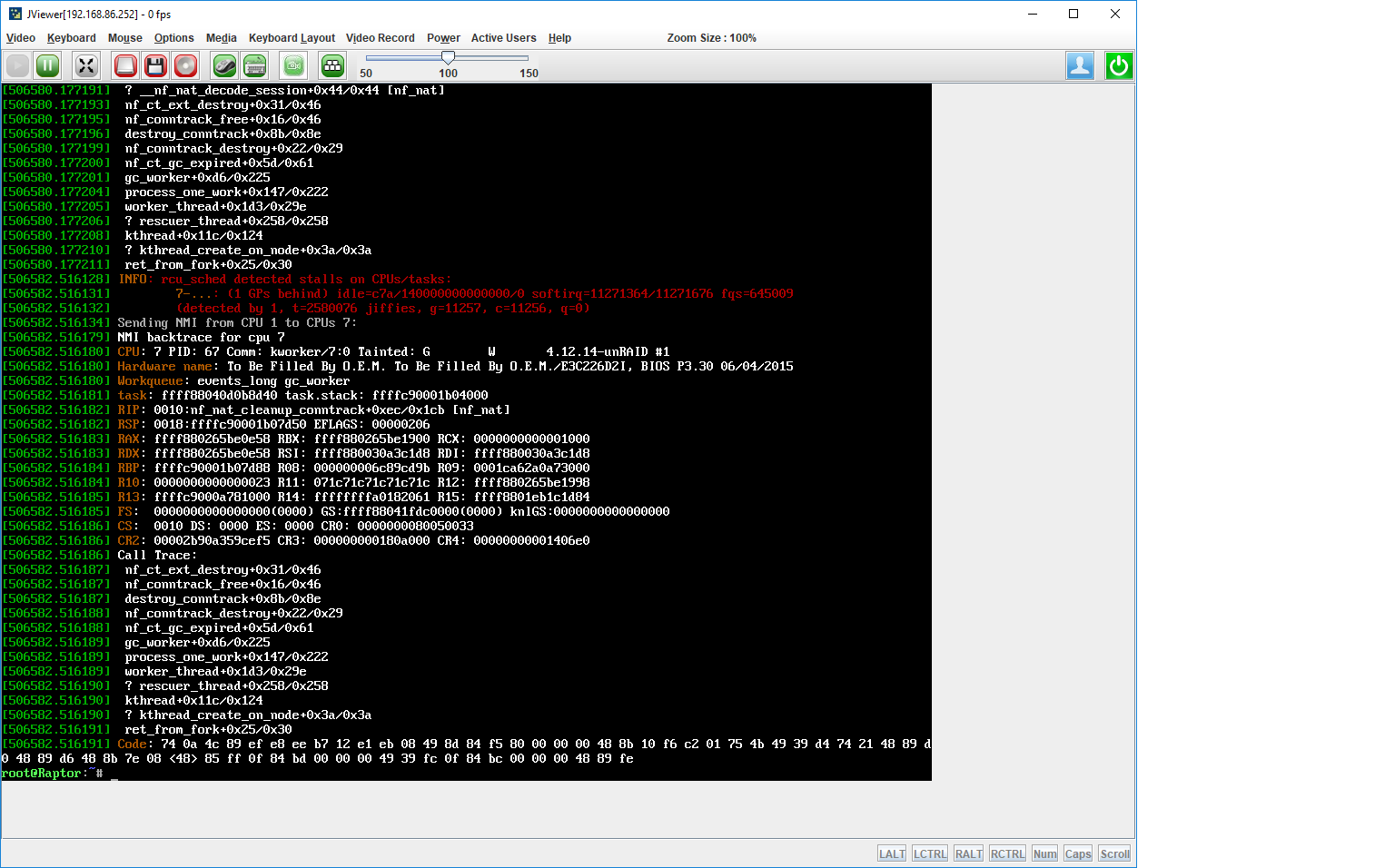

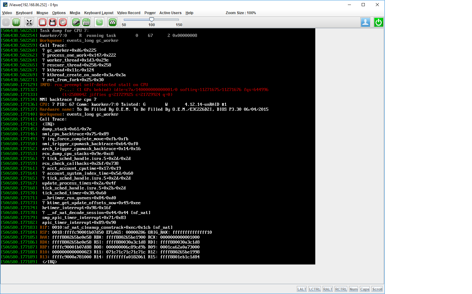

twice with this latest build my machine hasn't been able to boot and ends up in a UEFI shell.
The USB drive has needed repaired on my windows box both times.
Not really sure where to begin  - usb drive going bad?  bad luck?
system lockup again :S
2 images attached, I was able to access the system with keyboard/mouse (via IPMI) and cat the syslog. I was unable to do much else!
lsblks
ran fine and all of my disks were detected. I could also
ls /boot/
and see everything in there.
However, as soon as I tried to run
diagnostics
it just sits there for minutes doing nothing! So far I've given it about 8 mins to run but it's sat there doing nothing...
So before I reboot (I would like access to my system again!!) is there anything useful I can run? I've followed what JonP said over in his important diagnostic thread. And I've attached screenshots of my syslog output.
Cheers, hopefully we can get this resolved :D

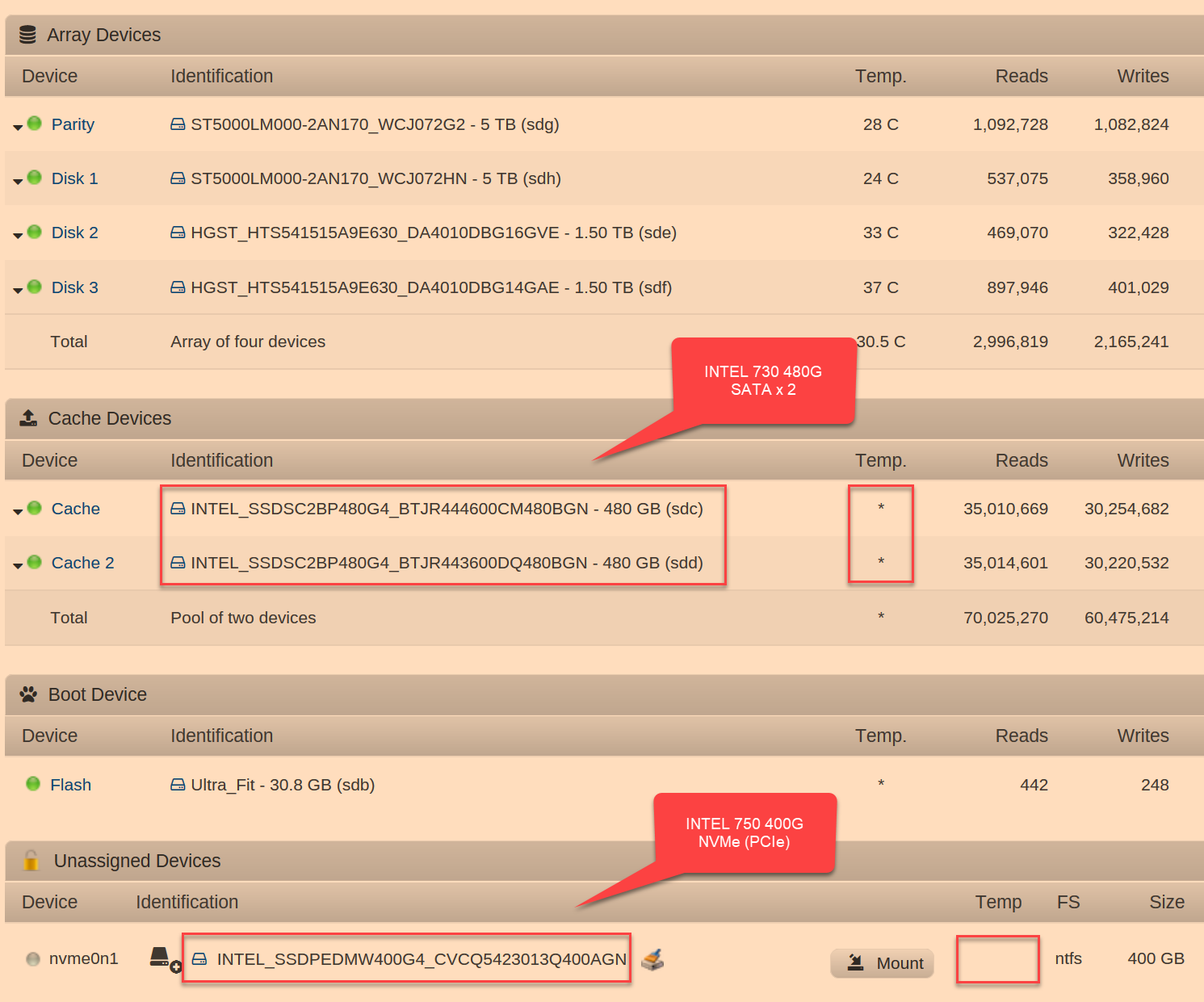

"Finally fixed reporting of temperature for NVMe devices (hopefully). "
This is not for my three SSDs, two for INTEL 730 SATA, one for INTEL 750 NVMe as well.
Any one else using INTEL SSD having similar issue or not?
Best Regards,
Alex
Does it display temperatures after you do "Spin Up" all disks?
It doesn't matter. I am doing parity check now. Same as above.
Parity check will not spin up your cache drives and unassigned devices drives.
Edited by saarg
I don't know about those specific models but all Intel SSDs I've used in the past didn't show temp on SMART, you can check with:
smartctl -A /dev/sdX
For the NVMe device try:
smartctl -A /dev/nvme0n1
or
or
smartctl shows the temperature actually.
root@UNRAID:~# smartctl -A /dev/sdb
smartctl 6.5 2016-05-07 r4318 [x86_64-linux-4.12.14-unRAID] (local build)
Copyright (C) 2002-16, Bruce Allen, Christian Franke, www.smartmontools.org
=== START OF READ SMART DATA SECTION ===
SMART Attributes Data Structure revision number: 1
Vendor Specific SMART Attributes with Thresholds:
ID# ATTRIBUTE_NAME          FLAG     VALUE WORST THRESH TYPE      UPDATED  WHEN_FAILED RAW_VALUE
190 Temperature_Case        0x0022   069   059   000    Old_age   Always       -       31 (Min/Max 30/35)
root@UNRAID:~# smartctl -A /dev/nvme0
=== START OF SMART DATA SECTION ===
SMART/Health Information (NVMe Log 0x02, NSID 0xffffffff)
Temperature:                        31 Celsius
It's there but it's using a different attribute, I believe temp is usually taken from attribute 194 - Temperature celsius
Does it also work with /dev/nvme0n1 ? If not it's possibly the same problem as my OCZ RD400, I believe LT is trying to make it work.
Does it also work with /dev/nvme0n1 ? If not it's possible the same problem as my OCZ RD400, I believe LT is trying to make it work.
ok. then it's intel ssd's problem with smart. yes. I checked my HDDs, they are using id 194 for temperature.
no. it doesn't work with /dev/nvme0n1, even though in my "main" page, unRAID read the device as /dev/nvme0n1.
Both attribute IDs 190 or 194 may be used to indicate temperature, I am not sure whether emhttp checks for attribute ID or attribute name to extract the temperature value.
That is a question for LT.
