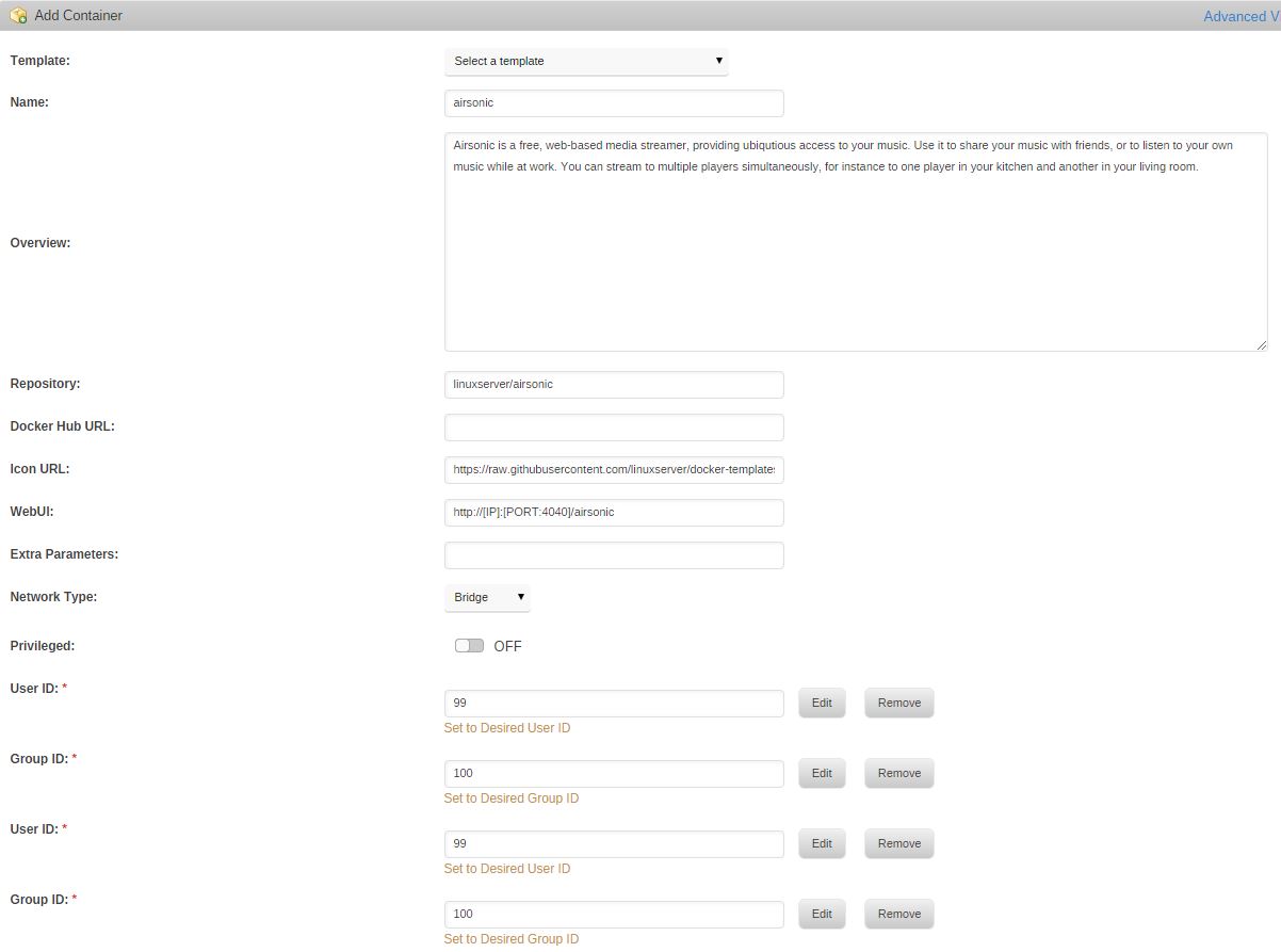

Thanks for this. Just tried to install and couldn't see an option to set port or config location. There is instead a repeat of the option to set permissions. See attached.
Thanks.
There's an issue with the template. Something is not correct and half of the template are not showing.
Should be fixed in a couple of hours when the app feed is updated.
Edited by saarg
Should this be fixed by now? (or do i need to do something separate to refresh?)
It was supposed to be fixed, but someone made a mess of the template 9_9 Not sure when the templates get refreshed in CA.
It's fixed.
Edited by saarg
hmmm it still seems to only show user and group ID for me. I can see that the XML file has been updated, but for some reason it wont update the screen. i tried rebooting, and reinstalling the plugin and got the same result..
its working now. Must have taken a bit longer for it to update
